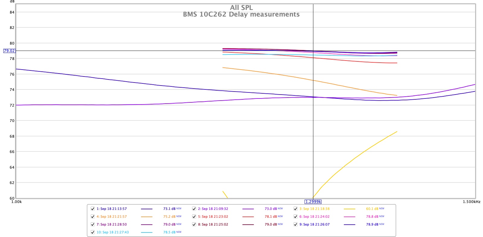

I did some new measurements. All measurements were taken from close distance, 10cm from the outer edge of cone driver, on axis, 4ms windowed, no eq/filter.

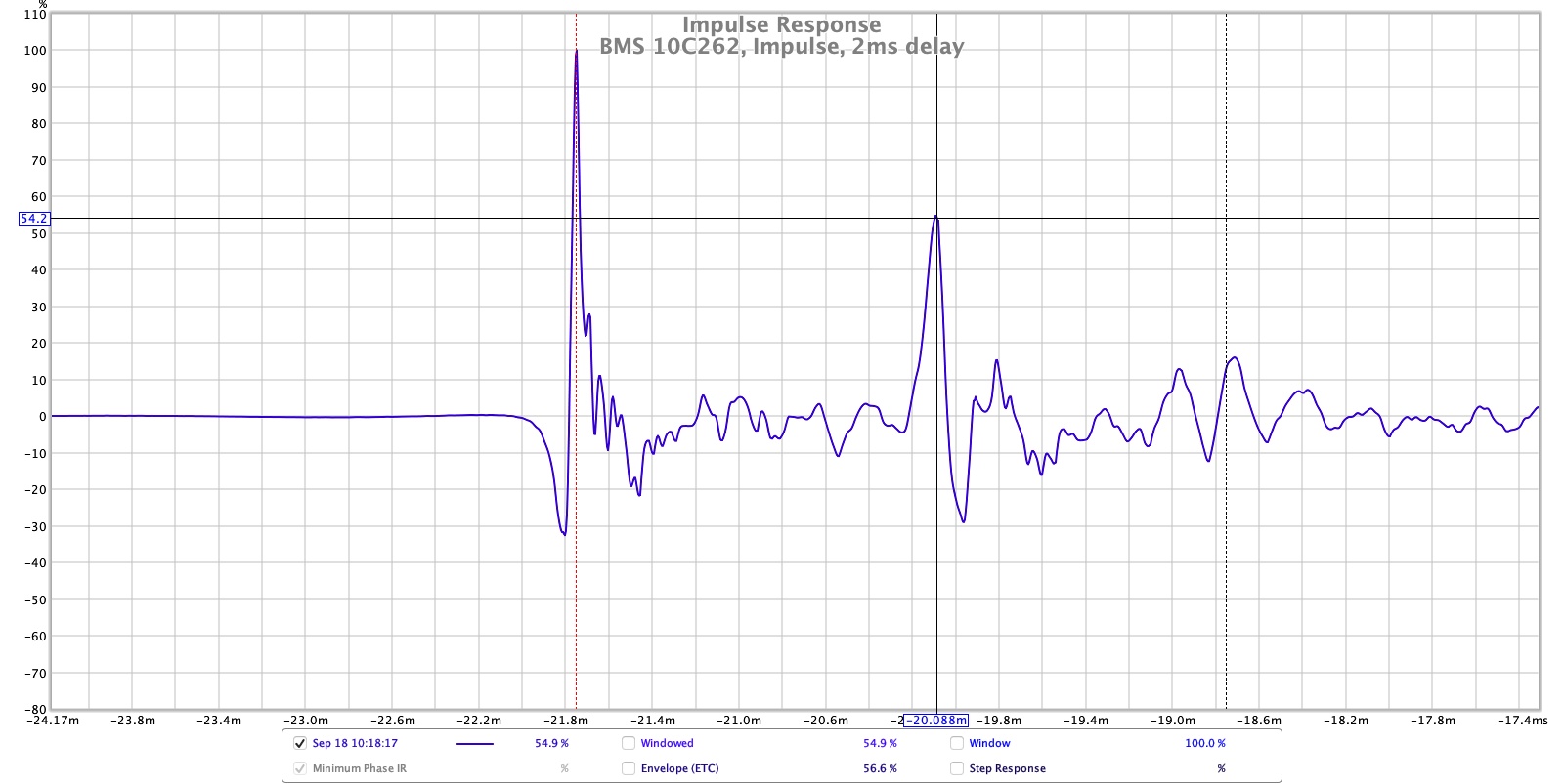

First of all I repeatedly measured delay/displacement between cone and compression drivers. I measured 0.34md from this closer distance, as you can see on the first picture.

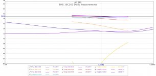

I also did experiment that I described in my previous post. It is on the second picture. I equalled SPL for both drivers in the crossover frequency (1300Hz, first two curves, bear in mind that UMIK1 precision is not better than 1dB). Then I gradually changed delay of cone driver in this sequence: curves for 0, 0.1, 0.2, 0.3, 0.35, 0.4, 0.45 and 0.5ms. As you can see max SPL is achieved approximately with delay in range 0.35-0.45ms, so it is the distance where relative phase of both drivers should be close to zero. So if you set delay of cone driver somewhere between 0.35 and 0.45ms (12-15.4cm), you should be fine. This 3.4cm interval means approx. +-20degree difference range in relative phase.

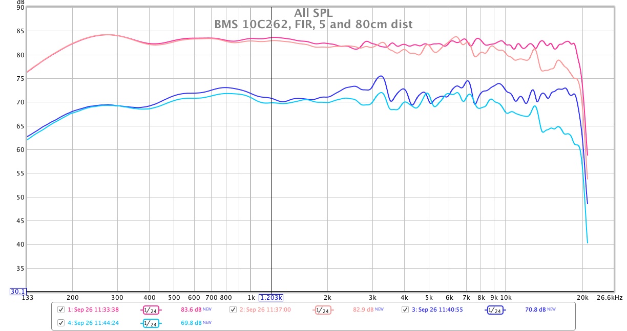

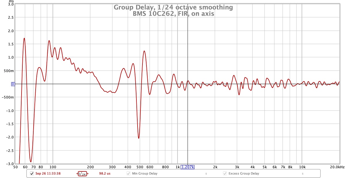

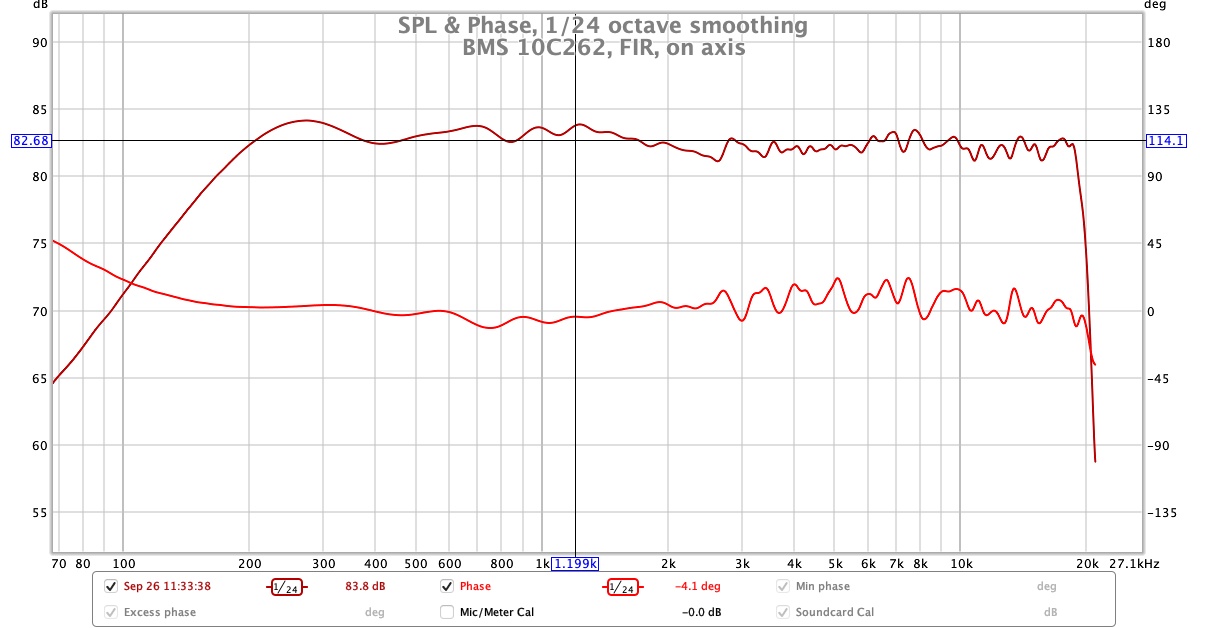

Here is the result on using FIR filters and equalisation. I used rePhase (really nice tool, Win based only though). I used 825 taps for cone and 825 taps for compression driver. Half of this amount would be fair enough for compression driver, and twice as much would be almost enough for cone driver, but I could not get phase right with unequal number of taps...so I kept 825 of them (I am running minidsp at 96kHz, so I am quite limited in taps number).
I used LR24 slope (FIR based linear phase filter) at 1200Hz and equalised amplitude/phase response based on gated nearfield FR. I was not able to get 400-700Hz region right due to low number of taps and there were some other obstacles, however this thread in non on FIR filtering, it is about BMS 10C262...so lets concentrate on it. You can see measured nearfiled FR (5cm from cone edge), gated (5ms), on axis, 1/24 oct. smoothed. As you can see phase is kept within +-20deg through all frequency range, crossover region looking good too. I measured also farfield (80cm), in room conditions, gated (5ms), on axis and off axis (30 degree), 1/24 oct. smoothed. You can se it on third picture together with nearfiled on and off (30 deg) axis FR.

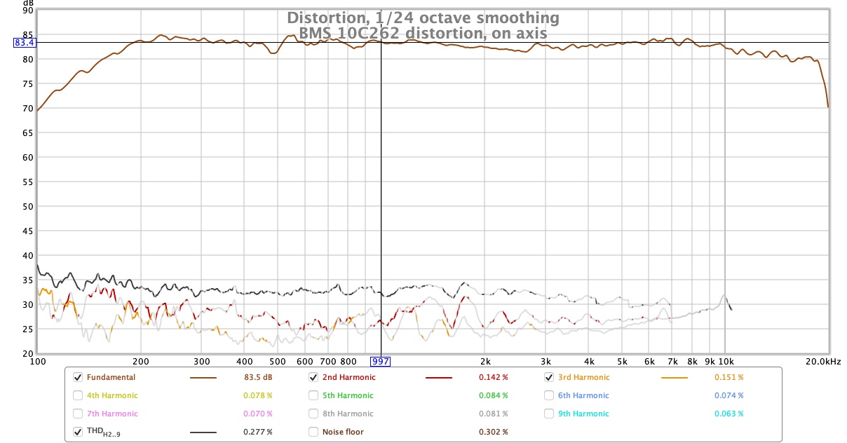

Nice looking measurements. Please show distorsion for the 5 cm trace! It would be nice to see also 45 deg...
It's mounted during meas as shown i post #1 i.e. in the grey box?
Here is THD measurement for 5cm mic distance. I am sorry I do not have 15, nor 45 deg measurements. I did those in previous posts (on raw drivers), I believe equalisation would not change coverage patters.
Thanks! I realise that 85 dB at 5 cm is not pushing the system that hared really. If you will measure again, 90 dB at 1m would be interesting to see. As would 45 deg. Agree, EQ don't affect directivity.
