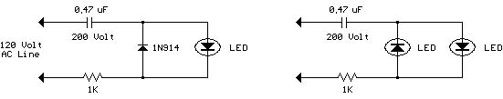

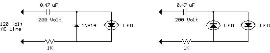

Here are some led circuits I copied from somewhere sometime back. The circuit can be connected directly to 120V AC. The cap is used for voltage drop - the lower value of cap will provide higher impedance and hence dimmer light.
