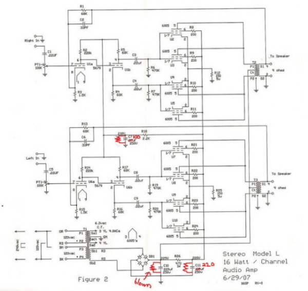

Here is the schematic. The resistors are indeed 270K 1W. C7 on the PCB is located right in line with C10 and C11, so I took it to be one of the power caps as well -- I put bleeders on all the electrolytics. The capacitors were in the correct polarity as well.

- Those caps that you increased in value, is the voltage rating at least the same as the originals?
-Make sure those electrolytics aren't in backwards.
-Try leaving the C7 bleeder only.
-What is the voltage rating on C7? That should give an idea of operating voltage for the circuit. Make sure the Max working voltage of the resistors your using for the bleeder are at least that value.
-After the brief power up with C7 bleeder only. Quickly feel the insulated part of the caps to see if their heating up. Only use one hand and be careful not to touch anything else, as the circuit may not be completely discharged by this time.
-Remember not to apply a signal without a load attached.

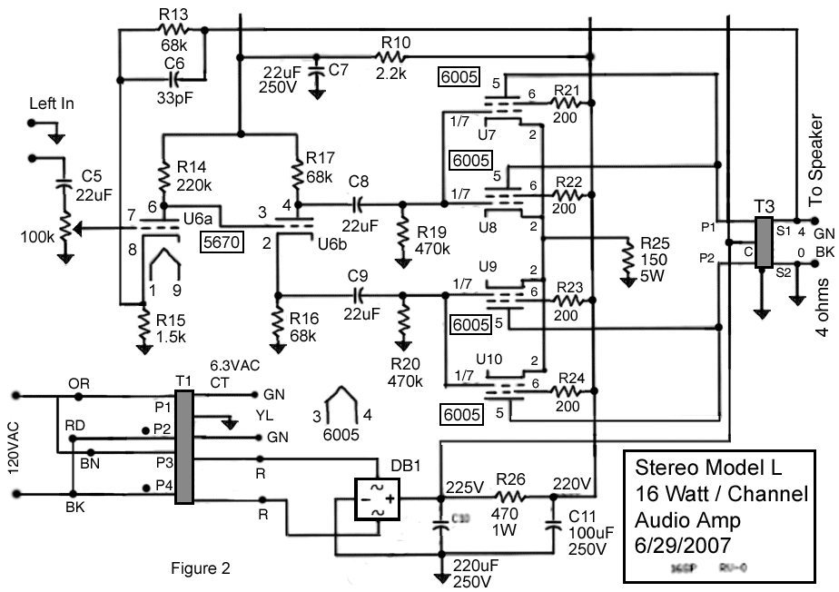

Well, if i look at the schem, the resistor between the caps is rated 470 ohms. If BOTH the bleeder and the series resistor get hot, and i suppose they are within eachothers range in power dissipation, there is no way that the beleeder is indeed 270000 ohms.

fenpark15 said:
Sorry that image is such poor quality. I had to reduce my scan way down for the site to let me post it.
Save black and white images as GIF files, not JPG. They'll be much easier to read that way.
Good luck trying to run down the cause of the trouble. For what it's worth, I'm betting on the bleeder resistors being the wrong value.
Thanks for fixing the schematic. I tested the resistors with a meter and they are 270 Ohm instead of 270K. Parts Express sent me these in a bag labeled 270K.
