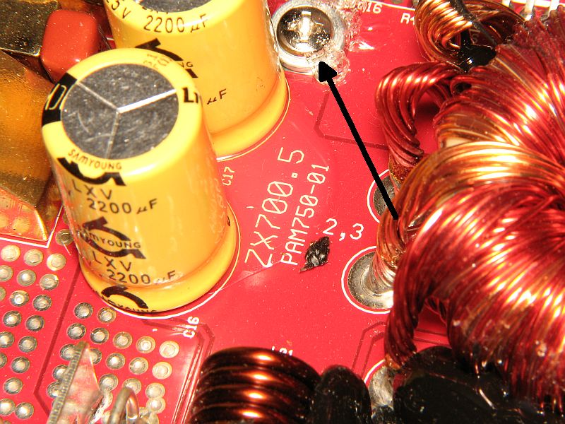

no, didn't have more than .001 on any channel, Yes the relay clicks in. Now that I have this thing mounted up, It is starting to blow the inline fuse. And makes a hissing sound out of the mosfet area. It won't let me keep it on long enough to determine exactly where it is from. Also the c15a gets really hot real quick. It gives me about 10 secs. before it blows the fuse.
Perry, I am sure mine never had those washers on it. We do mercedes, bmw dash work and are very very careful when we take things apart. Mine has two plastic spacers installed that make sure the screw never touches bottom. I have installed the washers and it quit hissing and blowing fuses.

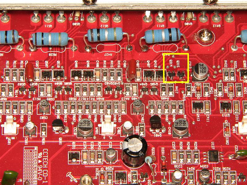

Now that you see that all channels are working properly, you need to solder Q04 back into the circuit. If it goes into protect, we'll have to try to troubleshoot the protection circuit.
Don't play it for too long with the protection circuit disabled. If something fails, it could cause extensive damage.

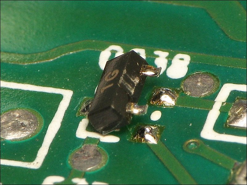

Lift the two transistors highlighted in the attached photo. Does it still go into protect mode?
When you lift them, apply enough solder to bridge the two adjacent legs so you can heat both at the same time. Apply heat and lift the transistor to a 30-45° angle. Remove the solder from those two legs and leave the transistor in place (see attached).
Make a note of the markings on the transistors before you try to desolder them.
