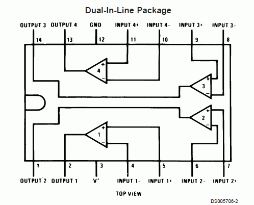

Look at the pin numbering on the attached image.

I have 150 ohms between pin 3 and pin 1. The pin id goes as follows:
LM339
Pin 1: 6.52
Pin 2: 0
Pin 3: 6.45
Pin 4: 6.45
Pin 5: 0
Pin 6: 6.45
Pin 7: 0
Pin 8: 6.45 pin 14
Pin 9: 6.45 pin 13
Pin 10:1.0 pin 12
Pin 11: 6.45 pin 11
Pin 12: 6.45 pin 10
Pin 13: 6.05 pin 9
Pin 14:6.45 pin 8
