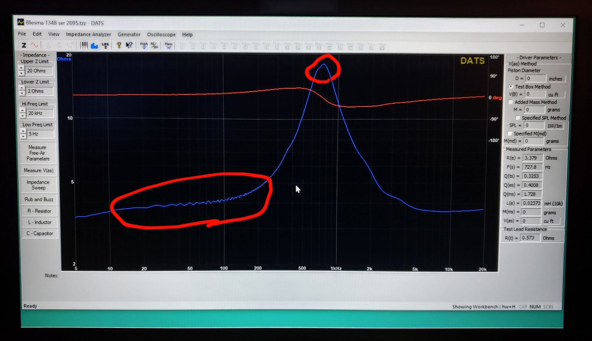

I think profiguy should focus on the region of interest. Like what's to the RIGHT of 700Hz.
We don't care what's happening at 16KHz for subwoofers, and we also don't care what's happening at 200Hz for tweeters.
@profiguy - you are perfectly within reason to ignore anything to the left of 700Hz on that impedance peak.
You don't want that tweeter to be playing any NEAR of 700Hz, let alone below it.
The next step is the take frequency response and distortion measurements from 700-1KHz up and see how the two compare.

So I finally heard back from Stan at Bliesma.
He believes it may be an air leak of the chamber and not the VC. Im skeptical that its the case, but I'll be revealing the chamber again and see if that is the cause. A leak usually causes other issues, but I'm going to be open minded and see what happens.

Of course I wouldn't operate an HF driver below its fundamental resonance frequency. That would be idiotic. I mentioned this are for sake of comparison to the other tweeter to point out the difference between the two as a pair and a probably cause for the issue im hearing during testing.ANYhow, moving forward.

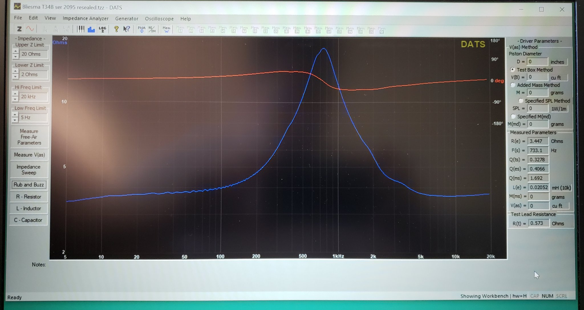

I just sealed up the gap on the side of the chamber with softtac putty anf remeasured impedance. It appears to have improved a bit, but it didn't change the Qts much in the direction of the other driver. I'm gong to pry the chamber off and inspect the sealing pattern left behind. Hopefully this is the whole issue... fingers crossed.
Top is new trace, bottom is old.
