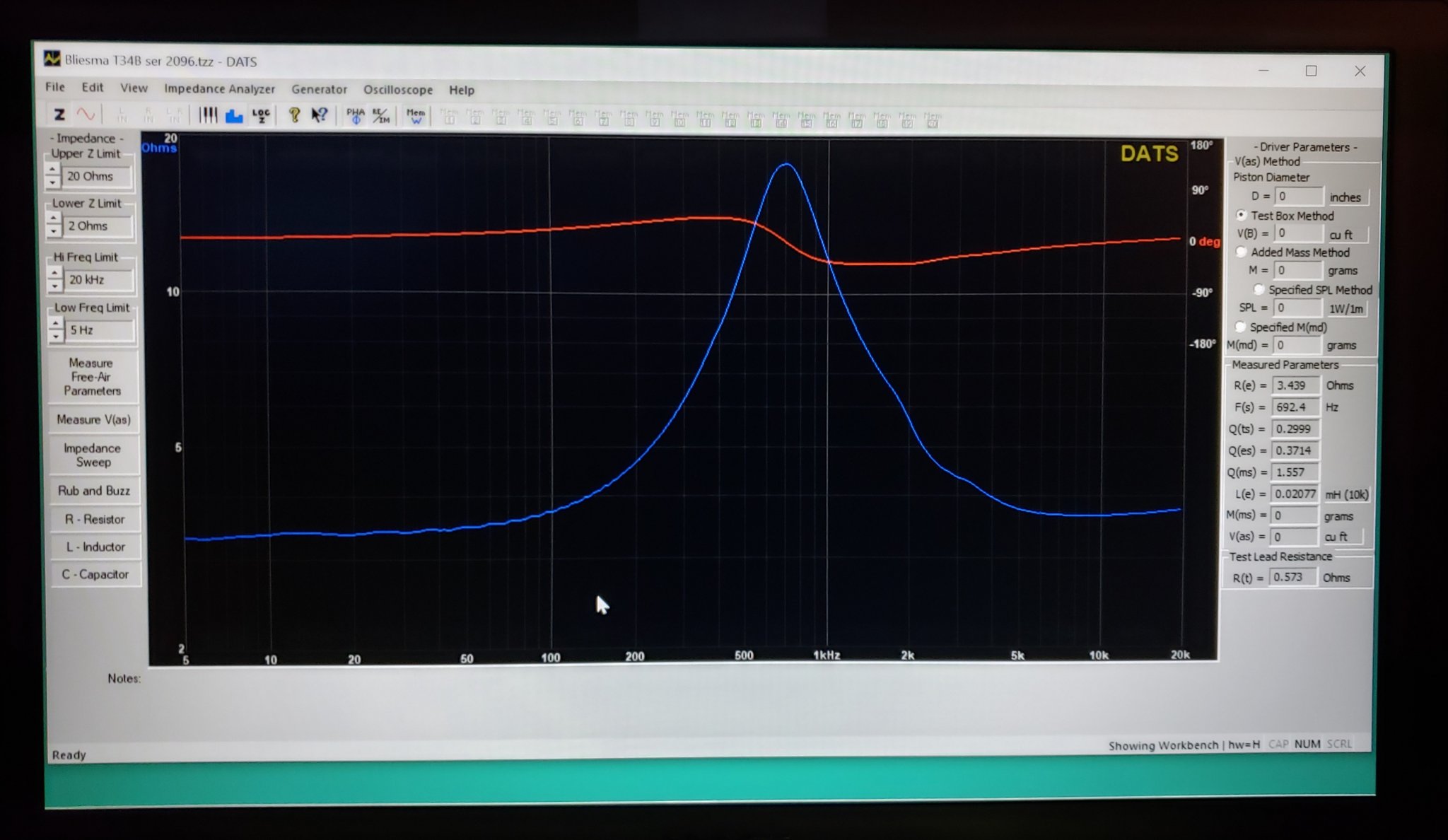

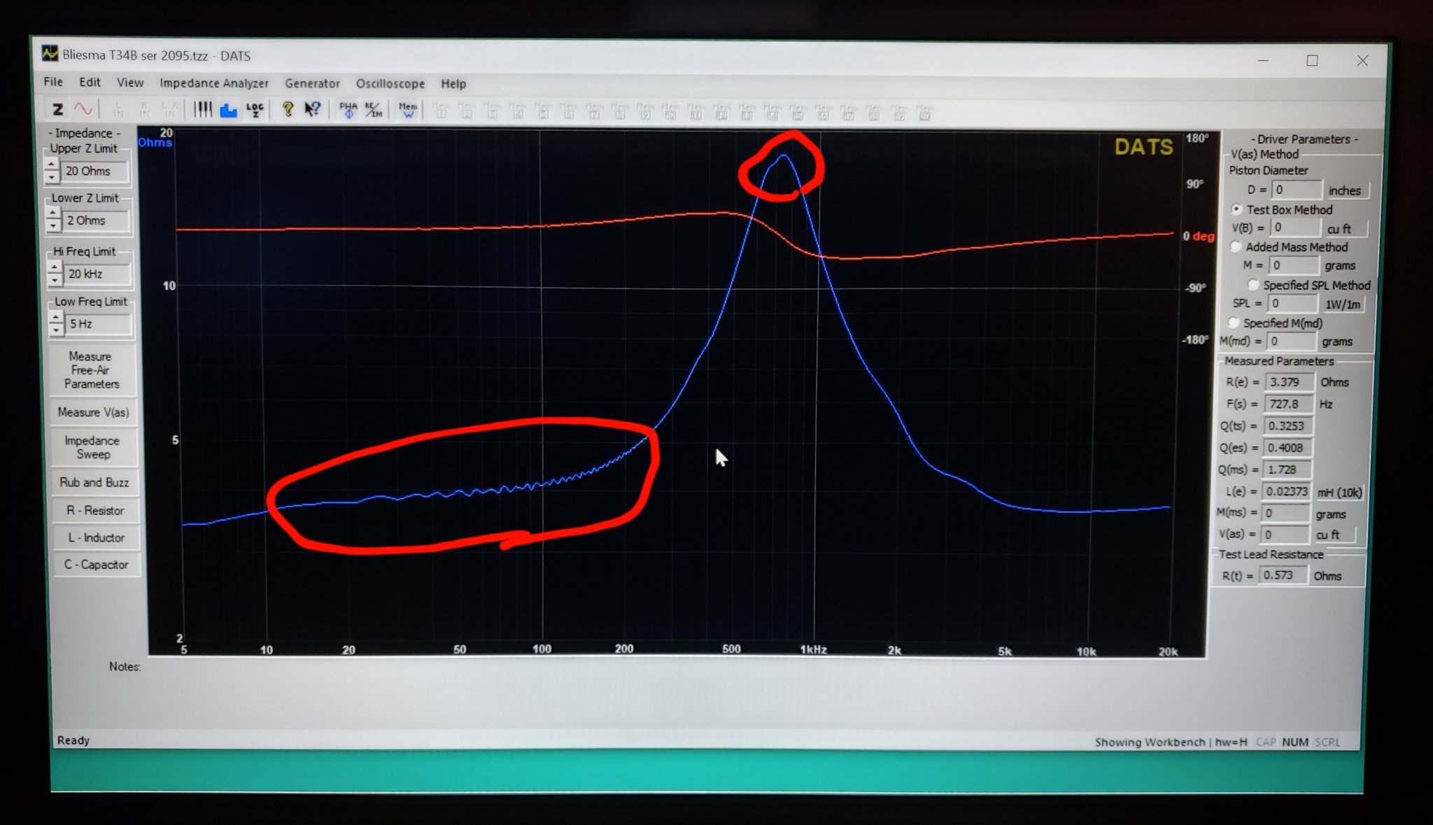

So my T34B saga continues. Now that my back chambers are re-attached, there is a new issue.
Today, listening to the tweeters with a 1V sine wave sweep, I can hear some fuzz around the area under 1.5k on one of the driver's.
It sounds like a rubbing VC, so I ran quick impedance sweeps on the DATS test setup. Low and behold, it looks like a rubbing VC. The TSPs are also a bit different which shouldn't be on a matched pair of drivers, unless they're only matched for FR and not overall parameters.
My question is, has anyone with these tweeters measured them as a pair and how did they look?

The impedance curve on the bad driver looks like there's an air leak at the chamber, but i tried some blue masking tape to seal around the gap between the magnet and chamber - no luck. The rough peak is an indication of a mechanical issue in the moving assembly.

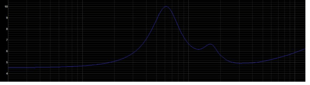

Can you take a screenshot (using Windows Key, Shift, S) to further elucidate the differences? Also, perhaps have the Zmax as 30 ohms, or something like that, so we have a zoomed view.
The differences may be there, but they actually might not make a practical difference, particularly since its not in the passband where you will typically use these tweeters.
I'm not apologizing any discrepancy, but what I'm trying to reassure you is that what happens in the impedance trace above Fs is certainly much more important what happens below Fs.
I was once checking one of my tweeters, which had a odd dual impedance peak. Specified Fs is 600Hz, but this one had something going on higher.
Tweeters still have a lot of output between 1-2 KHz, so this was a real problem.
It took awhile to figure this out and fix it...
None of my other dome tweerers I tested had any wrinkles like this or were this different across the range, even if they weren't matched. The big discrepancy is under Fs if you compare both and its not acceptable for this price range.
I did once have a set of Morels that had faint VC buzz at lower frequencies on one tweeter. That one eventually failed and upon inspection of the VC, there was a crease in the VC former and a shiny spot on the windings which shorted on the upper pole piece.
