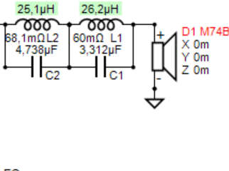

Per PM request, Here are the values for the M74Be twin notch filters posted here earlier in this thread :
26µH // 4.7µF and 26µH // 3.3µF.
Please note that these values will have to be slightly adjusted according to real impedance data of each driver for the max performance.
In general, measure real value of each capacitor, introduce it in VituixCAD, optimize the value of inductor accordingly, wind the coil and adjust the value with a LCR bridge

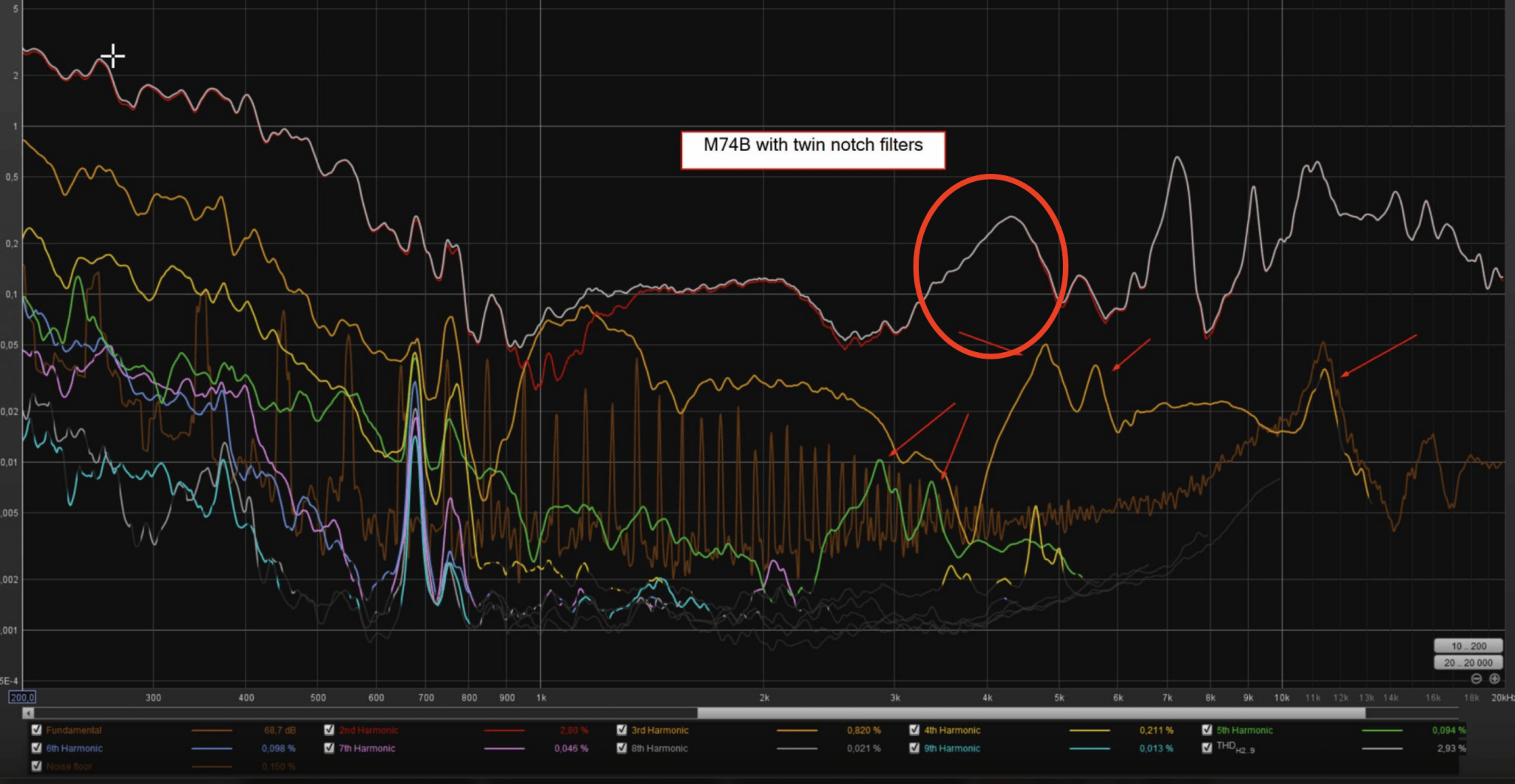

Sorry if I missed the info in your posted measurements, but at what SPL and distance was the distortion measured?
Your mistake, look the picture more carefully, 4K H2 (red) is not down by anyway but hidden, by THD
I was showing H3 and H5 there
Ah OK I understand now,
I have no clue maybe related to the big dip around 12 K but anyway with a crossover around 3 - 3.5 KH I don't care...

By crossing it lower 🙂How can we bring the 4k H2 down?
Btw the breakup paranoia is a little bit unfounded imo, I'm crossing with FIR 48dB/Oct at those frequencies so I'm not sure what is there to gain by those notch filters.
Something that I also just noticed, your measurement with those notch filters actually has more total HD than without them
Isn't because you are just looking at the THD number in the lower part of pictures, on my side when I look at the whole picture I can see a very noticeable improvement...
