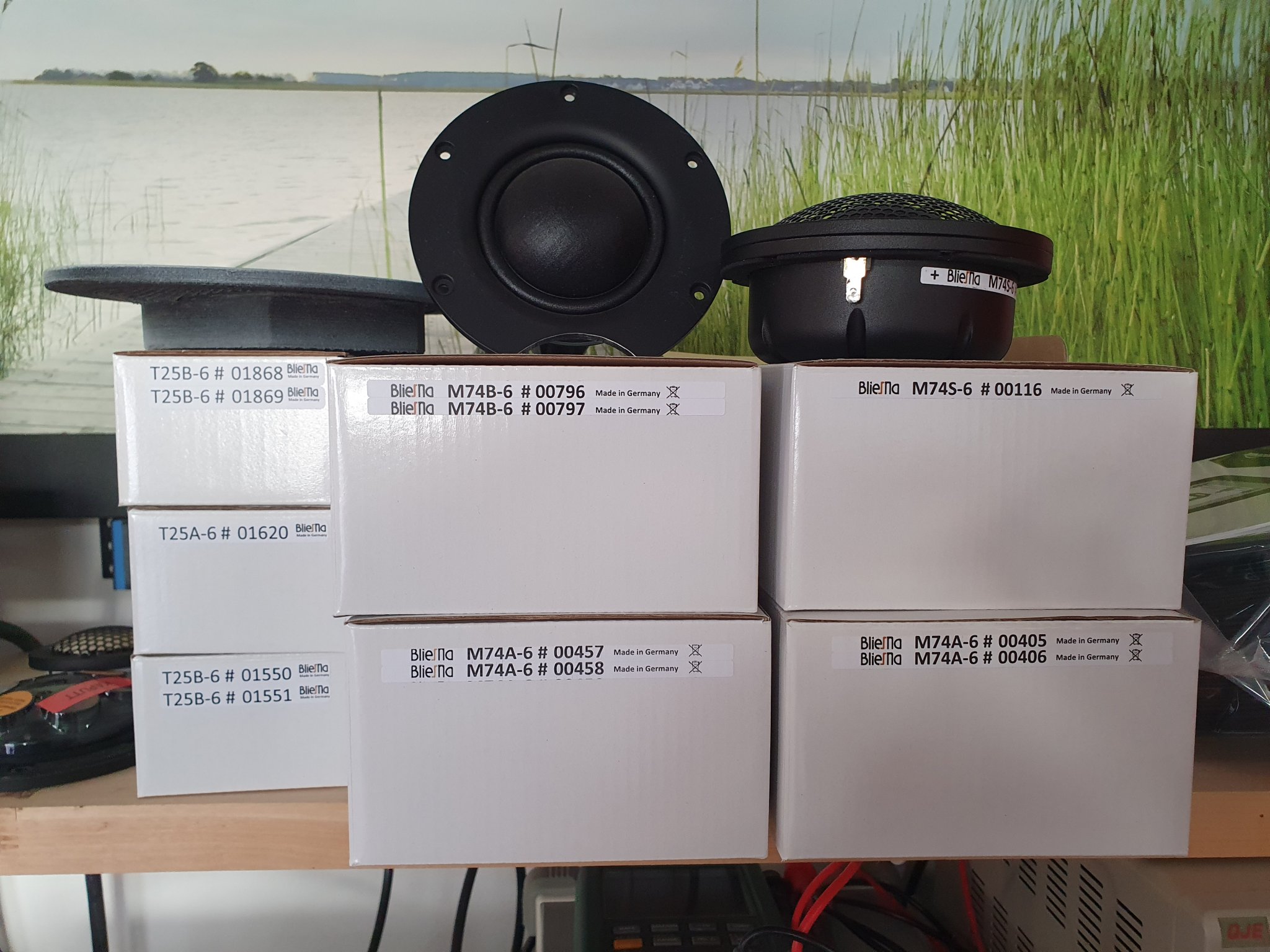

I did this experimental setup to compare the Bliesma drivers. Not perfect but better a most setups. Just got the M74B, to the listening comparison of A and S I alredy wrote some words.
I would GUESS the ATC will be somehow in the middle between these 2 (membrane harder as M74S but not as stiff as aluminium). You can crossover 100Hz lower and it's proven that it takes a lot of power. But the ATC is way bigger to mount (more distance to the tweeter) and frequency response is not as nice.

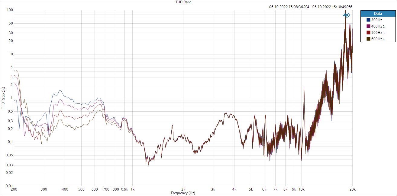

Depends how loud you play and what THD you can accept - as always with domes (also tweeters). And what LF driver you use, what's it's THD at volume and is it lower as the Bliesma.
Here a measurement at 100dBSpl with different cut of points (active, 24dB/Oct). At 100dBSpl most low frequency drivers have >1% THD.
I will aim for 400-450Hz crossover.

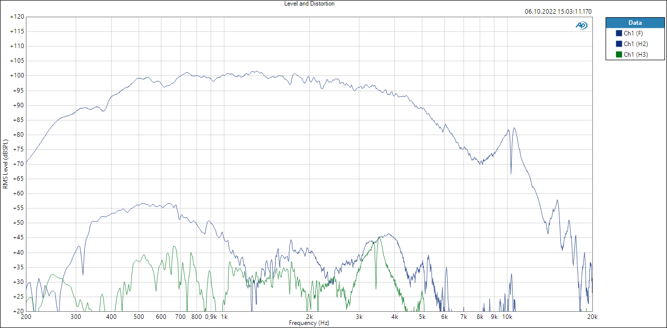

These measurement levels are in 1m. But I'm not sure if mic position is 1m, sometimes I go closer and correct SPL for 1m distance. (to get less room influence)
Here you can see H2 and H3. Higher ones are not prominent. The THD rise at lower frequencies is purely H2, ther is also no rise of H3 at very low crossover frequencies.

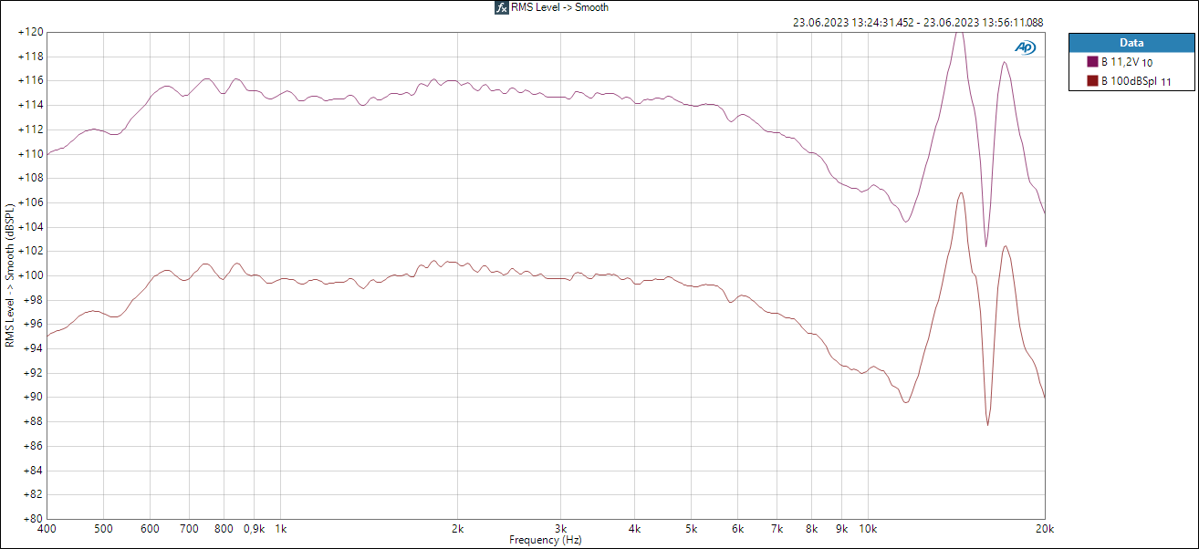

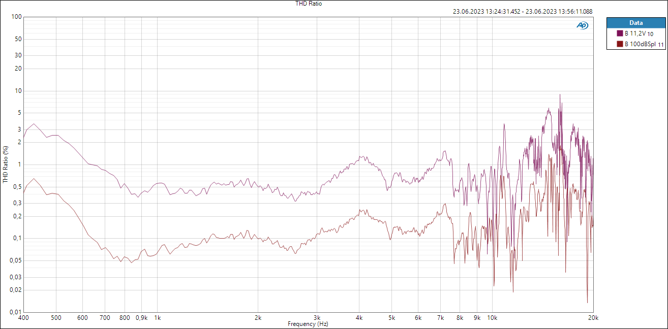

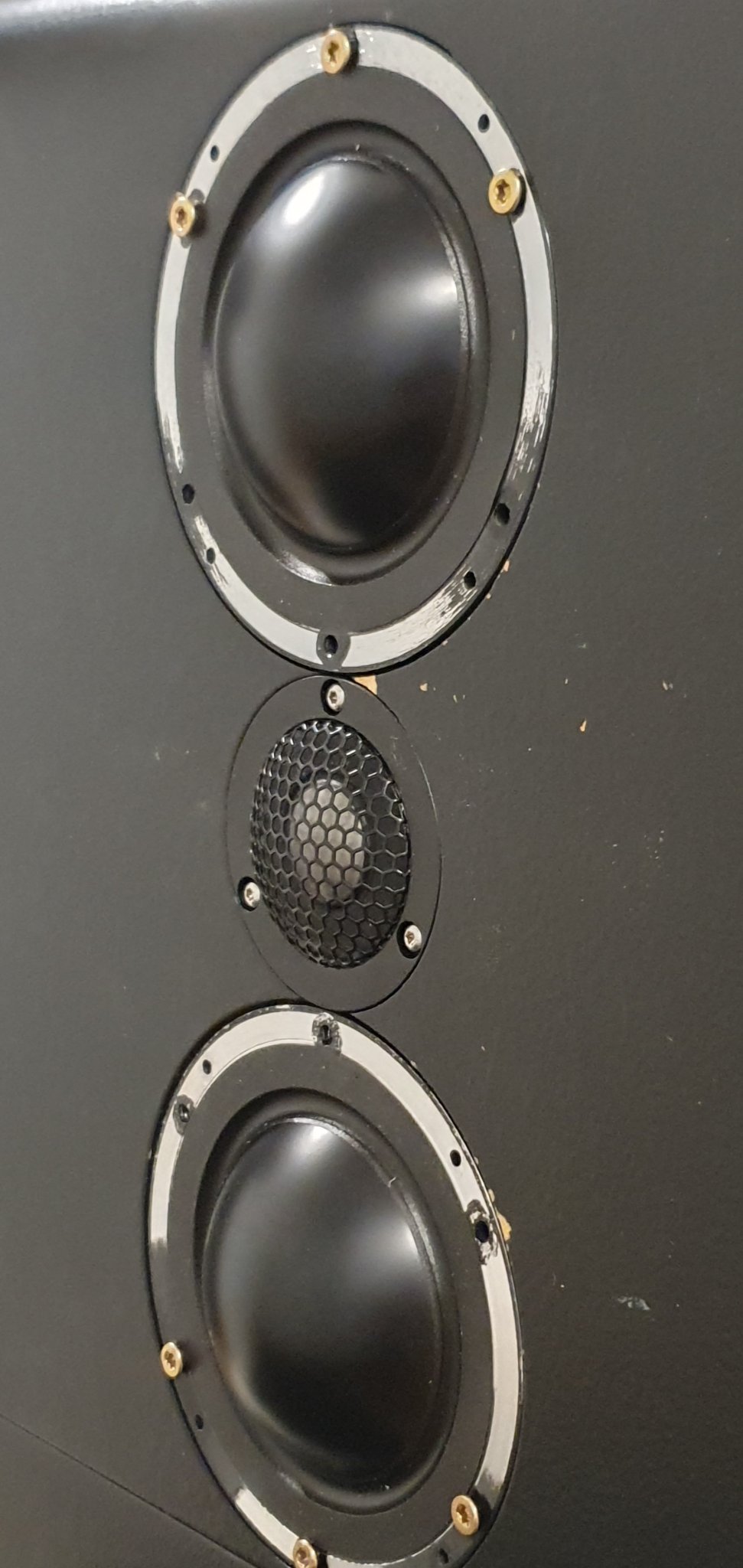

Just made THD measurements with 2 M74B.
Measurement distance is 0,5m but SPL level is for 1m distance. No windowing. Just a MTM prototype setup, the A version of the pic above is changed to original M74B.
Remeber - these are 2 drivers! So you have to subtract 6dB.
But still ... that's 0,1% THD at 94dBSpl (which is pretty loud!) And about 0,5-1% at 110dBSpl!
You could easy go 6dB more with these drivers and a proper crossover, probably 10dB.
