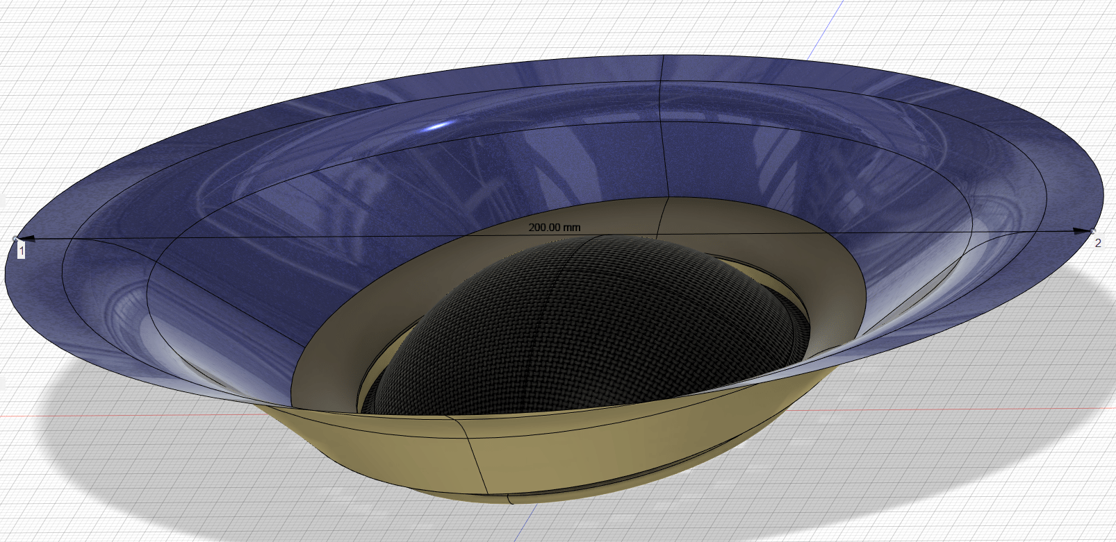

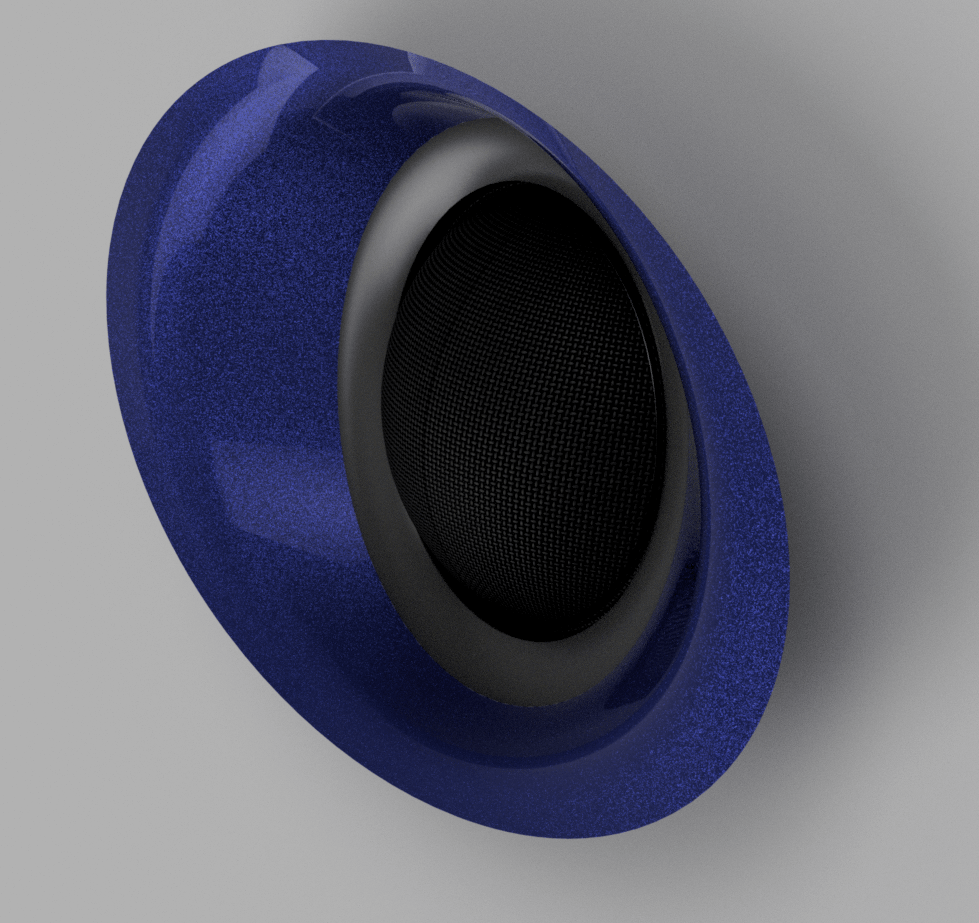

You are right it does not seem to need to be particularly complicated, conical sections and radiuses work well.

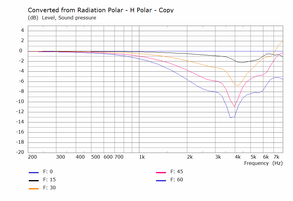

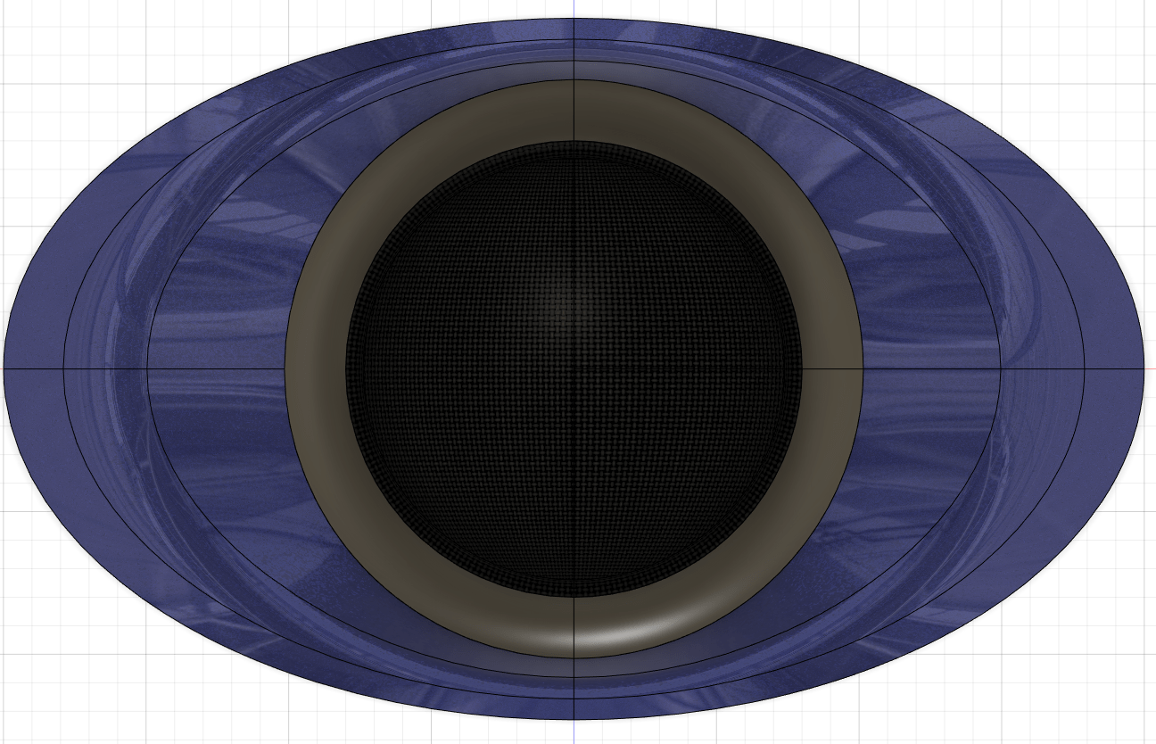

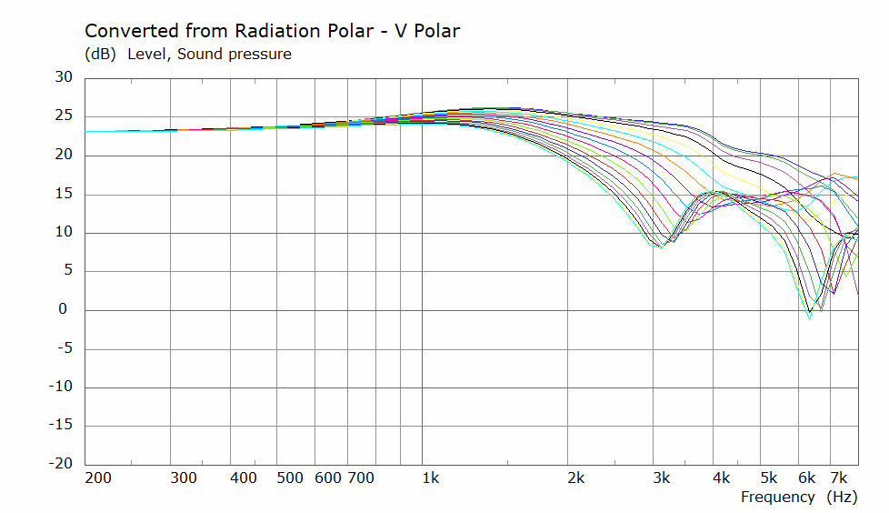

An elliptical version with quite a steep vertical wall angle simulates surprisingly well (with the included waveguide lip on the driver) terminating into an infinite baffle.

I'm curious what function so small waveguide has? Is it to recess the driver to keep it safe while moving the speaker around or some other practical thing? If I compare to datasheet responses there doesn't seem to be much change in directivity.
Looks great! How deep is this shape? Could you leave the protection grid on when you start 2mm wider?
I would have to check but I think about 18mm up from the existing lip. The waveguide starts exactly where the protection grid finishes on purpose as I do not want to have to take it off, as there is more risk of misaligning the magnet system in the Mid.

The width can be whatever is chosen, this was a test example to see if the result would be bad having such a steep vertical angle and it was surprisingly good.
The profile is the same as a circular one I made just swept around an ellipse instead of a circle.

It gives a little more directivity in the Horizontal and quite a bit more in the vertical. It is different to the bare driver simulated in an Infinite baffle.
@fluid - what is the angular divisions on your simulation plot? are there 10 degrees per division?
These are 5 degrees 0 - 90 degrees except the observation spectra doesn't quite make it to 90

I also was surprised but there seem to be a 0 at already about 3k vertically - that's the price to pay.

I checked and it's 22.3 mm from the top of the drivers waveguide lip to the baffle termination point, so with 25mm material it could be routed out of the baffle in one sheet.
Also to show the scale in case it seems small the width is actually 200mm
For a 3K crossover point it's no problem but if someone wanted to cross higher it could be adjusted. Increasing vertical directivity is quite useful if the ceiling isn't going to be treated.

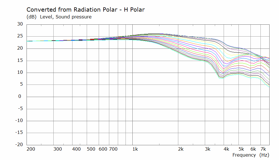

Here is a normalized Horizontal graph that can be directly compared against Hificompass's normalized plots, the paper version is probably the best one to use as hard diaphragms tend to be more like a simulation.

I thought the same thing, until @fluid clarified that the lines on his plot in post#103 were 5 degree divisions. In truth, the IB mounting of the M74B gives us a 60 degree horizontal response of -2 dB at 2k, and -5 dB at 3k (according to hificompass)... The waveguide gives us -6 dB at 2k, and -8 dB at 3k. This is a substantial increase in directivity.

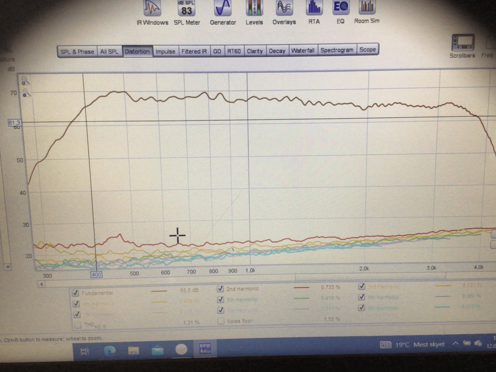

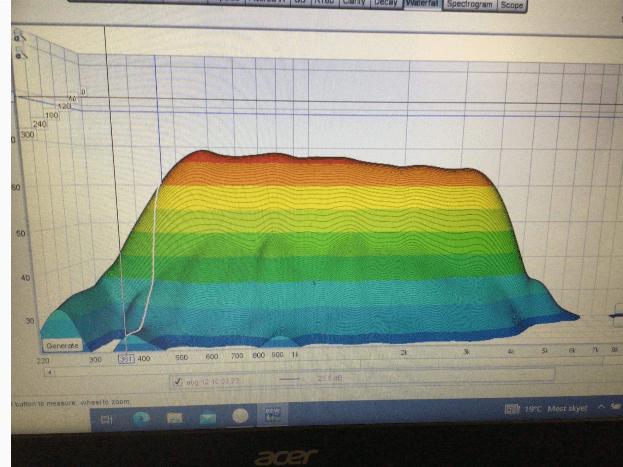

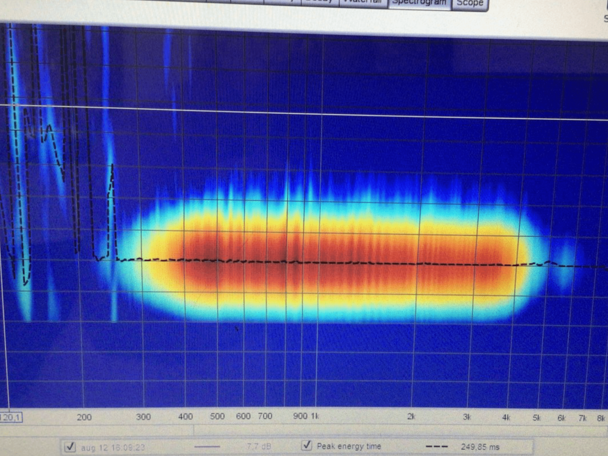

Yes 48db 4000 hz and 24 db 400 hz

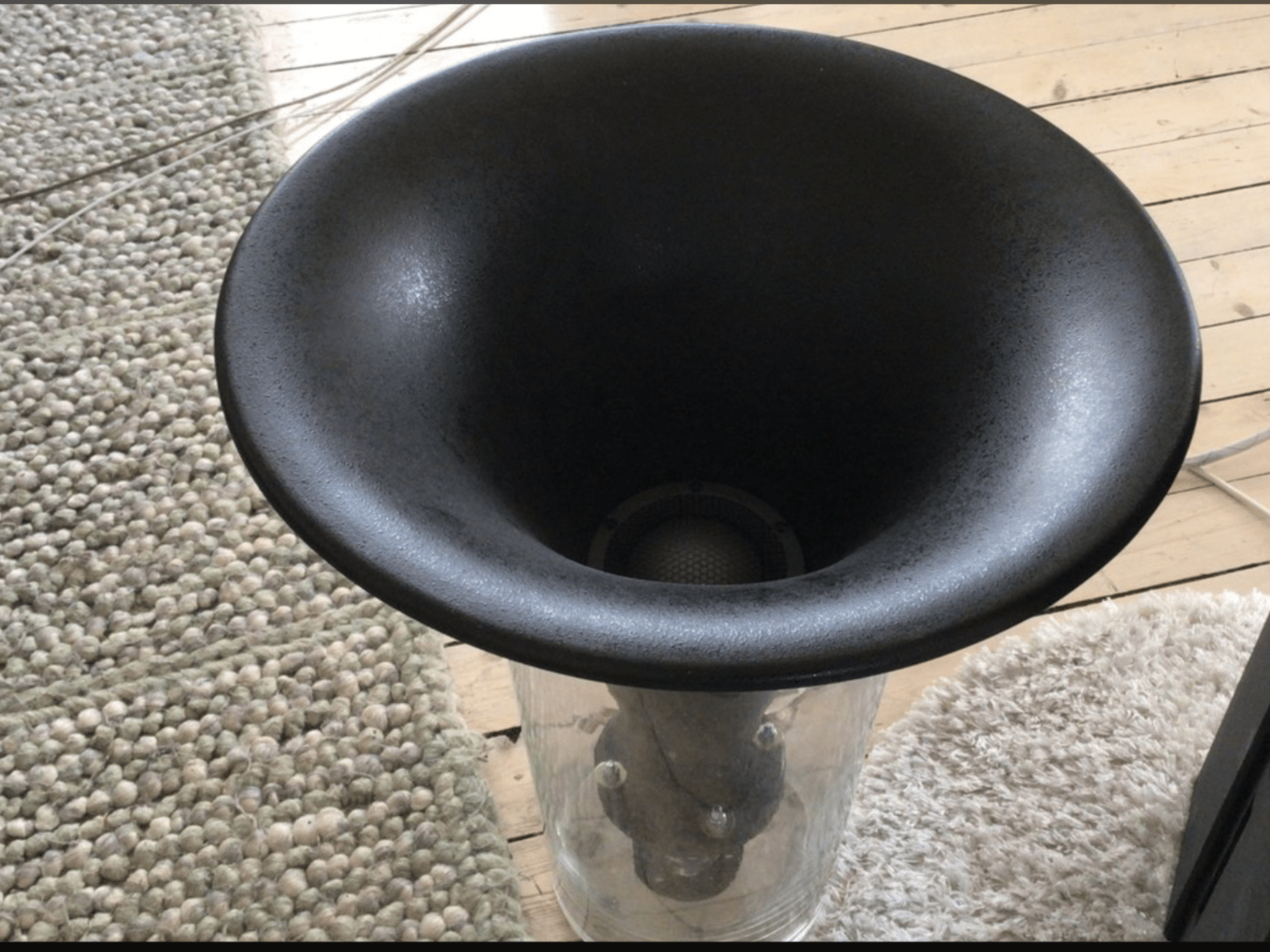

the driver is loosely positioned in the horn
i don't want to cut the horn,
this was only a test, whether this driver can possibly fit in a horn/large waveguide, depth approx. 19 cm on the target image above
A properly fitted neck, this dom will play to about 6k in this horn.I think

Looks good! ...
Na, looks only partially good to me. Approx. 0.7% HD above 1kHz is much above the THD level than what hificompass.com measured "as is", and really not so impressive. Furthermore, a well-matched, well-made and well-fitted horn would be expected to lower the THD figures altogether.
So, what is going wrong here? Is this specific driver (e.g. the DIYAUDIO-measured DUT) flawed? Or one of these measurements (method/mic)? Or may this high THD figure result from the driver-to-horn-mismatch resulting from the described (simplyfied / horn-sparing) setup? Or whatelse?
Trosse1 did not state the input voltage of this measurement. Coincidally, this seems not so imporant, because the measurements of hificompass all show more or less similar results for freq. >1kHz at very different input levels. Instead, below 1kHz there are huge differences. Anyway, it would have been appreciated to know about the setup conditions of this measurement here.
