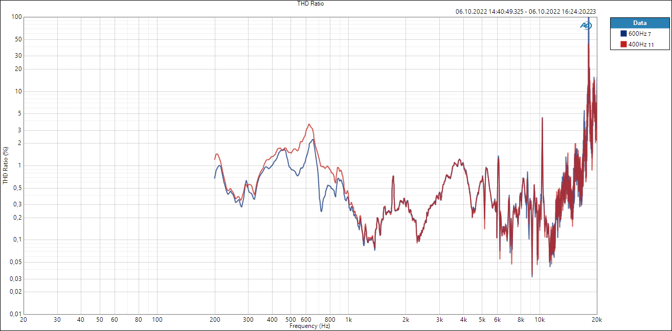

I just did some measurements with the Bliesma M74 drivers and they are easily useable from 400Hz! THD is a little higher then in this area but depending on your listening leven that will never be a problem. And depending on your low frequency drivers it will probably still be lower at what the LF driver does ;-)

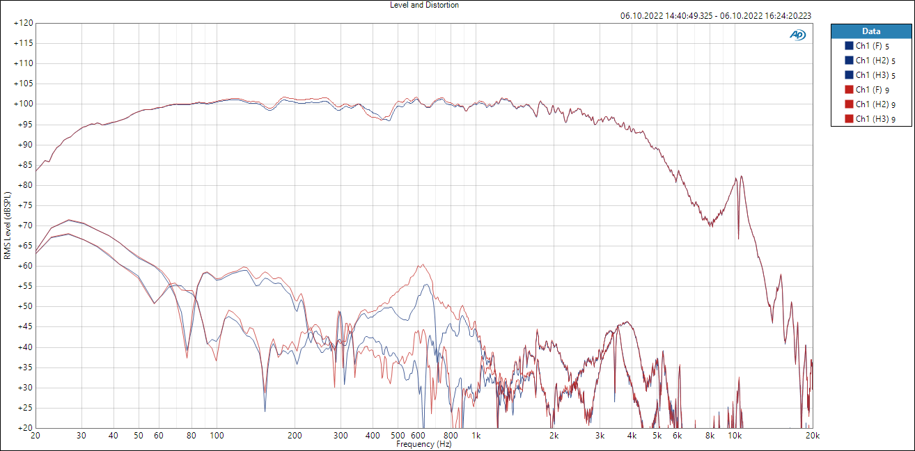

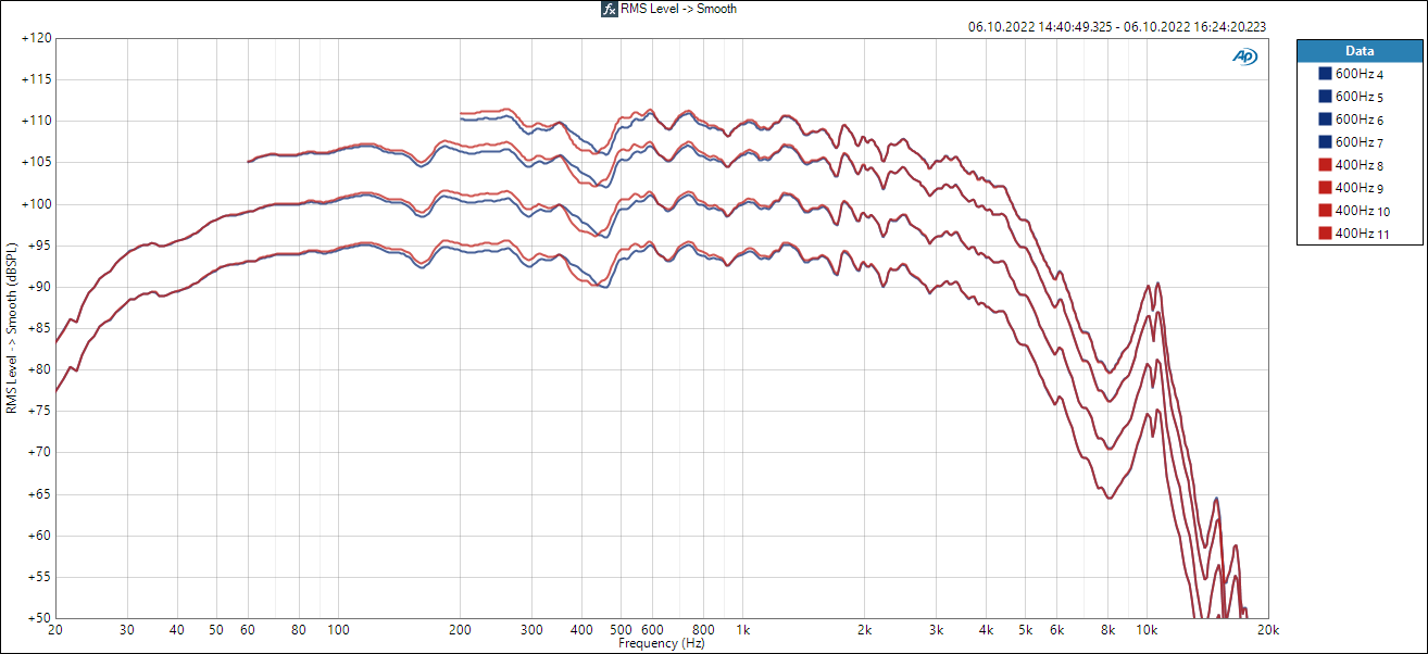

Here are some measurements from the prototype I built. That's far from the finished speaker but good enough to look at the possibilities with these drivers.
Measurement distance is 0,5m but level is corrected for 1m distance. Hypex DSP module as amp, upper filter is 4kHz. SB Acoustics 12" driver which performs incredibly good! But 110dB in 1m ... you need more as one 12" in a closed cab for that for low frequencies. And these measurements schow the M74A - which I prefer over the M74S after some listening tests.

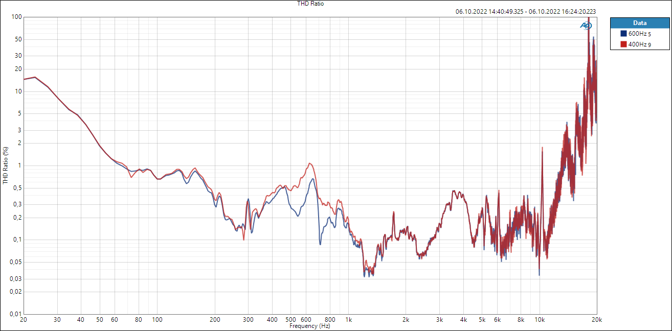

THD at 100dBSpl. The peak at 600Hz is caused of a filter I set there - in reality it's 3dB lower (stays at 0,5%) with the 400Hz crossover. Just forgot to switch it of for these measurements ... happens when you perform hundreds a day ;-)

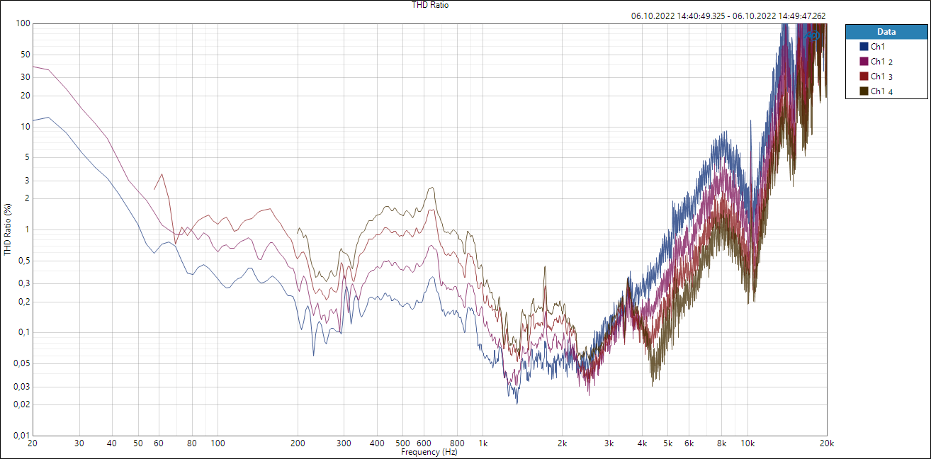

Even at 110dBSpl it stays <2% of THD and <1% over the most critical range.

And in this graph you see it's mainly k2 which is higher when you choose the lower crossover point. When drivers are on their limit k3 starts to raise rapidly - that's not the case here.
There is plenty more data but I don't want to spam this post. I will try to chose a crossover point at 450-500Hz for my design but would not hesitate to go lower for a living room speaker.

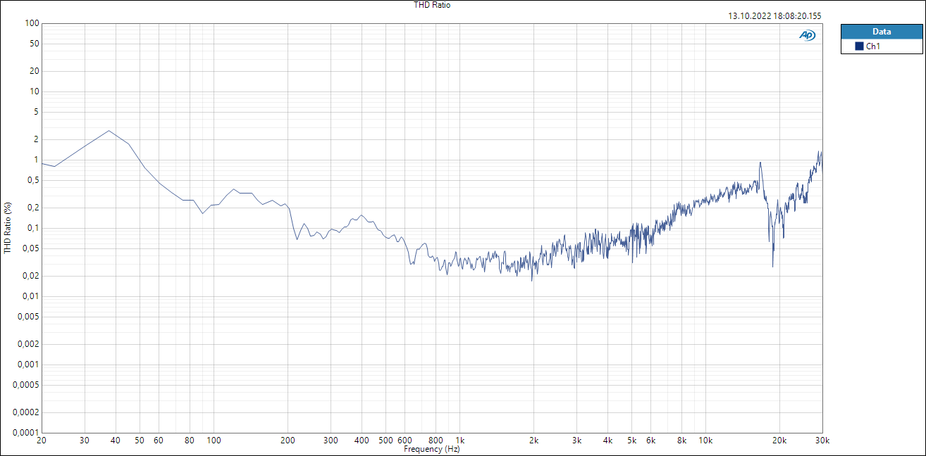

Not really, I need to check more extreme situations for my use case. But there is a measurement at 94dBSpl in 0,5m - but these are 2 aluminium 3" drivers in MTM configuration and one 12" low frequency speaker. Cross over about 450Hz and 2kHz.
That would be about 82dBSpl from one mid driver in 1m distance.
