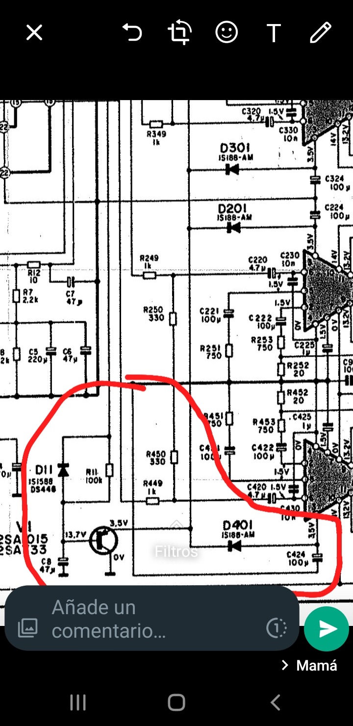

Are you using the speaker level inputs or the DIN inputs?
The values aren't legible on the diagram you posted but you're working with op-amps so, unless the EQ section can't withstand the higher voltage, you should be able to increase the gain of the preamp level circuit.
This is a better version of the diagram.
Stop !!!. Wait a moment. In the @Perry Babin's schematic, there is a mute circuit affecting all 4 IC's. Did you check that?
I'm using DIN inputs.
I was thinking of setting the gain higher, but in case of clipping I would make single 4558 / NE / TL preamp with say gain of 4 and the output of the eq.
Would removing it be right way to test it?

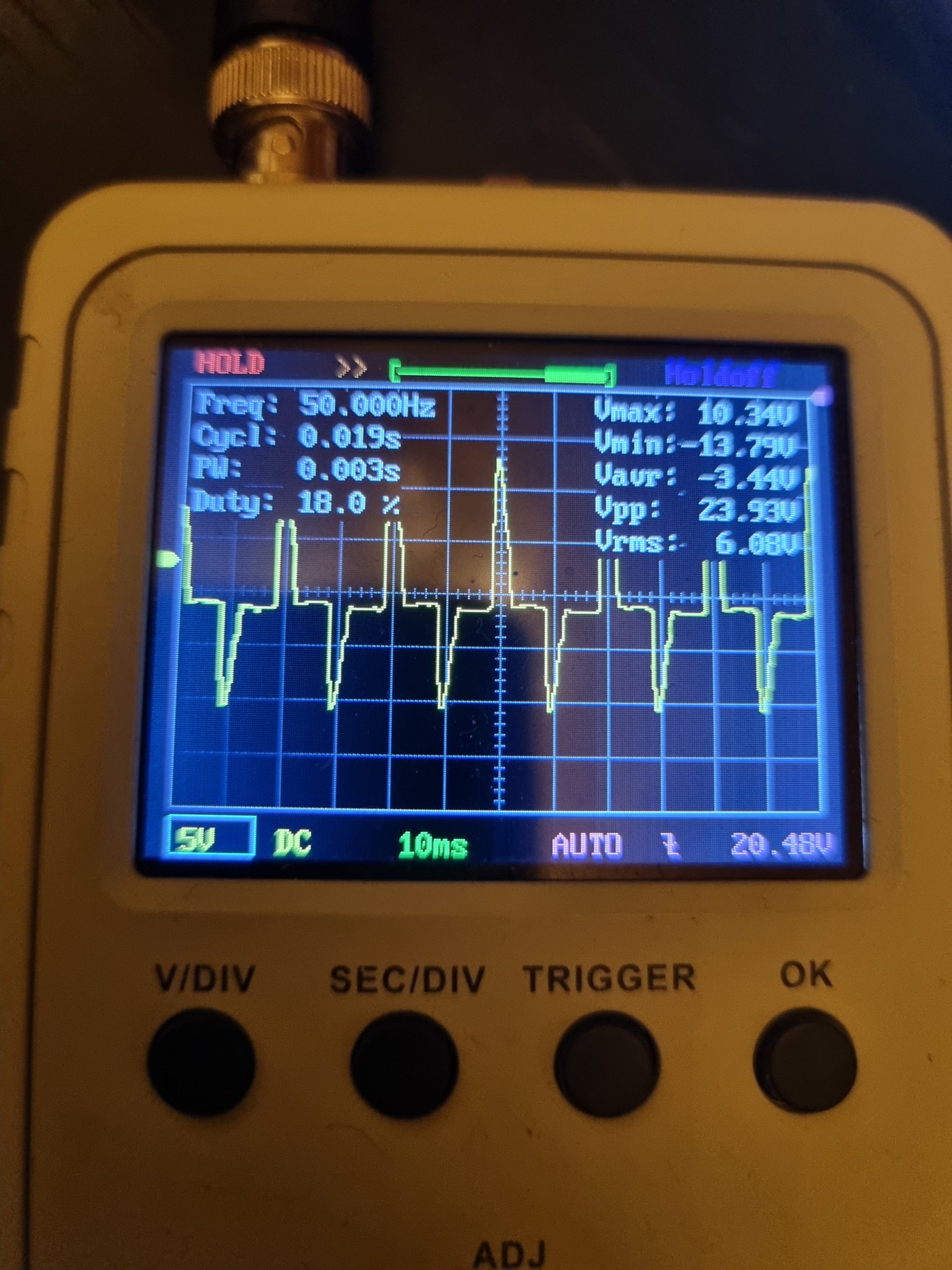

I tested it with oscope and I get this on all 3 pins:
EDIT:
Forget the picture... bad ground to o scope is the cause, it's all straight line.
Dont mind the voltages, this oscope is ****.
DMM shows:
13,7v on base
6,4v on emitter
Collector = gnd
Schematic says 3.5v for emitter... something is going on there...
One of the fautly ics could cause it I beleive?
If correct I would remove the diodes, this way I could see if transistor or one of ICs is pulling voltage to 6.5v.
