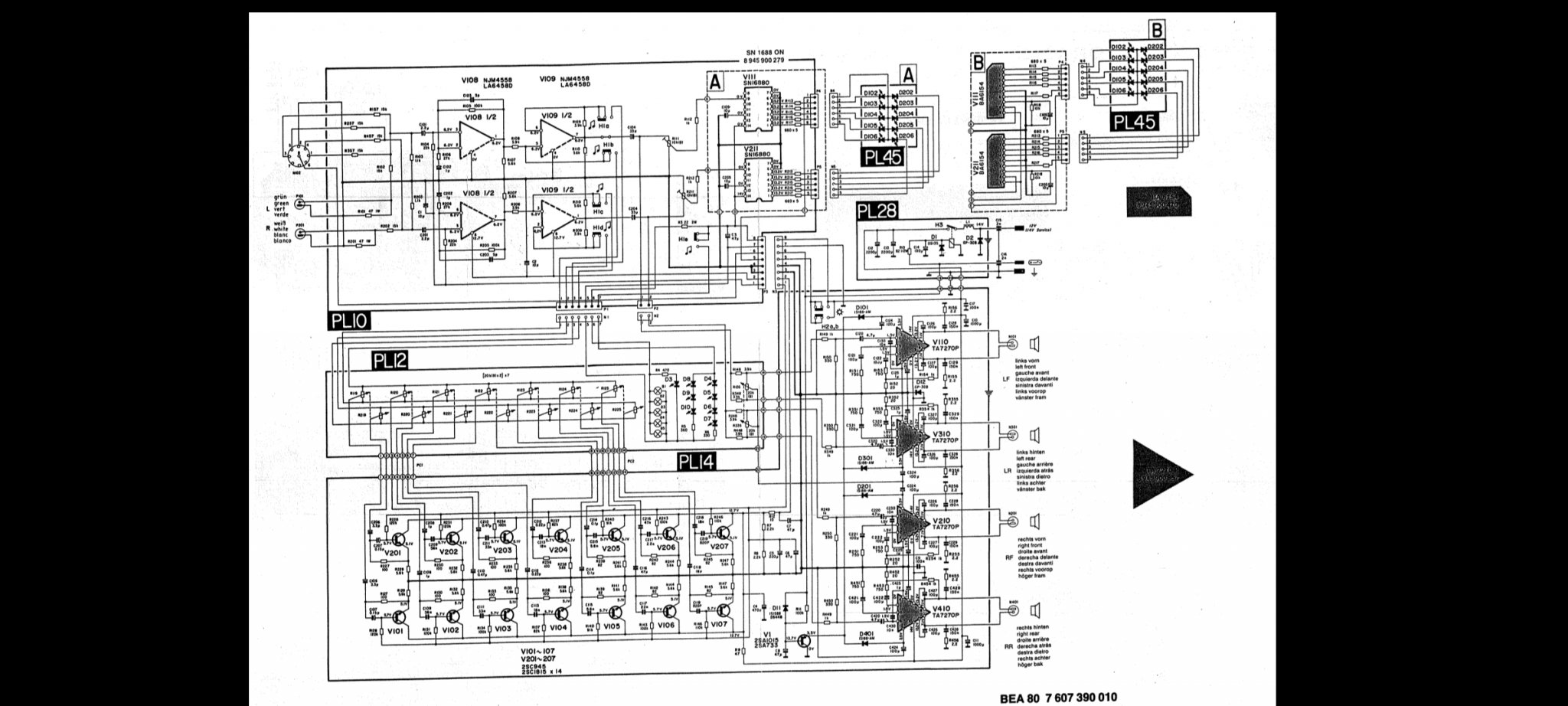

This is how some of the German manufacturers use the fader/balance markings. This is from a Blaupunkt New York SQR 05. Notice that the volume uses the same basic symbol.
Reactions: diy1995
What do you believe was modified?
There is only left/right input. The fader allows the front or rear to be shunted to ground which would make the other output front/rear to seem/become louder.
Are you going to use 4 pins on the DIN for output?
Fader is acting like a balance control, it looks like that someone swapped the inputs for the power ICs.
I'm going to use only L/R outputs, I don't need F/R separation.
So 2 outputs.

@Osvaldo de Banfield @Perry Babin
Sorry to you both, it does act like a fader.
I messed up big time and made the confusion.
I don't know what I was looking.
