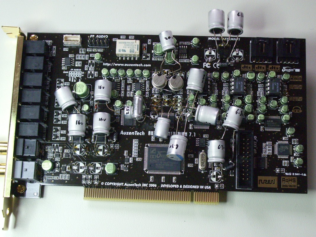

Here are mainly the PLE / PLF 820uF 16V and 820uF 6.3V on my PC soundcard. Mostly in analogue positions.
I mostly ran them for about three months, 24/7 before doing the listening tests. The comparison caps were also on there, or on another sound card, for a similar period.
It's a bit rough looking as it's a work in progress.
They are before and after analogue position regulators and one digital supply regulator. Also before the DAC chip and each side of the OpAmp.
It became clear that it needed three of the 820uF 6.3V in parallel before the DAC chip to do what was needed. Each time I added an extra one the sound became generally better, but more so in the bass.

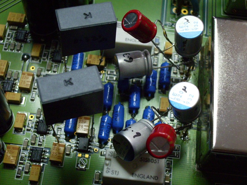

I found the same when I upgraded a Dacapo DAC last year. Three caps before the DAC. One of those though was a BG N 220uF 6.3V that I happened to have. In that case, the BG gave a needed amount of extra bass but without the muddle that it also gave on the sound card.
I fitted back diodes across the regulators to be safe.
See my post 118 for the longer description of the comparison 🙂
