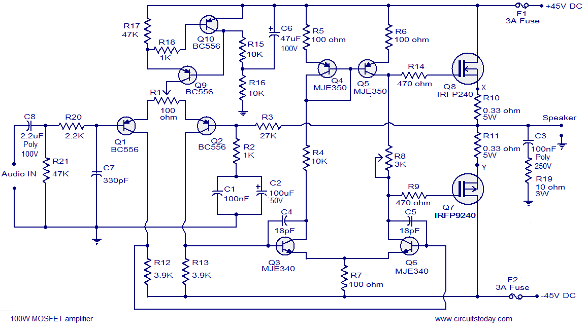

Please don't expect any bias recommendations from the CircuitsToday schematic in post 90, or its write-up elsewhere, to apply to your 2SK135 / J50 ! Despite the uncanny similarities all the way up to the output stage, an IRFP240 / 9240 output stage is a completely different animal from your lateral MOSFETS.

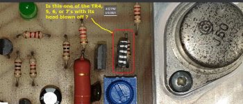

Did one of your driver transistors blow its top?

That's TR5. TR6 also looks like it's blown it's top. The other channel looks ok.
