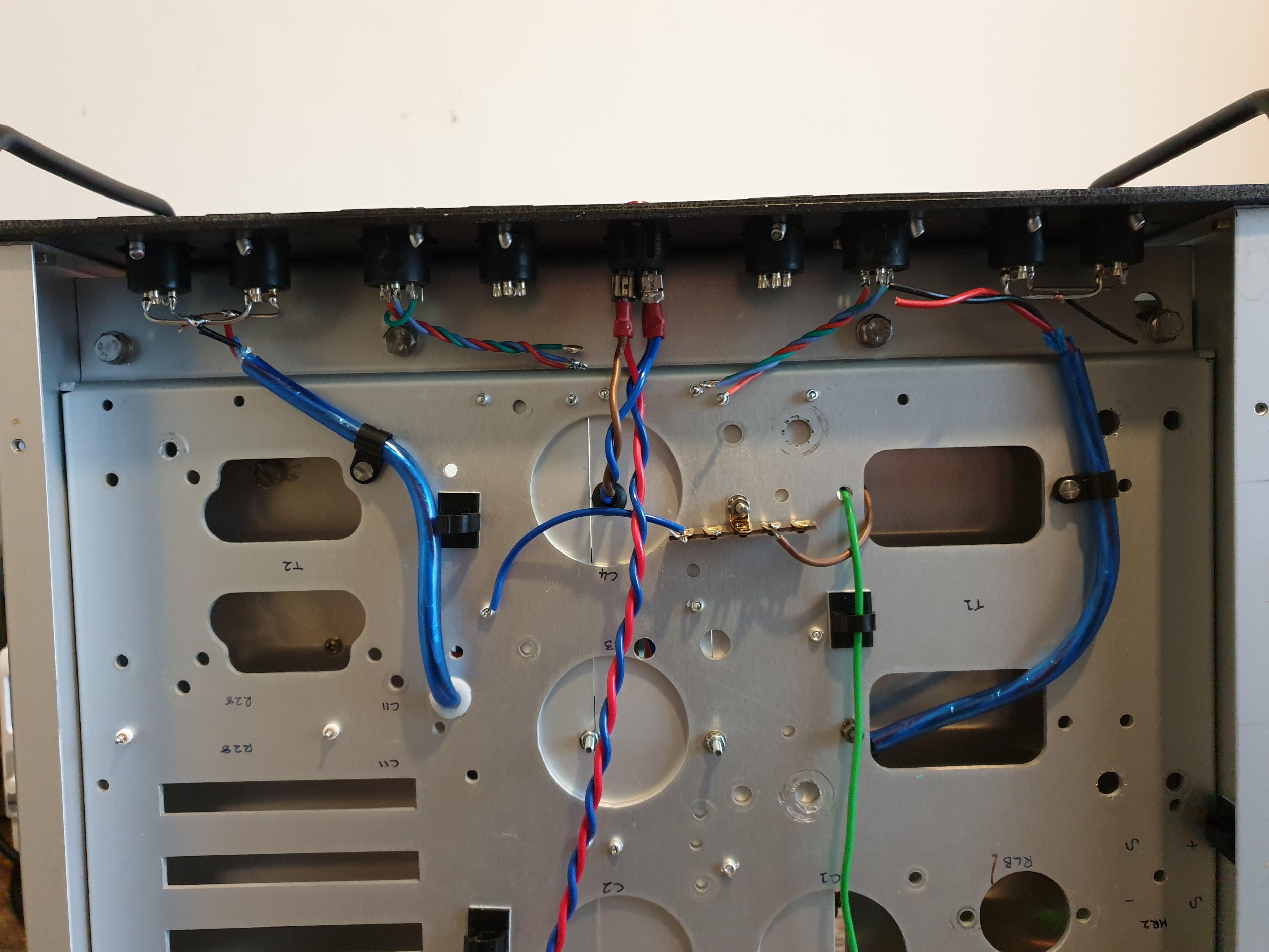

EMI thats why I twisted the cable usually helps plus I have some good quality screened cable plus they will have short runs. I think that will do the trick.
Yes there is grommet in there unfortunately adding the strips has increased the thickness of the ali to 7mm thick. So its getting a grommet with 7mm mounting gap. If it comes to it I'll just drill over a bit then it will only be 2mm thick on the strip. Be easier. Can be a ventilation hole ha ha.
One more thing bias not having any current or voltage readings for these does 45/47 volt seem about right for main rails? plus I need to measure amps so do you remove the fuses and measure across there? And if so would it be around 100mA mark? Just double checking again don't wanna short anything. There both quick blow 3.15 amp. Odd number!

You seem to believe that using micas and a ton of grease keeps transistors insulated from ground, even if they are bolted to chassis and to boot one leg is also grounded.
IT DOES NOT WORK THAT WAY.
My crystal ball tells me this project will end disastrously, hope nobody gets hurt in the process.
Have to admit, the paragraph quoted by JMFahey had me very puzzled, too -- and worried for both your health, AND that of those venerable TO-3 outputs.

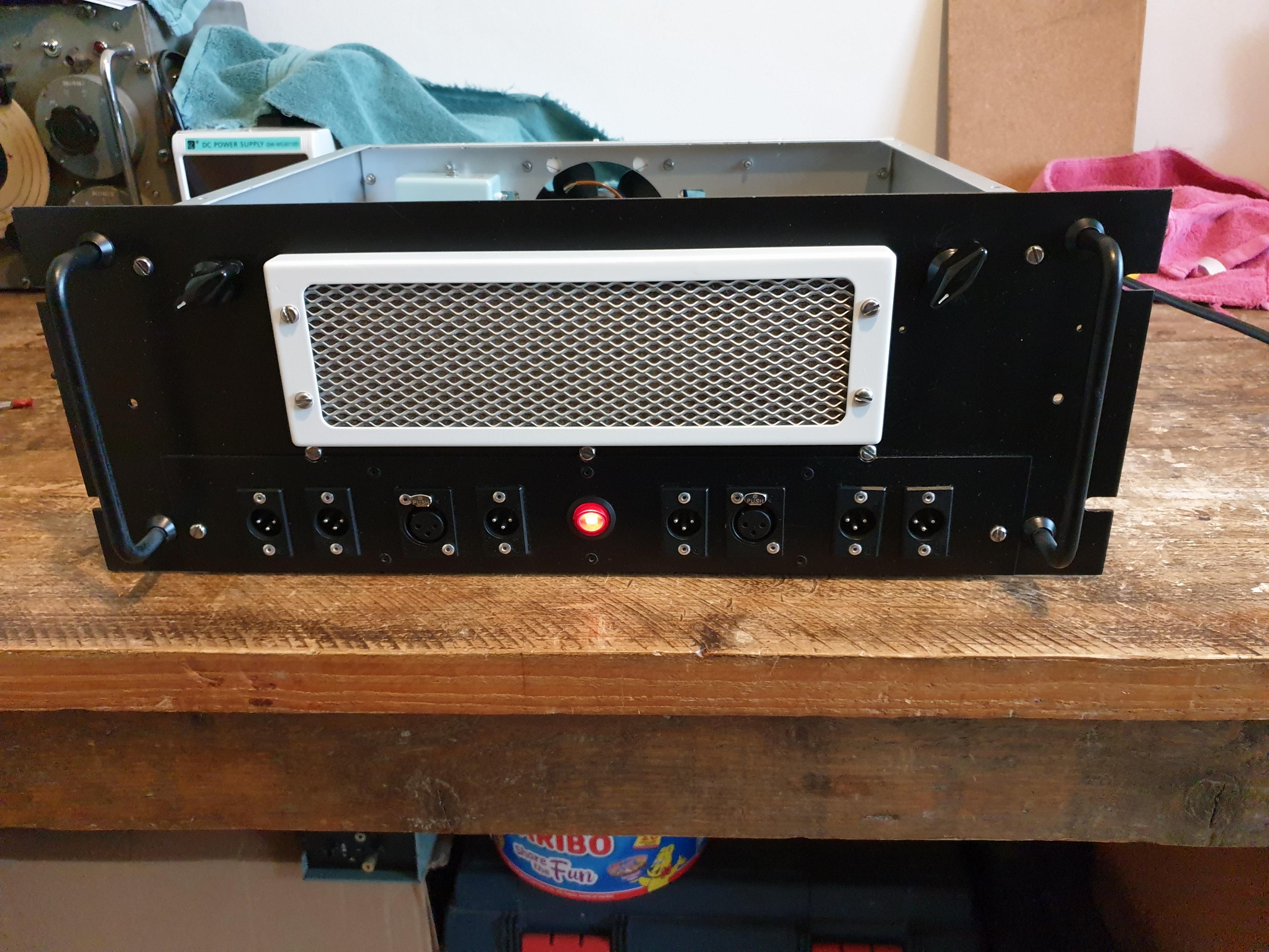

In your 2nd pic, are those the inputs in the lower left? I thought the convention was female XLRs when they're inputs.😉

Needs to brush up on his English language interpretation of wording and there meanings. In English language it's very easy to put things out of context by using snippets of information. Nothing personal just a bit of positive advice there.
Why I came on here never used those before only worked on valve gear and speakers plus valve test equipment. Had a read and look around and those T03 where directly earthed to chassis according to what I came across. Did not seem right to me hence came on here.
Anyhow digressed there. No those are the loudspeaker outputs another two the other side to go in.
The inputs think depends on balanced/unbalanced and would think you have a male and female input for those. Could be wrong!
Problem I have is holes had already been cut out on front of chassis so I'm trying to utilise those but it's not working out some holes too big or too small so I'm having to re cut holes and try to make it look tidy. Think should of run a piece of aluminium plate across the front at base filled holes with metal putty sanded and restarted. But I'll figure it out. So you will have 6 male xlr and 2 female xlr connections.
Pots will go up top and ill put aluminium plates over them.

Get these Wires shielded before anything else.
We do not want to see you getting your forums NAME BECOME True.
If using Mosfets, the HEAT-SINK needs to be grounded, to Center Ground of the Transformer or as you said Star-grounding. Mosfet are Super fast Transistors, and tend to Oscillate between the Heat-sink and them self. find the original Circuit, and check how it was actually designed.

Phono connections are unbalanced, and have been the standard on consumer gear for decades.
XLRs can provide a balanced, and much more mechanically reliable, interconnect. Pro gear is balanced exclusively, and more and more hobbyists are running a pro piece or two.
I would strongly discourage using XLRs for the output connections. There are significant technical reasons. But the sole non-technical one utterly trumps all others: Sooner or later, if the gear lives long enough, those outputs will get plugged into something they shouldn't -- and it will kill that piece.
No doubt you are absolutely certain that will never happen, but as sure as the sun comes up every morning ...

Well front panel done cut filled with abro steel putty good gear holes drilled re sprayed and connectors installed did not go as neat as wanted but not re doing all that so will have to suck eggs on that one.
Still fair bit to do.

The pots bit lost here obviously there are two terminals for that screen/earth and signal inputs tabs 1 &3⁹. Now the 2nd lug on pot is obviously for volume gain. Now do I just connect that to the output on speaker side or is there a particular way it needs to be done on these modules. It's gonna be for audio not guitar use.
I also decided not to star ground the heatsink as it was mentioned to do so. But on reading up this seems to be more related to the heatsink and components attached to chassis externally then rule of thumb is to ground it physically. Obviously grounded via chassis.

I hope/trust you still have the cases of the output devices insulated from the heatsink.😉

The work so far looks good. Love the big air filter.

The fan is pretty good thanks and at full speed is only 40db other where over the 100 mark think be bit too noisy. I have two modules for that to switch the fan on/off was gonna set temp around 75° although I've read optimum temperature is 100°c seems bit hot to me if it gets that high.

Yes all insulated on heatsinks.

Ignore my waffle about volume pot worked it out made it complicated when it was not. Occupational hazard ha.
Okay. Waffling is fine, but there should be no direct connection between the volume control and the output 😱 😕 -- we're good on that, right?
A gain control on just about anything electronic (For the moment let's ignore balanced circuitry and mixing board input attenuators.) will have two ground connections that both connect to the CCW end of the pot -- one goes to the source, one to the thing you want to control the volume of. The signal wire from the source will connect to the CW end of the pot. The wiper (center terminal) provides the signal to the thing to be controlled. In the MF100 schematic that's the joint where R1 and R2 are connected together.
Concerning temperature -- pretty sure anyone saying some certain temp is *optimum* is fooling somebody (themselves). Lower is better. Everything from power transistors to electrolytic capacitors last longer, and have fewer failures at lower temps.

edit: Umm -- the BUZ900 and 905 output transistors are actually lateral MOSFETs, not Bipolar Junction Transistors. The latter would require another probably couple stages of current gain to reach full output.

Ha ha there ya go shows not worked on these before it’s just shinning through ha ha.
Yeah all okay on pot like say thinking along lines of tone controls eq board etc just making over complicated in my head. Obviously for all that be complete re build adding in more circuitry.
Yes not sure why I put buzz as bjts already looked them up way back. Unfortunately on lot medication so brain not always on the ball as they say.
Goes to show reading info not always the right path to follow. Yes if running at low temperature gonna last longer for sure but think general consensus hotter better in relation to sound. Assume just personal preference.
