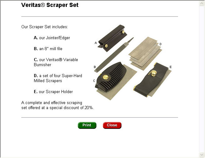

Vikash, Gcollier's recommendation of Lee Valley was a good one, since they have the stuff in sets as you asked. Have a look here:
http://www.leevalley.com/wood/page.aspx?c=1&p=32670&cat=1,310,41069

Some of the tools required for scrapers have simple subs... a steel for your kitchen knives will serve as a burnisher, as well as a round screwdriver blade.
Screwdrivers may be too soft; the standard recommendation is the back of a chisel handle.

This 4 scraper set inc burnisher seems pretty good @ £22.11: http://www.axminster.co.uk/product-Axminster-Hard-Edge-Cabinet-Scrapers-20437.htm
Is this the right type of file? (What is a b4stard file exactly?): http://www.axminster.co.uk/product-Vallorbe-Swiss-Flat-Files-22597.htm

Vikash said:Is this the right type of file? (What is a b4stard file exactly?)
Yes. I'd go for the longer one, they're easier to control. Files used to come in three grades, coarse, second cut, and finish. The b*stard file is between the coarse and second cut. My old teacher told me it was because the finer files clog too quickly on softer metals, so an intermediate file was required.
If I was to go for only one scraper, which thickness would you say is best for my current task?
I'd get both the .6 and .8, one will feel right in your hands, the other won't.

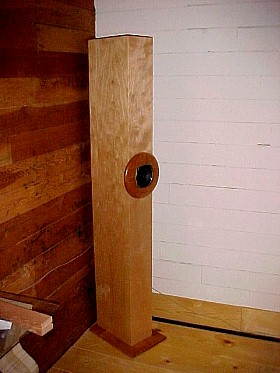

I went out and bought a scraper today. I also bought a burnisher. I was happy to walk out of the store with my $6 scraper, instead of $20 worth of sand paper for my new Frugel-Horns.
After getting home I quickly filed and got the scraper ready for use. I've read many times to burnish lightly, so I did so, but after about 1 hour of using it on and off, I decided to try burnishing it 1 more time, this time a bit harder... and voila even better. While at the hardware store I talked to them about staining and finishing wood. The staining specialist, who I've talked to many times (each employee specializes in different areas) wasn't there, but in the classes that he teaches he said that with a softer wood to use wood hardener, then stain, then polyurethane.
My Frugel-Horns are using red oak plywood. I want kind of a light finish, not too dark, so after being shown how red oak looks after the different stains and polyurethanes I decided against a stain and only to use polyurethane. A clear satin poly. I just finished applying the first coat, only sanding with the scraper, after the first coat I will lightly sand with 220grit and add more layers.
I have a couple pictures, I will show 1 of the scraper and my cut hand, thanks to the scraper that sliped when I was working on the endge of wood with only 1 hand on the scraper. Go to my website for pictures about the wood, scraper, burnisher, polyurethane, or just for fun. But not right now because I only have 2 pictures up and have to leave.
By the way, the scraper gets a little hot, but not too bad, if it starts getting hot, just stop for a second, no nead for the scraper holder, and I was also recommended putting athletic tape on my thumbs.

It works very fast! Depending on how hard I burnish it I can kinda control what grit I'm using, but it seems to dull pretty quickly. How often you you resharpen?
I'm just so suprised I've never heard of these. They are very quick. If you all have seen the Frugel-Horns the sides have a 52" radius cut out, I used string and a pen to mark the curve, but cut using a jigsaw... didn't turn out so well. So if I brace the side so that it is verticle I can scrape the side so it looks natural, it has taken a lot of work, but it is looking better. I would have to agree that using the scraper is very stress relieving in itself, not that speaker building isn't anyway, but I really enjoy it. Tomorrow I'll be working on my horns more and perhaps will learn more about scraping and how I prefer to use the scraper and how hard I need to burnish the scraper.

I scraped this piece and it looks pretty good, or atleast I think so.
Any recomendations on color?
I'd like mine to look like this, I have also cut 13 point stars for the suprabaffle.
