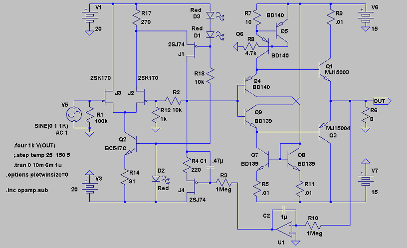

Hey gareth,
Have taken the liberty to add my driver to your "JLH/Diamante". Dumped the, in my eyes, unnecesarry Ziklai configuration.
Seems to work fine.

Regarding schematic in post #19.
This is cool. You got real JLH with Q3 doing the current steering
and top end half diamond buffering. But you flip the lower leg of
steered drive current off the bottom rail. And use complimentary
transistors.
If that was all you had achieved, I wouldn't be excited. But
you have found a way to simultaneously create a lower leg
half diamond buffer, and shunt away excess drive currents
that otherwise plague "normal" JLH in the quiescent state!
I think a small resistor or two between output emitters might
be in order to set a known quiescent??? But you would need
to open the diamond enough to accomodate an extra diode
drop. Perhaps a 0.3V Schottky in series with the emitter of
Q6 would let you add 0.33R between the bottom Sziklai pair
and the load?
On the other hand, I'm none too sure how the end result is
different from a simple diamond buffer with two CCS? Viewed
as-if both input comparators shunt away excess drive current.
Another valid way to look at the typical diamond.
Rev's #42 is interesting. Doesn't get rid of emitter voltage non-
linearites, but does assure they track both equal and opposite.
This one too needs some quiescent control? Perhaps I worry
too much when I see power transistors operating without a
well defined current limit.
Yeah kenpeter,
So right, this one will not be stable, must be reworked. After all it is just a diamond-buffer and they need quiescent control. But that must be valid to Biguns #19 too, I guess. The two are the same except for the Sziklais.

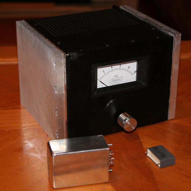

Here's a prototype chasis of the first Botch Up. There are 4 of them like this. I've obtained some nice pots from an old Yamaha Receiver, along with some nice old high performance japanese transistors. There were 4 pots, treble, bass, volume and loudness. Each black Botch Up box gets a pot.
You can see it's pretty small, heatsinks will struggle with Class A ambitions here. BUT it's a good proving ground, an R&D project to learn and play.
Unfortunately my junk box is not very deep, I've had to resort to placing an order with Digikey for capacitors at least.
In the photo you will see a couple of other things. A nice 1uf film capacitor - a pack of 20 kindly donated to my junk box by a friend. And also donated at the same time a pair of Hammond transformers.
The Voltage Amplifer will be a transformer !!!!
I have decided to stick with the Diamond output toplogy. It looks to be a very clean and desirable topology. I don't want to spoil it with an active gain stage. So I figured I should try and use a transformer for low noise low distortion gain. Yes, transformers aren't perfect, saturation at low frequencies and other nasties at high frequencies. But modern high quality audio transformers are remarkably clean over the audio range. So inspired by Susan Parker and her Zeus amplifier I hope to achieve voltage gain with the transformer and current gain with the Diamond (you see Keantoken - mythology is in here !). We'll see, it's not the ideal trafo for the job.
This will also be a ZERO (global) FEEDBACK design.

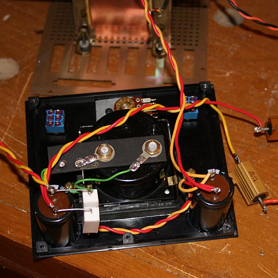

This project is starting to get on my wick. There is so little space in the chasis that several compromises are needed.
It's fine in theory to use junk box parts, but there's a reason it's called a 'junk' box.
Well, managed to find the one and only spot I can fit in a bridge rectifier, added snubbers and bolted it in place. Glued a pair of filter caps to the front panel - only space available. Wired them up in a CRC configuration and included the panel meter.
Tested it with an 80R dummy load - so far so good and not as much voltage droop from the trafo as I had expected. Perhaps that explains why the darn trafo is the 'elephant in the kitchen' using up all the chasis space.

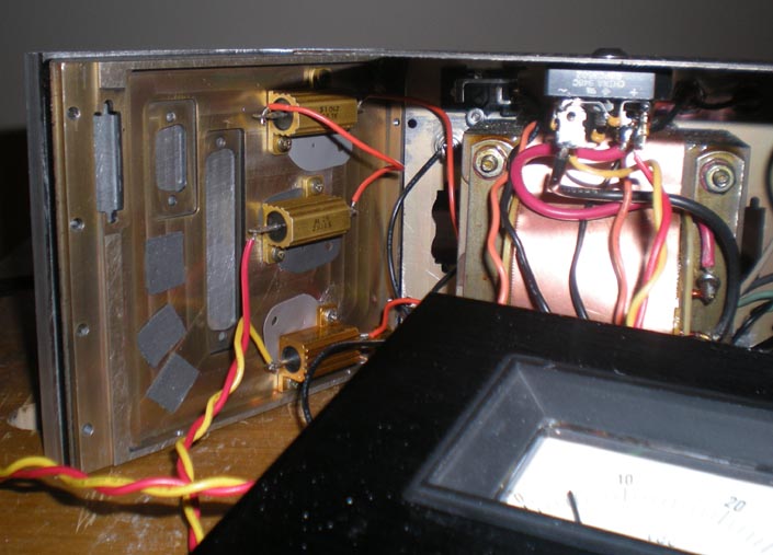

Well I have finished my simulations and designed a pcb layout and was about to start when I thought, hmmmm, I really should test out those heatsinks, they don't look too big.
I bolted some power resistors to the inside of the box and fired it up !
It got warm. It got warmer. It got even warmer. Then it got hot. Then it got hotter. Then it got even hotter. I could not keep my hands on the heatsink for the 5 second 'rule'. I reduced the current from 3/4 amp down to 1/2 amp and repeated. But it simply took a little longer before it was ready for the steak to be thrown on it.
So it ain't gonna work at the kind of bias currents that make Class A as good as it can be. I'm not willing to play with Class at small currents, I leave that for the headphone guys.
It seems that BotchUp will have to be converted to Class AB from thermal considerations, although output power is still limited by the low voltage trafo's. The alternative is to rip out those nice beefy trafo's and start over with some BFH (big heatsink) and do it right but then I may as well invest in some more power trafo's.
So it seems Botch Up has been botched up. I'm not at all surprised 😀
