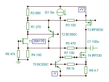

Hey gareth,
Have taken the liberty to add my driver to your "JLH/Diamante". Dumped the, in my eyes, unnecesarry Ziklai configuration.
Seems to work fine.
My gosh, that is taking liberties with a gentleman's design

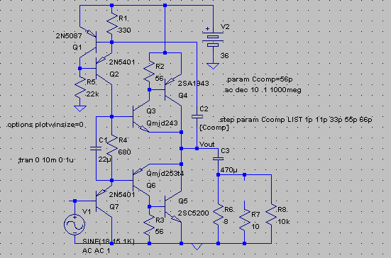

Regarding schematic in post #19.
This is cool. You got real JLH with Q3 doing the current steering
and top end half diamond buffering. But you flip the lower leg of
steered drive current off the bottom rail. And use complimentary
transistors.
If that was all you had achieved, I wouldn't be excited. But
you have found a way to simultaneously create a lower leg
half diamond buffer, and shunt away excess drive currents
that otherwise plague "normal" JLH in the quiescent state!
I think a small resistor or two between output emitters might
be in order to set a known quiescent??? But you would need
to open the diamond enough to accomodate an extra diode
drop. Perhaps a 0.3V Schottky in series with the emitter of
Q6 would let you add 0.33R between the bottom Sziklai pair
and the load?
On the other hand, I'm none too sure how the end result is
different from a simple diamond buffer with two CCS? Viewed
as-if both input comparators shunt away excess drive current.
Another valid way to look at the typical diamond.

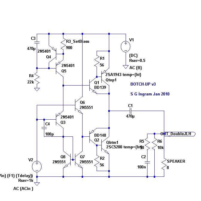

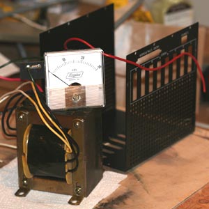

The Influence of Zeus....
Well, progress is slow, but then that's why it's a hobby...
Here's a prototype chasis of the first Botch Up. There are 4 of them like this. I've obtained some nice pots from an old Yamaha Receiver, along with some nice old high performance japanese transistors. There were 4 pots, treble, bass, volume and loudness. Each black Botch Up box gets a pot.
You can see it's pretty small, heatsinks will struggle with Class A ambitions here. BUT it's a good proving ground, an R&D project to learn and play.
Unfortunately my junk box is not very deep, I've had to resort to placing an order with Digikey for capacitors at least.
In the photo you will see a couple of other things. A nice 1uf film capacitor - a pack of 20 kindly donated to my junk box by a friend. And also donated at the same time a pair of Hammond transformers.
The Voltage Amplifer will be a transformer !!!!
I have decided to stick with the Diamond output toplogy. It looks to be a very clean and desirable topology. I don't want to spoil it with an active gain stage. So I figured I should try and use a transformer for low noise low distortion gain. Yes, transformers aren't perfect, saturation at low frequencies and other nasties at high frequencies. But modern high quality audio transformers are remarkably clean over the audio range. So inspired by Susan Parker and her Zeus amplifier I hope to achieve voltage gain with the transformer and current gain with the Diamond (you see Keantoken - mythology is in here !). We'll see, it's not the ideal trafo for the job.
This will also be a ZERO (global) FEEDBACK design.
