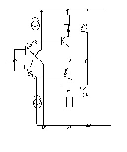

Gareth,
Nice circuit, elegant.
Only problem I see is quiescent control in the outputs; as I see it, Iq relies on Vbes of Q3/Q1 and Q6/Q2, which are temperature dependent but may still track pretty well.
You could set Iq in stone with an 'emitter' degen resistor on Q1 and Q2, but you may need to add a small resistor to the emitters of Q3 and Q6 to set the bias.
I have not done the temp param plot, so it's possible it could be OK, but it is a potential pressure point and only a breadboard would show any instability.

Hi Bigun;
may be now you can dig this one. 😉
http://wavebourn.com/forum/download.php?id=127&f=7
(My concept, drawn by Peter Ken. )

Now it looks not so strange. It looks like a very nice Sziklai Follower with an elegant method of ensuring a Class A bias point. It uses fewer transitors than my double-JLH - although no fewer PN junctions 😉
This is a good candidate for Option 4: Did you build it - how does it sound ?

You may see it as a Sziklai follower if don't pay attention to diodes in feedback, or you may see it as a complementary opamp with VAS stages loaded one on another. LTP stages are implemented by transistors (left) and diodes (right - D2, D3). Output transistors with diodes in bases (D1, D6) work as current mirrors.
Tails of LTPs intentionally use resistors so their maximal current will depend no a voltage swing. And diodes (D4, D5) with resistors in series turn the amp into AB class, without such diodes and resistors it would be class A follower.
Yes, the main advantage is, smooth clipping and self-protection against too low load impedance.
However, D2 and D3 theoretically may be replaced by transistors for classical LTP implementation, but Vbe breakdown voltages of modern transistors are below 6V so when "self-protection" starts working they would be blown.
Also, if to replace D1 and D6 by transistors you will see classical current mirrors.
Yes, I built it many times in 1980'th, to replace dead ICs in car radios. Owners were happy because they could not damage anymore their precious Japanese gear shorting out outputs. 😀
And it sounded much better than Japanese ICs.
Before that, I built such an output stage (bridged) for a guitar amp with blown output transformer. Actually, I made my first Hybrid amp back in 1982, but "Hybrid" word was not familiar then yet. It sounded very tubey. The amp was BEAG guitar head made in Hungary. The owner was happy: the sound was better, he did not need anymore to buy and swap EL34 tubes, and the head could be used with bass guitar as well (of course, no output tranny anymore!)

You are right Karlos. Probably resistors in tails still need to be adjusted depending on betas of output transistors, since as drawn ratios of current mirrors are a bit too high to forget about adjustments.

I would personally replace Q4/Q5 current source by a plain linear resistor, and added between base of Q2 and minus a PN junction with resistor in series, and one resistor in it's emitter. Such a way I would turn Q2 into a current mirror, and it's current would depend on a voltage swing.

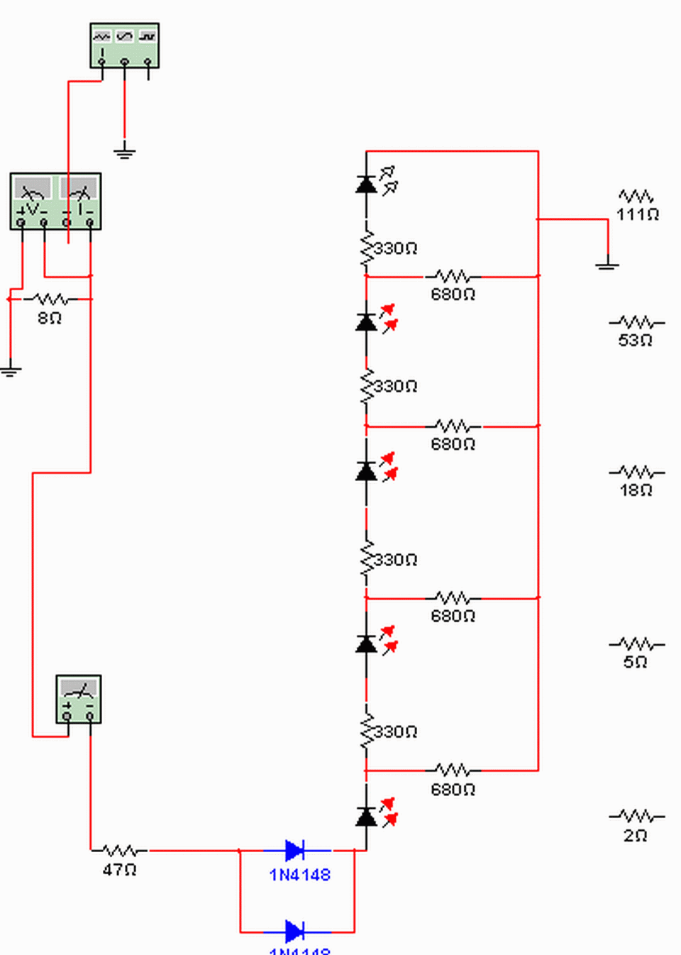

I've at least turned on the electric drill and made a cut out in the front of the first amp for the panel meter.
Meter is nice, if analogic one.
take care, do not make my mistake.
I have made a single sensitivity, my meter almost does not move with my 100 watts scale..only small movement.
Use a switch to have two ranges, one to 10 watts and other for 100 watts, well, make it adapted to your maximum power level in two ranges.
The volumes we use, the power we use, is less than 1 watt...meter almost does not move.
I am preparing a simple one, using Leds and resistances..we see how they work in real life.

It seems to me like needle movement should logarithmic, since power vs. perceived volume is not a linear function. Analog Devices has some logarithmic IC's.
Or, you could capacitively couple the 10W meter to a 100W meter's input so that it wouldn't max out if the power went over 10 watts. So the 10W needle would sort of act like a magnifier for the 100W needle, and would work at any volume.
