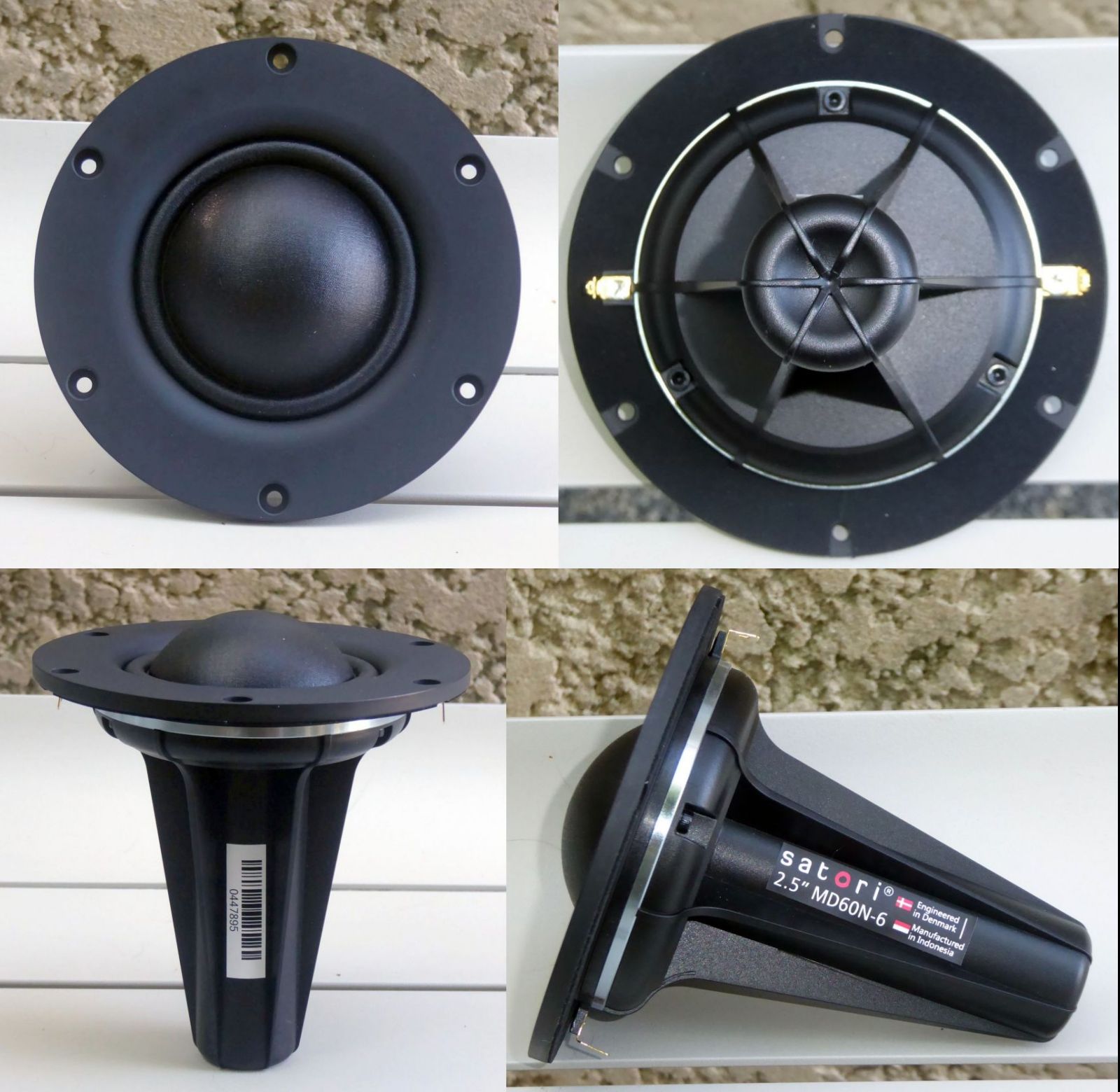

I personally prefer large midrange speakers...
T
The 4-way on the right looks a bit too complex for me.
My favorite large format mid drivers are;
JBL 2118 8 inch
JBL 2123 10 inch
They are both low excursion low Intermodulation Distortion drivers.
To match the 90 X 50 degree coverage of the JBL PT95 waveguide, the upper crossover frequency of the 2123 is about 2200Hz.
