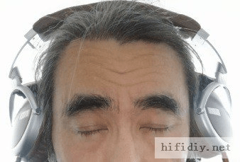

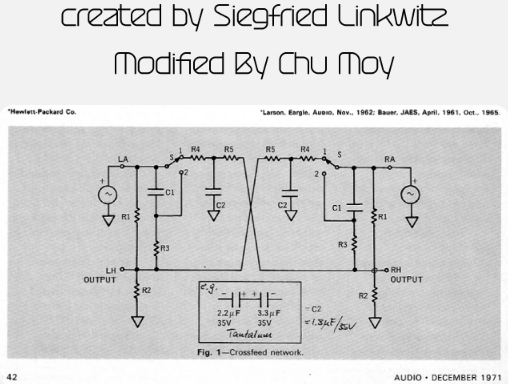

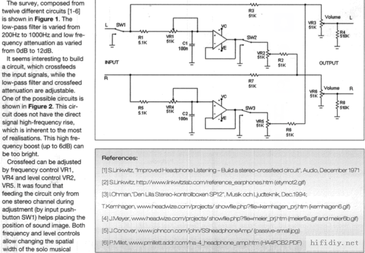

I did a bunch of experiments with crossfeed headphone stereo perception, using Chord Hugo crossfeed function, foobar2000 Meier crossfeed plug-in, and more recently a classic crossfeed circuit (Linkwitz-Chu Moy). I was able to achieve stereo sound, depth perception with singer/musicians/stage in front of me, albeit smaller and nearer than the presentation through stereo loudspeakers. The music separates/delineates more easily and sounds more natural. This effect requires:

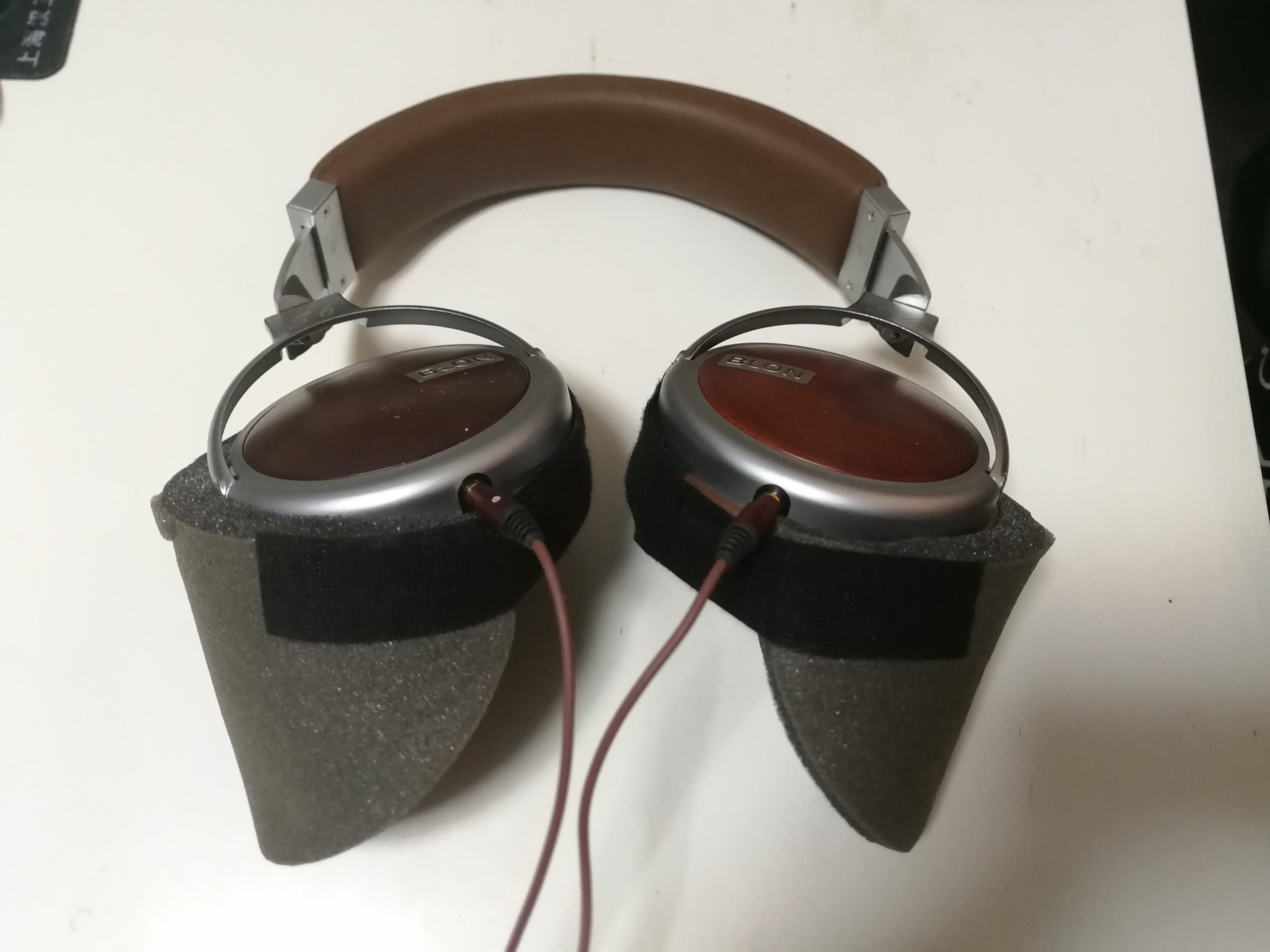

(1) twisting the headphone pads "OPEN-WING" so sound comes from FRONT-LEFT/RIGHT (and very slightly above if possible), not shooting straight into ear canal; headphones with 2-degrees-of-freedom work best

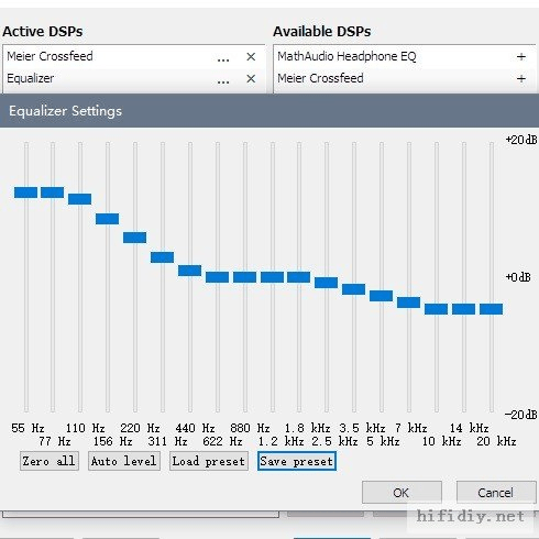

(2) EQ DOWN both trebble and bass for a realistic sense of distance, but compensate for bass-loss due to pads not being sealed (try hand-cupping ears or draping flaps over the gap as in picture)
(3) time-delayed crossfeed to opposite channel (I conjecture that additional lower bass delay would be better)

LISTEN WITH HEADPHONES "OPEN-WING" foobar2000 Meier Crossfeed set to max, EQ'ed https://www.bilibili.com/audio/am33118121?type=7

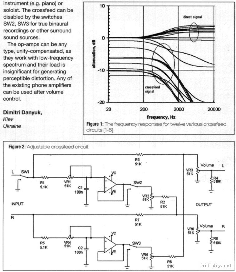

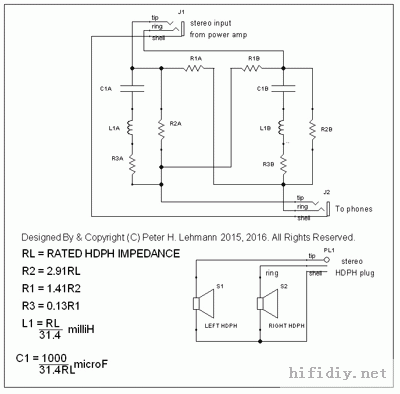

I hope there is interest in this topic. I have found a few circuit diagrams. Crossfeed miniDSP anyone?

A frequency dependent cross feed and delay do make a positive difference. But personally the image still sticks very close to the headphones unless real room reverb is used. Then the trick does work for me. I use four impulse responses and channel mixing to achieve it.

Please do try "OPEN-WING" to use the full-ear "antennae" for psychoacoustic source location, as sound enters from front/left-right in which directions our hearing is keenest.

If crossfeed had more low bass delay (reverb), I think open-wing headphone stereo sound would plain work. What circuit, analogue or digial processing would make it easy-to-use and effective? Help needed.
I have tried Open-Wing position and like it, but it isn’t practical for private listening. The main reason I wear headphones is to listen without disturbing others.

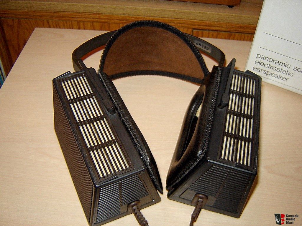

I have thought of a way to add wedge extensions to the headphone pads (split an extra pad obliquely, rotate 180 and re-glue), but looking around I saw a foam disc... so a few minutes ago I just cut it in half and made ear hoods of them. I'm sure with a bit of care they can be made "sealed". Now the phones are much easier to use but the bass boost I had made for unaltered phones has become counterproductive. Regardless, I just sampled the bilibili tracks and definitely prefer the XFEQ ones as much more natural sounding. The difference might be subtle (due partly to self-defeating excess bass) but under direct comparison it is there. Suggested tracks: Enchanted Isles #2; Yale Cellos Bach Air; Engleskyts.I have tried Open-Wing position and like it, but it isn’t practical for private listening. The main reason I wear headphones is to listen without disturbing others.
I just acquired an oldie Telefunken TH-60 whose drivers are angled. Listened to my bilibili test tracks (fb2k Meier-crossfeed, EQ), but the bass-boost to compensate for open-wing turned out very counterproductive. I'm going to use attenuator-based loudness/tone-controls (vintage Japanese circuits) instead, since every headphone's different.
