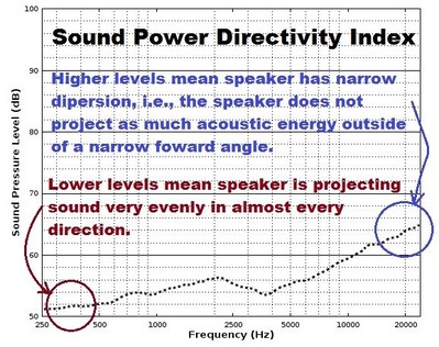

A speaker with high Directivity Index project it's sound energy in a more or less narrow beam, so it creates less side reflections. This is indeed frequency dependent and you want an even dispersion over as much of the frequency band as possible, whether it is a narrow beam or a wide beam with constant DI. With high DI speaker I meant that the sound energy is more aimed at the listening spot and close around it, maybe I am not describing well or mixing things up, I'm sorry for that... semantics and all. My speakers do not have a constant DI but are more and more beaming towards higher frequencies. In this case you get fewer reflections to the side in the treble range, but more from the back wall and surrounding walls. It works out fine for the on axis frequency as the horn start losing efficiency in the higher frequency and this beaming matches the gain from the horn in lower frequencies. But the rise in DI poses problems that I fixed with diffusion and doing so, the sweetspot widened and imaging improved. A constant DI is preferable whether it is a narrow or wide dispersion, but not always attainable depending on the horn design. I hope I made myself understandable.
(source: https://www.audioholics.com/loudspeaker-design/understanding-loudspeaker-measurements)
