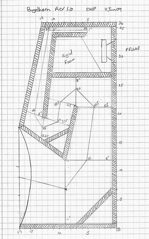

I've completed Rev 1.0 of the bugelhorn plans and it no has a mouth that exits at the floor now. It took a fair amount of massaging to make it fit into the box - the devil was in the detailed dimensions. The final simulated performance is at least as good as the previous design.
I'm attaching the box plan. now and the hornresp simulation in my next post. Please comment ,especially if you have suggestions for improvements, as I hope to start cutting wood this weekend.

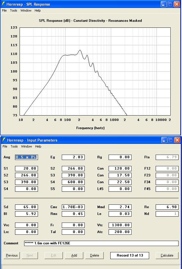

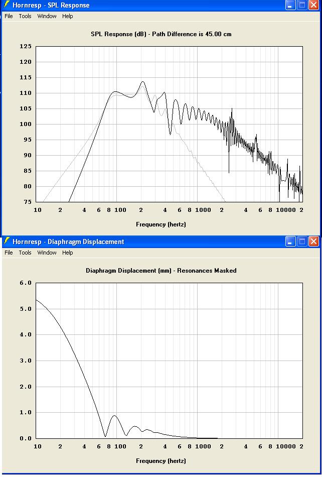

I've got several more screens from the bugelhorn1.0 hornresp simulation that I'm going to post. I'm not sure if these are good/or reasonable for this time of BLH.
The first is the combined response (at an arbitrary 45cm distance) compared against the mouth response. It seems I can make this picture look as bad as I want by putting in various distances. Am I supposed to use this screen as a guide in calculating how far from the wall(s) to place the driver, or is there another use I'm missing?
The second screen is the diaphragm displacement. This tells me I exceed max displacement with less than one watt at ~100hz (but the SPL screen posted before says I still get >100db).
Do either of these screens say anything particularly good or bad about the design? They seem pretty ytpical for simulations I've done.

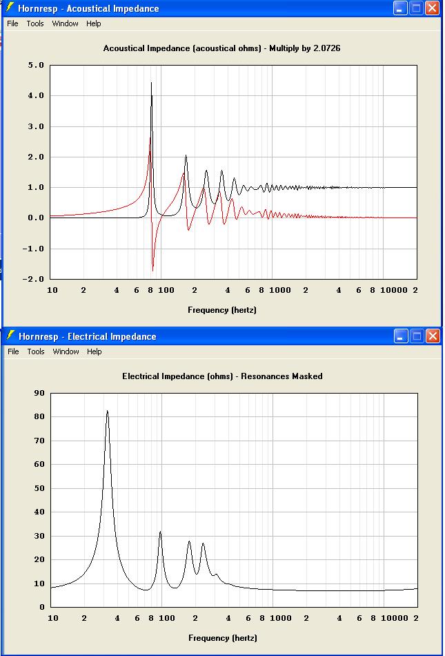

Finally, Acoustical and Electrical impedance.
I don't really understand what acoustical impedance is so I obviously don't know if the picture is good or bad - it is typical of other simms I've done.
I do understand the concept of electrical impedance but I don't know what causes the three small blips but again I've seen them nefore.
I would appreciate any onions or information anyone would like to share on what any of these picture represent and how they look in this case.

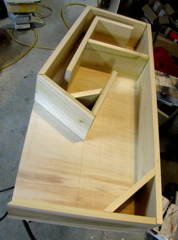

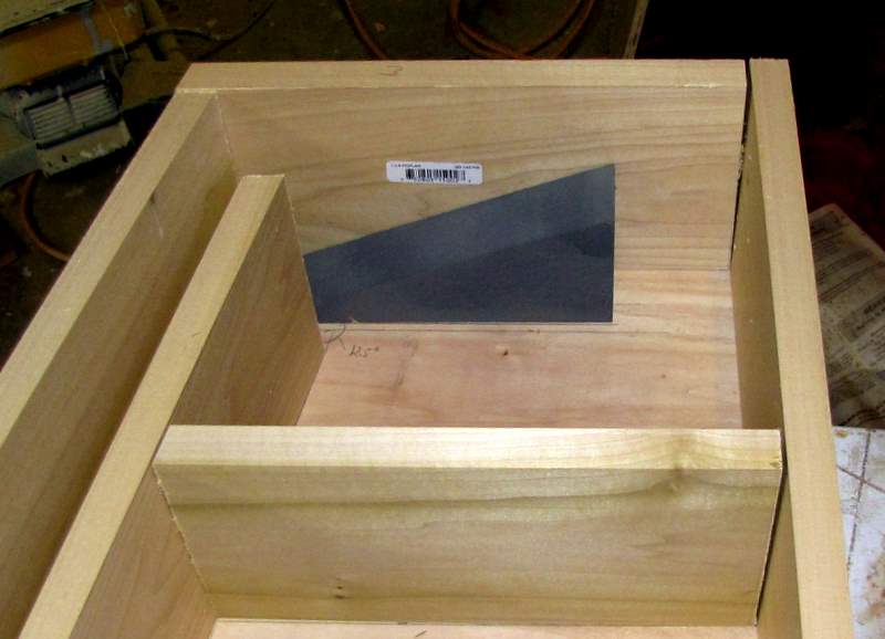

Here is a detail of the throat with one partition removed to show the wedge. The wedge is a simple triangle made of poplar (painted with primer so it shows better in the picture). The first eight inches of the throat is a constant 1.5" width. The wedge makes the expansion correct and gives a throat that is ~1.5" X 2".
The wedge is very easy to cut on a bandsaw or with a jig saw. I used 1.5" poplar because I had it on hand but a piece of 2X4 would work as well.

More construction pictures of everything glue together waiting for the top panel. I used 1 X 6 poplar boards for the partitions. Poplar is great to work with; its available at every lumber yard around here, it's always straight and knot free. It's also the right width (by design) so there is no ripping to size required. Finally, since it's solid wood, you can nail and screw into the side edges and get good holding power.
