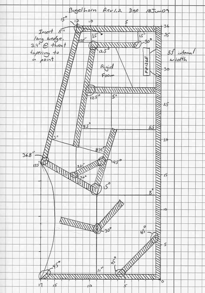

This is my first post here, and not quite knowing where to post on this one, I thought I'd share my workings on a taller alternative to the Frugel (attached pdf), and any comments would be gratefully received...(also being worked on for the FE126)....
I wanted not only to acheive more height for the driver, but also to work in a slightly longer horn (heading more towards the Austin perhaps)..I was also planning on about 140mm internal width...

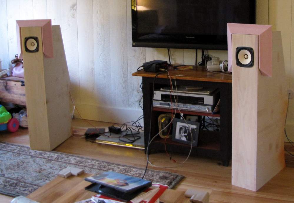

I finally have both speakers permanently buttoned up. Here is a picture of the speakers in a VERY messy room wearing the ever stylish pink My wife would shoot me if she new I was posting pictures of the room in this state! Styrofoam SupraBaffles. They sound very good with very good bass. With my bare feet on the floor I can feel the bass lines on the Beatles Love CD.

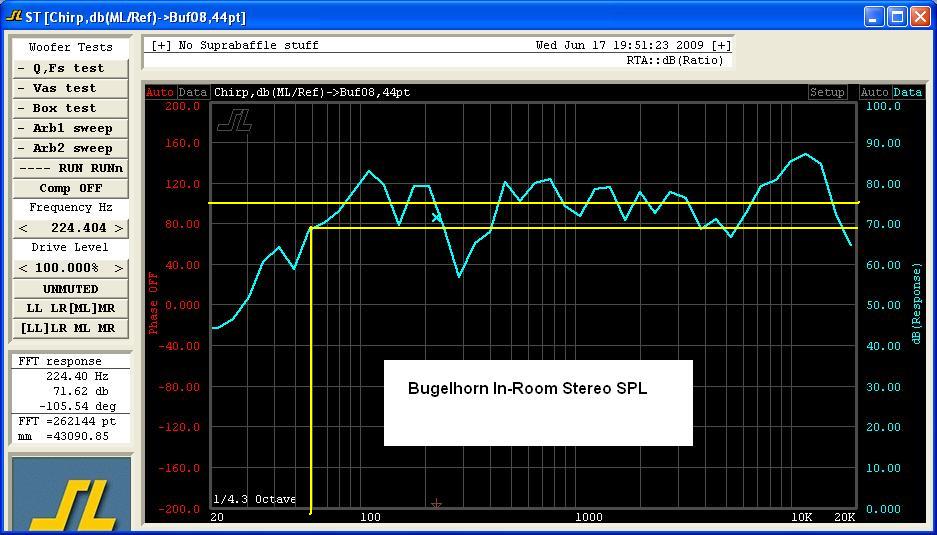

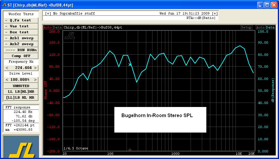

Lastly, here is the in room response as set up in the prior picture. Both speakers driven with the Mic about 8 feet away. The Mike is slightly off axis which I think explains the tamed high end rise. Subjectively, it sounds like the plot looks; pretty well balanced with good low extension (~45-50hz).

At the risk of sounding overly defensive of my "baby"...
Charcoal - I think you're understating the low end performance to try to prove your point. I've attached the in-room response and drawn a line at roughly the average SPL and another about 3db down. Based on that, the speaker gets down to a solid 60 hz, not 80-100. Back at post 61, I posted a hornresp graph of max output that shows it will play 60hz at ~100db.
