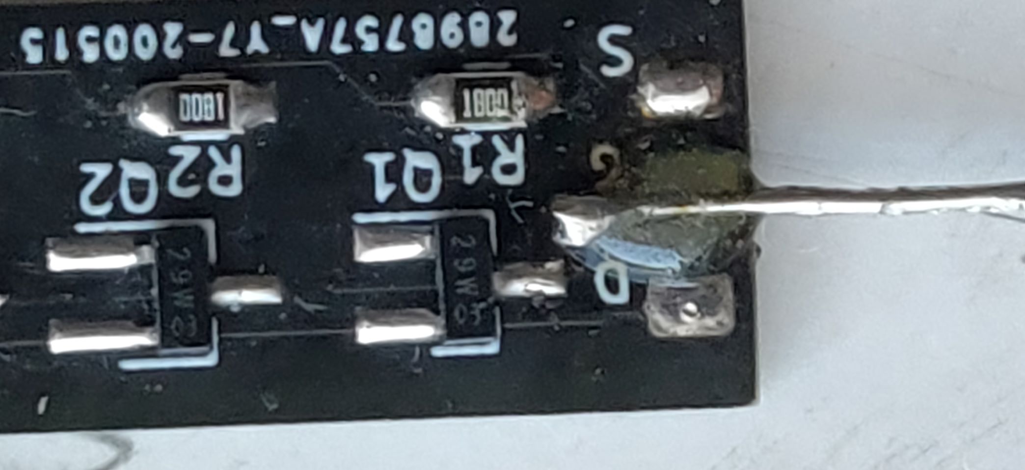

Damn, now I've got a question. Do you mean there are different multifet boards? If so, how can I tell which boards I have? They're boards you sent me in November to replace the one I managed to bork.
Incidentally, I managed to solder a line to the remains of the pad. It flapped around a bit, so I secured it with some Araldite. It appears I managed to get the electrical connection OK and measures the same resistances as the unbroken one.
But I've not had the courage to actually try it...
No, they are the original ones.
330k is fine.
