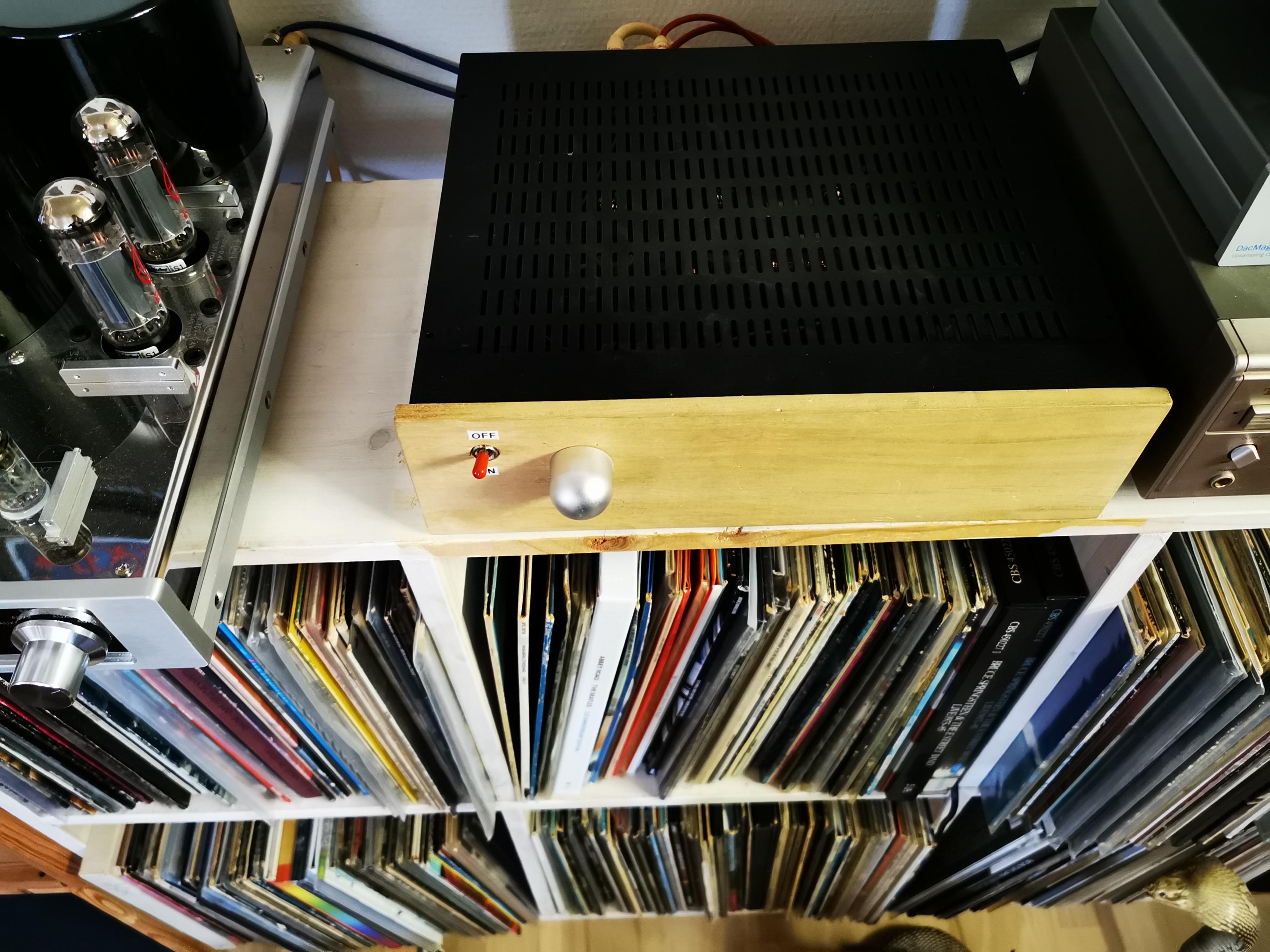

I follow the comments on my question. I am using the red LEDs as said in the bom - and they stay. I am not going to change anything because it is the best I have ever heard on my stereo.I haven't measured anything because I know that changing tubes change the amp again. I got a brand new record collection - all dressed nicely in 3D. Anything that could change is a new enclosure - sometimes in the future

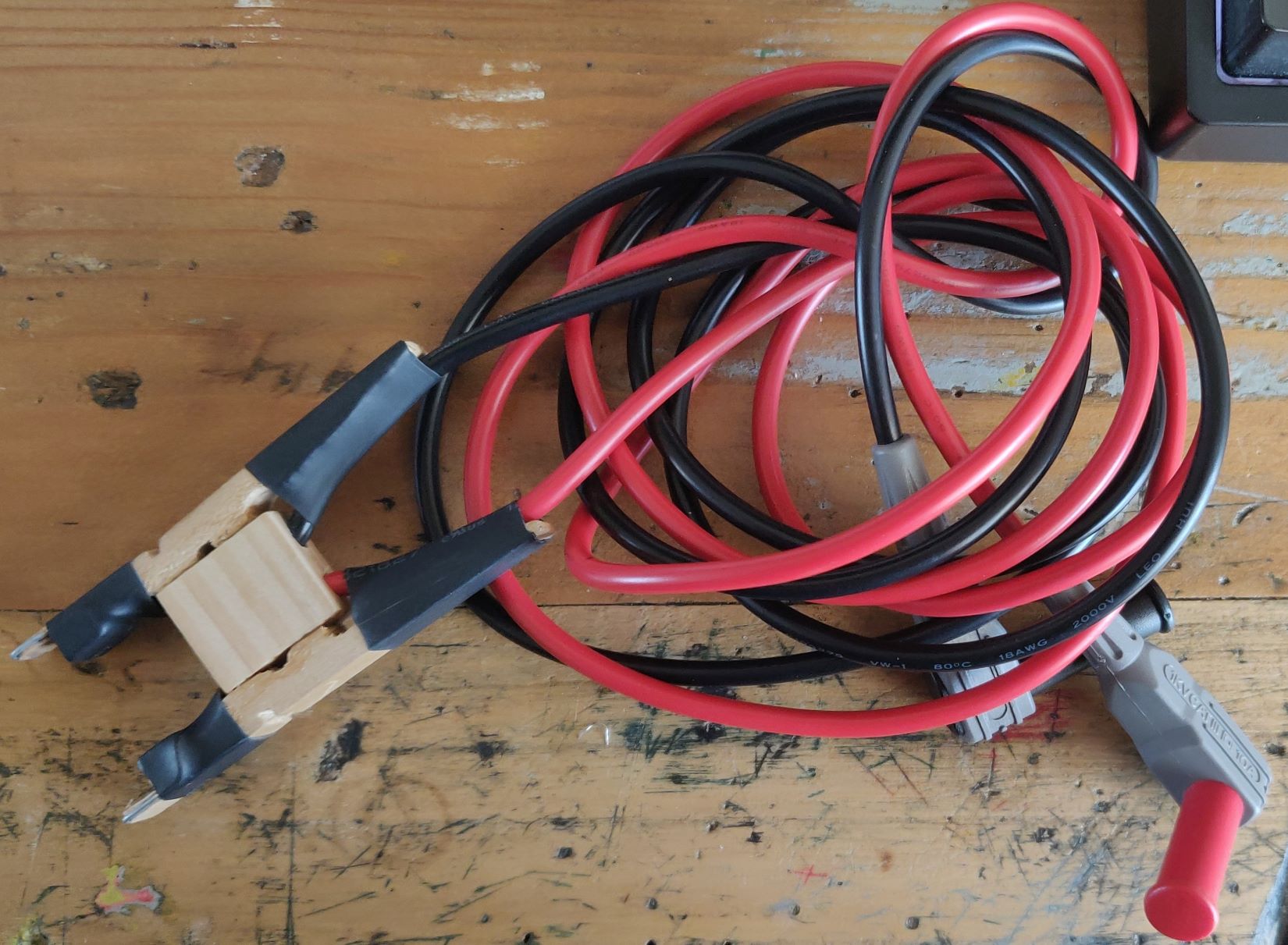

BTW, I got fed up binning resistors so I made Bin MasterTM
