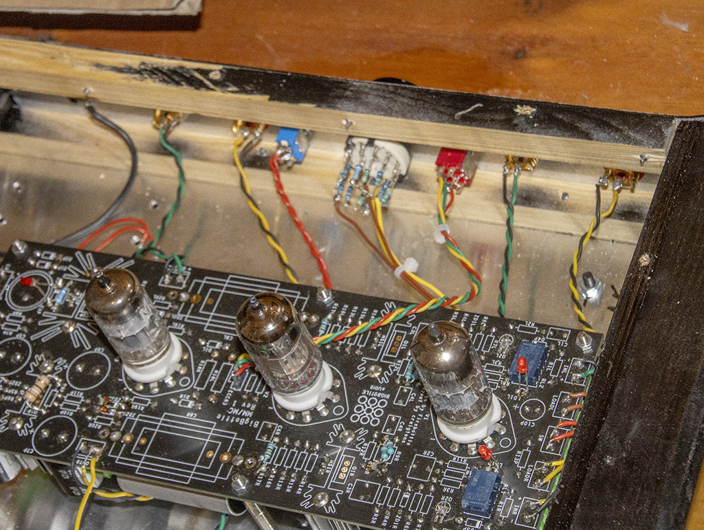

Here are my data:
AC out from trafo 260v AC
C4 342v
C4 323v
C7 323v
C8 284v
Is This so high that I ought to change trafo??
Before I removed the transformer I made a switch beween Ecc83 and 6n2 filament,working fine.
attachment.php
