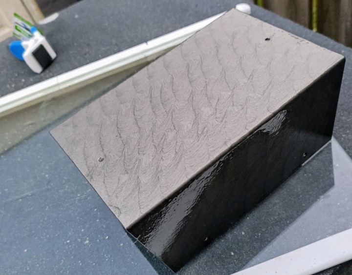

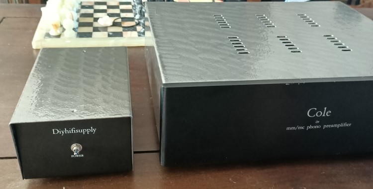

Gave my donor chassis a cosmetic update. This is where I'll be putting the Bigbottle Phonostage in. When just painting...the inconsistency from one part to the other was unbearable..could not get it looking good. Because of the hammerite-isch qualities...So it would have dark streaks from the brush. Then I thought...what if. I'm quite happy with the result. Pity about the chips in the frontpanel...not sure there is a fix. Perhaps a black marker...
Looks fine to me!Gave my donor chassis a cosmetic update. This is where I'll be putting the Bigbottle Phonostage in. When just painting...the inconsistency from one part to the other was unbearable..could not get it looking good. Because of the hammerite-isch qualities...So it would have dark streaks from the brush. Then I thought...what if. I'm quite happy with the result. Pity about the chips in the frontpanel...not sure there is a fix. Perhaps a black marker...
How ot sounds is all that matters [emoji6]

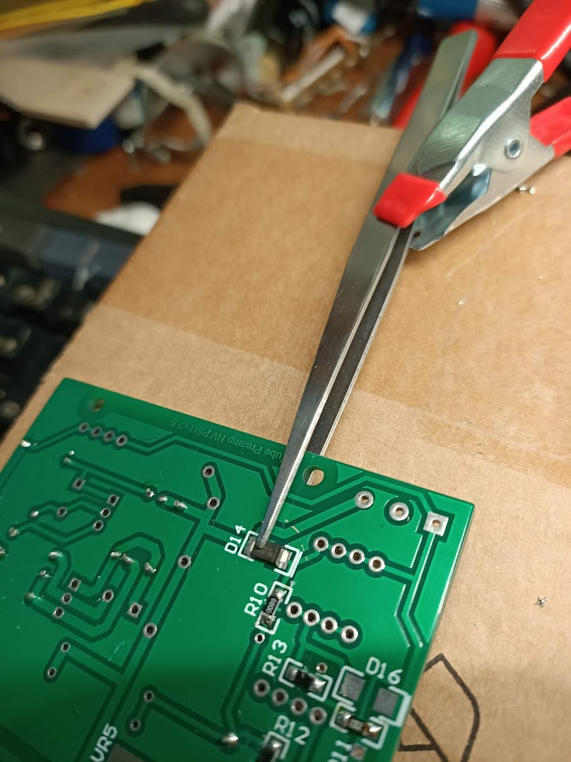

861c - so small
How on earth is it possible to solder on this tiny baby.?
Is there a secret or special technic?
I use reading glasses of 3 times magnification. And to be able to work at higher than table level, I use a box on which I work. Then I use a tweezer with a clamp. And patience. And a soldering iron with a small tip and thin solder wire.
