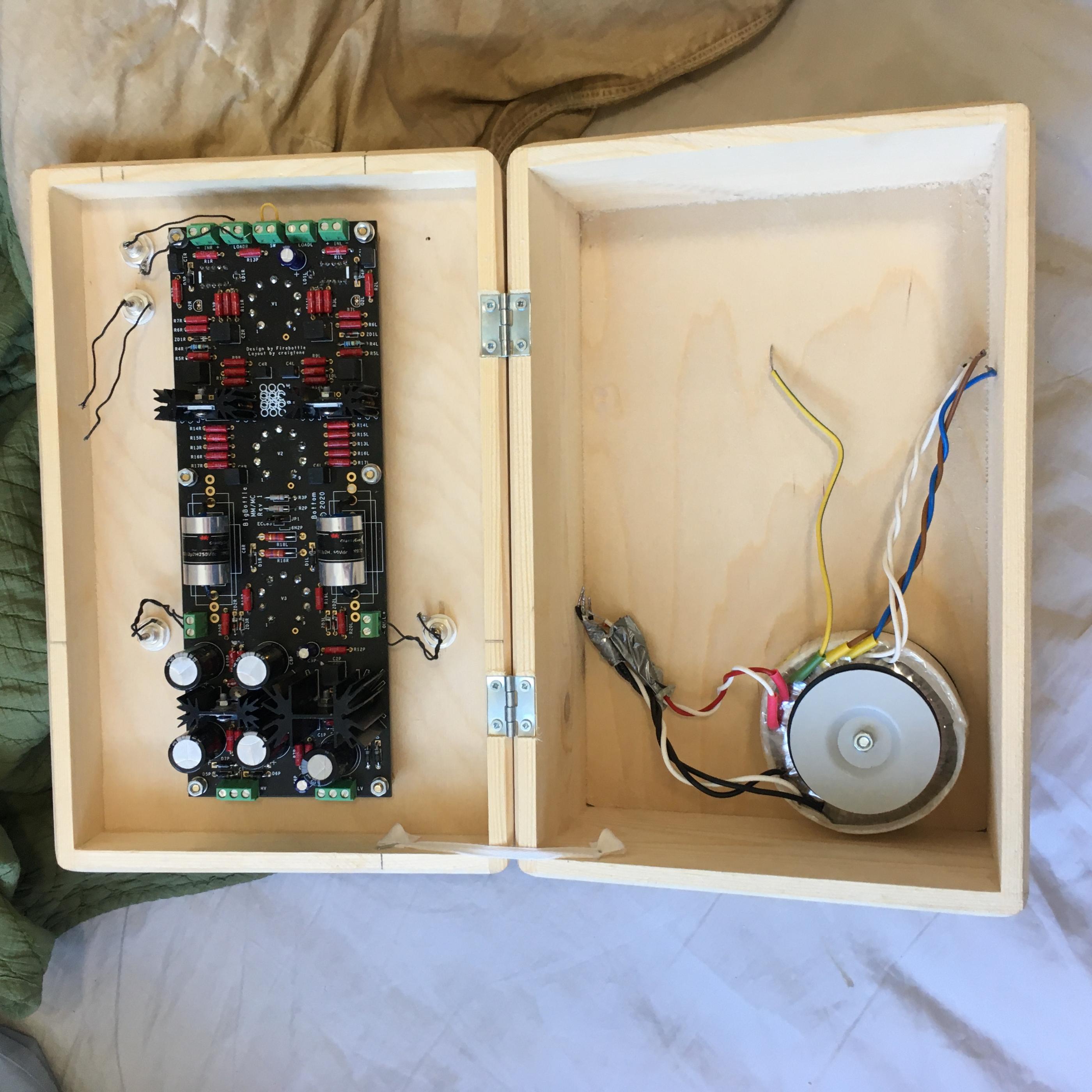

What resistors have you used? They look fantastic against the black background...View attachment 846764
Bought a £10 box from ebay. Need to wire up
Transformer and im good to go.
Might paint or add veneer or other embellishments.
And some transformer shielding.
PS, you're making a really nice quality build there, so chuck those terminal blocks away on the signal connections and solder them straight into the PCB.
Makes a difference.
Love the box idea BTW

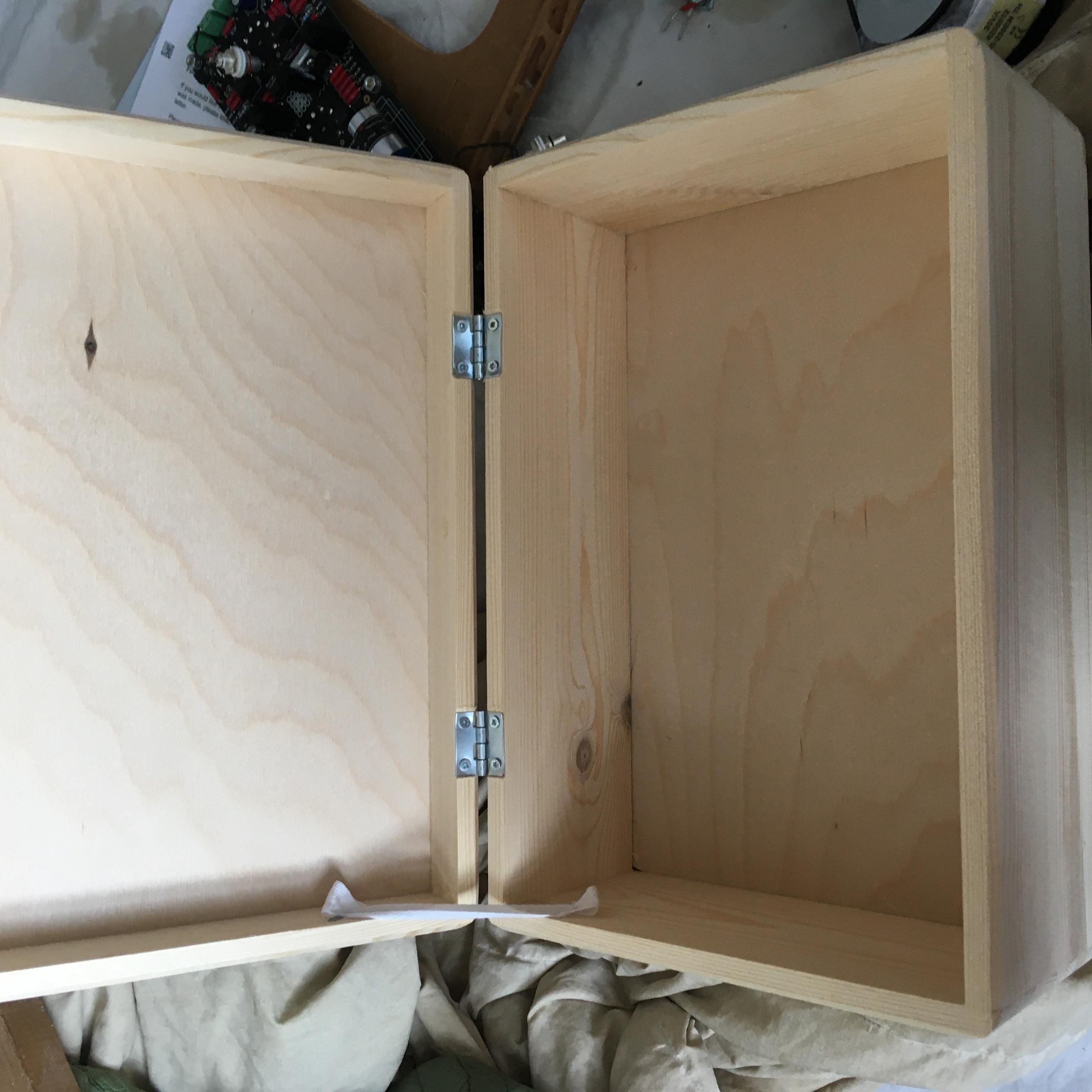

Stanney, nice job. You are going to need ventilation in the box, otherwise everything will cook inside it.
The resistors look like PRPs, no?
Yes, i did think that initially but they also look quite large?
I think you are right....look cool anyway

Yes. The very same ones. PRP from hifi collective.
And i do use them because they are red as it really brings something to the design.
They also work well.
Thanks oliver. I usually make my own. Lockdown made it harder and had a brain wave.
Box is well made for the price.
It can always be improved with brass fittings
Ill solder the leads in.

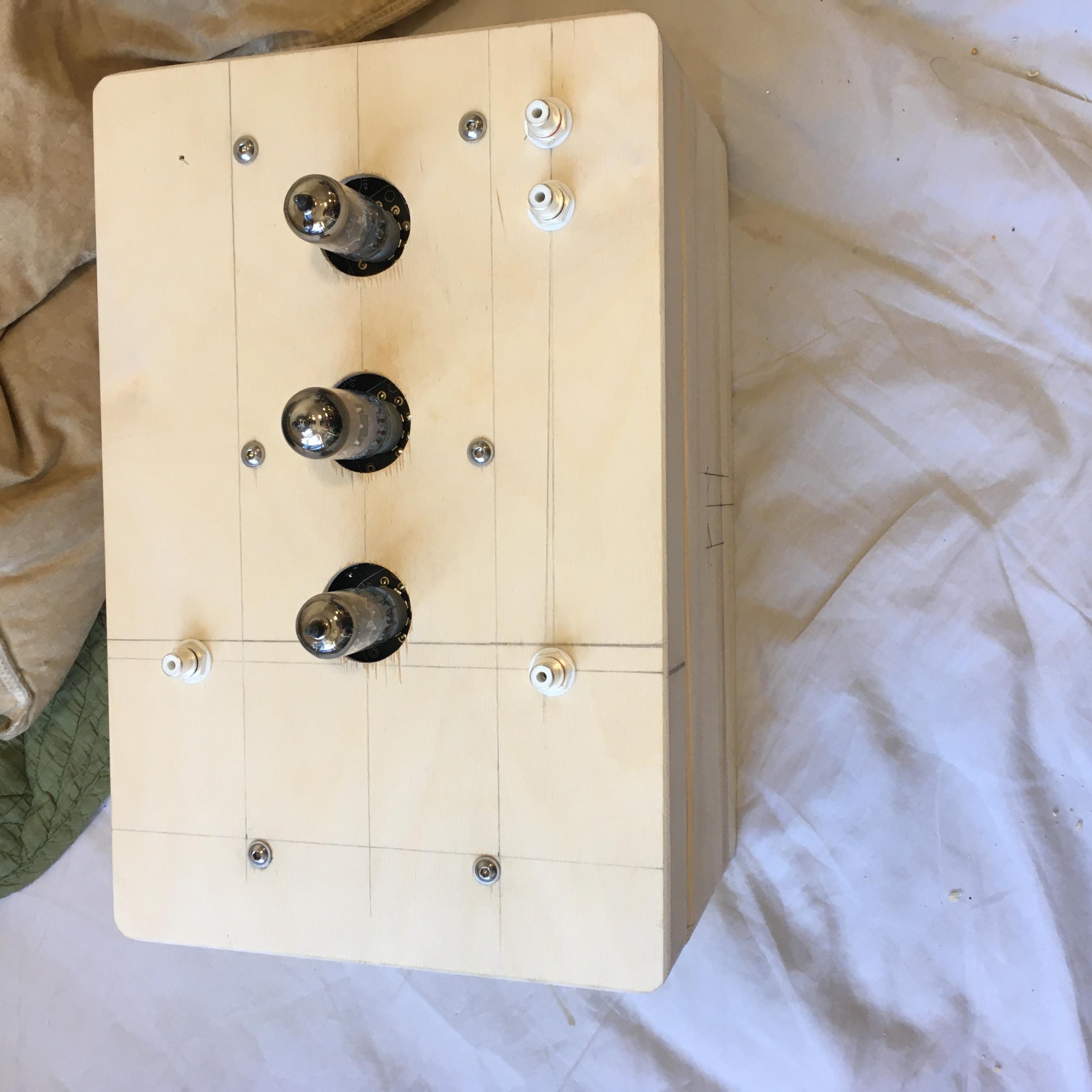

A few pics of mine so far...
Case:
External transformer and MC loading plugs
Base drilled for ventilation:
Case:
