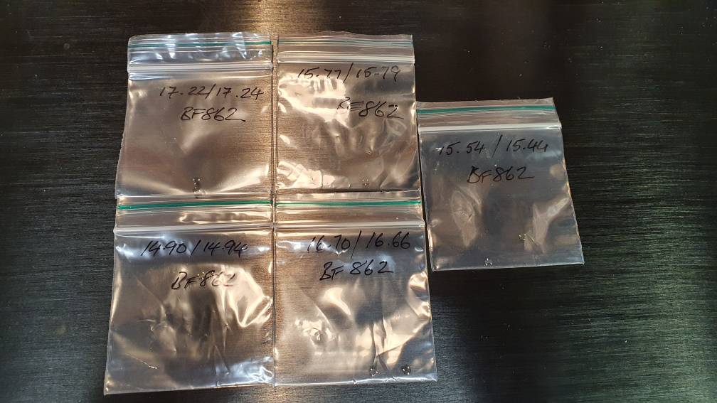

Gonna have to pull these from sale after receiving a report of a noisy Fet.Just in case anyone is interested, I'm selling off some very closely matched BF862, Whichbwere ordered from Farnel a few years ago when this project started.
£10 a pair, delivered in the UK
I have had them a long time so best to leave them here.
Would you deliver to Denmark ??
