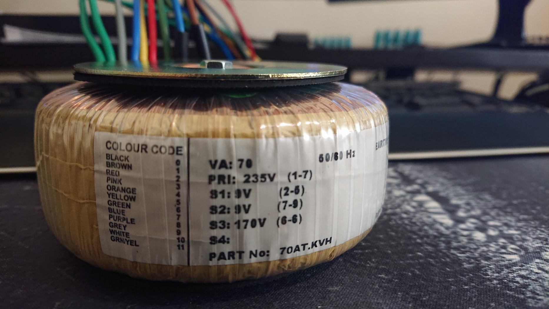

Hi everyone,
I was lucky enough to receive my toroidal transformer today. Exactly what I ordered - 70 VA wound onto 100 VA core, with electrostatic shield between primary and secondary windings. Not potted, but won't be necessary as I will be putting it into its own housing, so that I can use it for any of the BB boards I will have eventually.
However I still don't have the latest PCB unfortunately - our wonderful enlightened government is running the place reminiscent of the old East Germany currently. Telling us when we may exercise (6am to 9am, what we may and may not buy (no alcohol or cigarettes may be sold, all restaurants are closed to sit-down customers though they may deliver phone-in orders), not allowing e-commerce to deliver if it is not an essential item (though electronic games, consoles are allowed) meaning I can not even order stand-offs for my PCBs much less components etc. Also a curfew from 9pm to 5am. No receiving or sending of international parcels are allowed if it is not an essential item. Major frustration.
But hey, I have enough other stuff to keep me busy in the interim. Here's a picture of the trafo.
Kevin

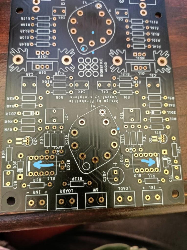

One says top, one says bottom
For exposed valves, populate the bottom.
For enclosed valves, everything goes on top
Are the relays wotking on both sides of pcb (pos,negative)
Or should they be on top,I guess it doesnt matter as the tube holder is higher than relays.
Relays on top too I believe.

Regarding the relays...So the wires go where the white stripes are?If you wanted you could omit the relays, just have to link two holes on each side.
I can't find R4P and C3P in the BOM nor on the PCB.For MM only you can omit the fets, Q2L &R, plus R7L &R, R8L &R, R4P and C3P.

Ok so relays on top it is.

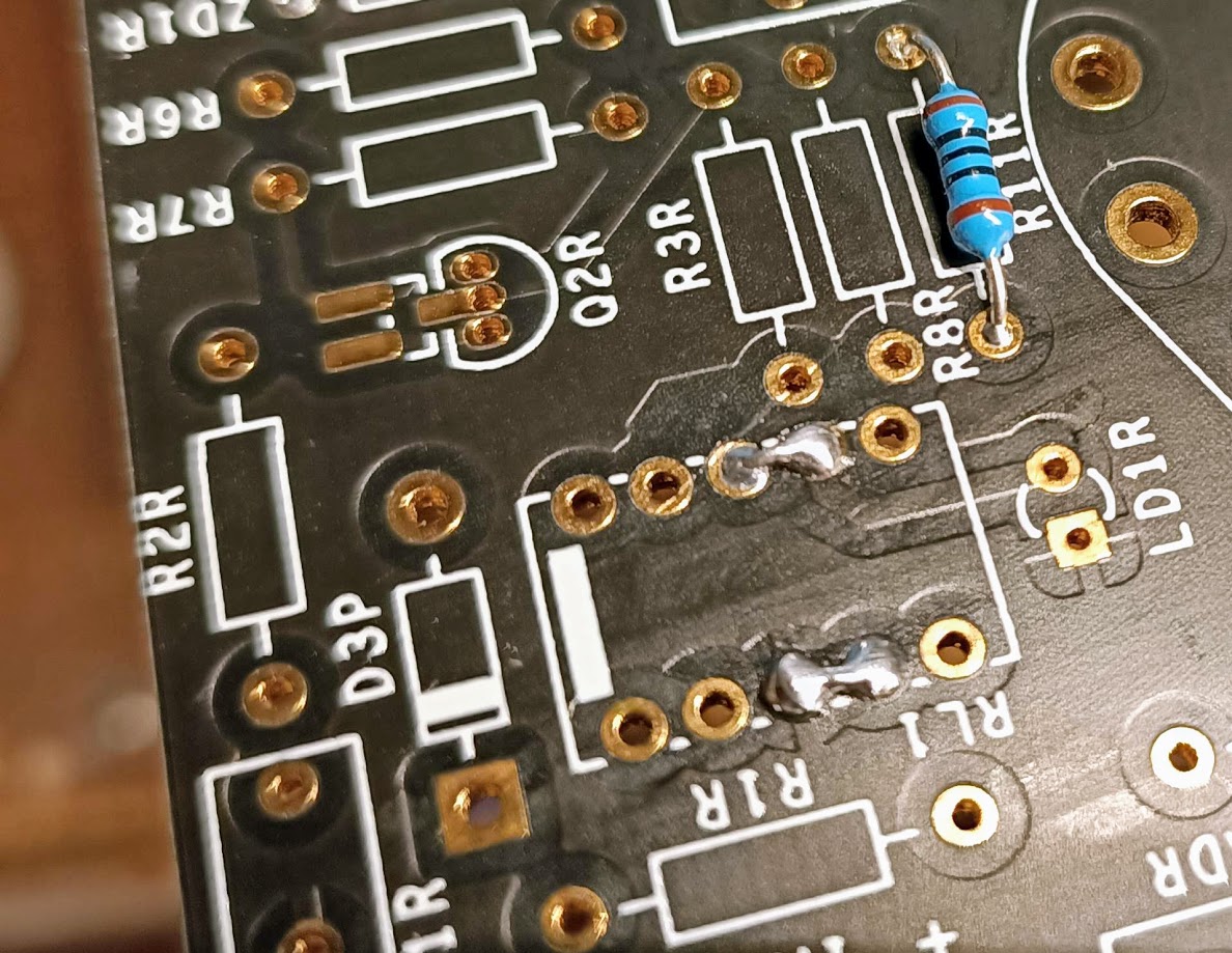

You passed the test!
Seriously though, apologies as my annotated schematic hadn't 'quite' caught up with the Mk3.
They are R13P and C10P.
For the links count the stripe hole as 1, then link holes 3 and 4 on each side.
O O O-O O
1
O O O-O O

Like this?For the links count the stripe hole as 1, then link holes 3 and 4 on each side.
O O O-O O
1
O O O-O O
Also you'll note that I used a 1/4 Watt resistor. Is there any reason 1/2 Watt resistors are specified?
Yes that's it.
