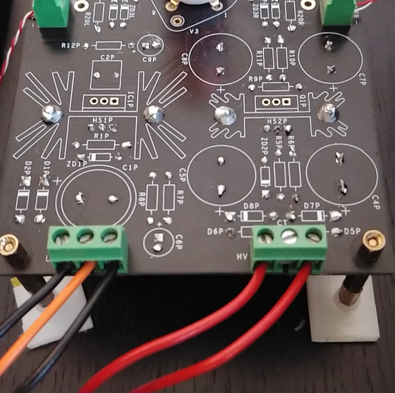

Seems like drain sits too low , I'm at work today so having just a quick look at it , you need higher DS voltage to be in linear part of characteristic , not sure how much play is there with load - you might need to ask Alan , I'd also recalculate gain and have a look at input capacitance.
I have just measured across the same point you requested recently, @slav
Here's what I got. Multimeter set to 20vDC:
Source: L - 1.72v R - 1.72v
Drain: L - 0.36v R - 0.36v
Multimeter set to 200v DC
R6: L - 107v 82v R - 107v 82v
It seems you draw around 7.5mA through the valve , what's the designed working point ?
At what Idss did you match them , must be quite high close to 20mA
Have you connected the secondary winding to the outer two connections?
Sounds like you might have half wave rectification.
Yes, measured both of them, 9.6-7 volts.
In that photo a number of the solder joints look "cold" and/or starved to me.
For instance:
D6P
HS2P (middle)
HS1P (right)
R6P (bottom)
C4P
Maybe these are good from the other side. I'm just seeing what I can see. Worth checking?
Will resolder later, thanks for pointing out. I did add more solder later in several places, just to be sure, so looks of it might be deceiving.
