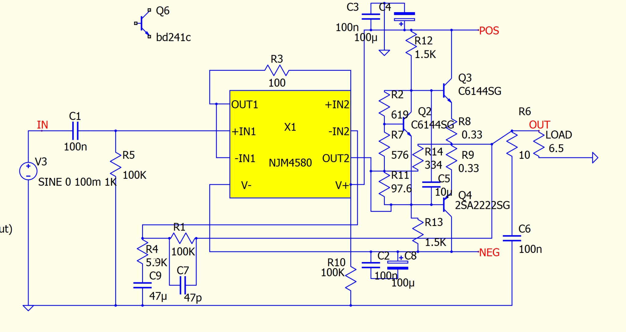

I used the suggested circuit but I'm connecting the op-amp to the wrong place - I know this because changing resistor values makes no difference! Or perhaps a Vbe doesn't belong in the design.Determine the current through the transistor, eg 10mA.

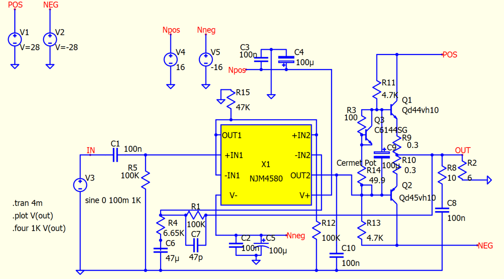

Here is my result with help of previous replies and more reading on the subject.
I've tested the attached which I've run in Spice sim reading Ib at 430mV and quiescent current at 20mA with 49Ohms dialed in to a virtual pot. Would a 500Ohm cermet pot be a suitable choice? My solution looks rather simple - comments welcome.
Cheers
Cheers

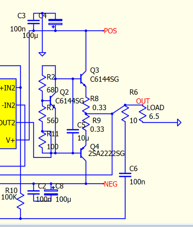

Interesting exercise.
With R3 @ 1K, R14 @ 549 Quiescent current is 660mA; placing these in reverse order then Quiescent current becomes 25mA.
This is unexpected. The VBe multiplier reads 430mV at collector and emitter and 120 to base. Does this sound right? Might I need a different part for Q3?
502mV results in a Re 120mV, Quiescent current 125mA. I read that 25mV is a good target, am I correct? I'll concluded that a Vbe multiplier is not suitable.Base - emitter at lowest should be 0,5v .

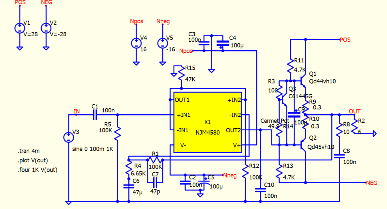

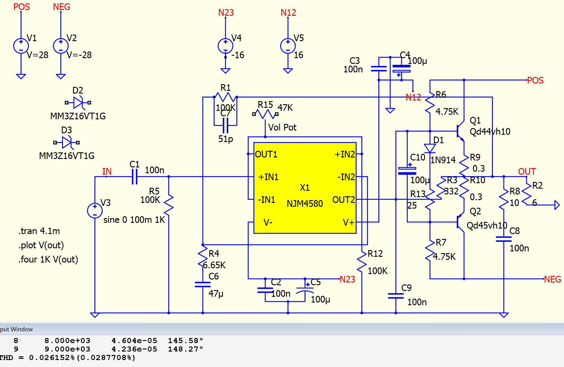

I did simulate in QSpice biasing with diode and pot. Curiously, I get the best result with just one diode! Could I be on the wrong path?
Q current is 25mA and load over the diode is 5mA. R13 will be a cermet pot. Thanks for the previous help.
Important is quiescent current itself on output emitter resistors,not a millivolts, whose can be suggested for different schematic with different transistors and different value resistors. Sometimes increasing idle current makes very small improvement, so 25ma is a good starting point.
Resistor in series with diode is used , but i think this is not optimal, because voltage on resistor is more current dependent, than on a diode. Better try differentl diode type.
In simulation diode forward voltage may differ from real diode, also it's not identical in all diodes of same type. If simulation shows a requirement of resistor, try another type diode, with higher forward voltage. As example higher voltage ones. Or maybe two schottky in series like 1n5818.

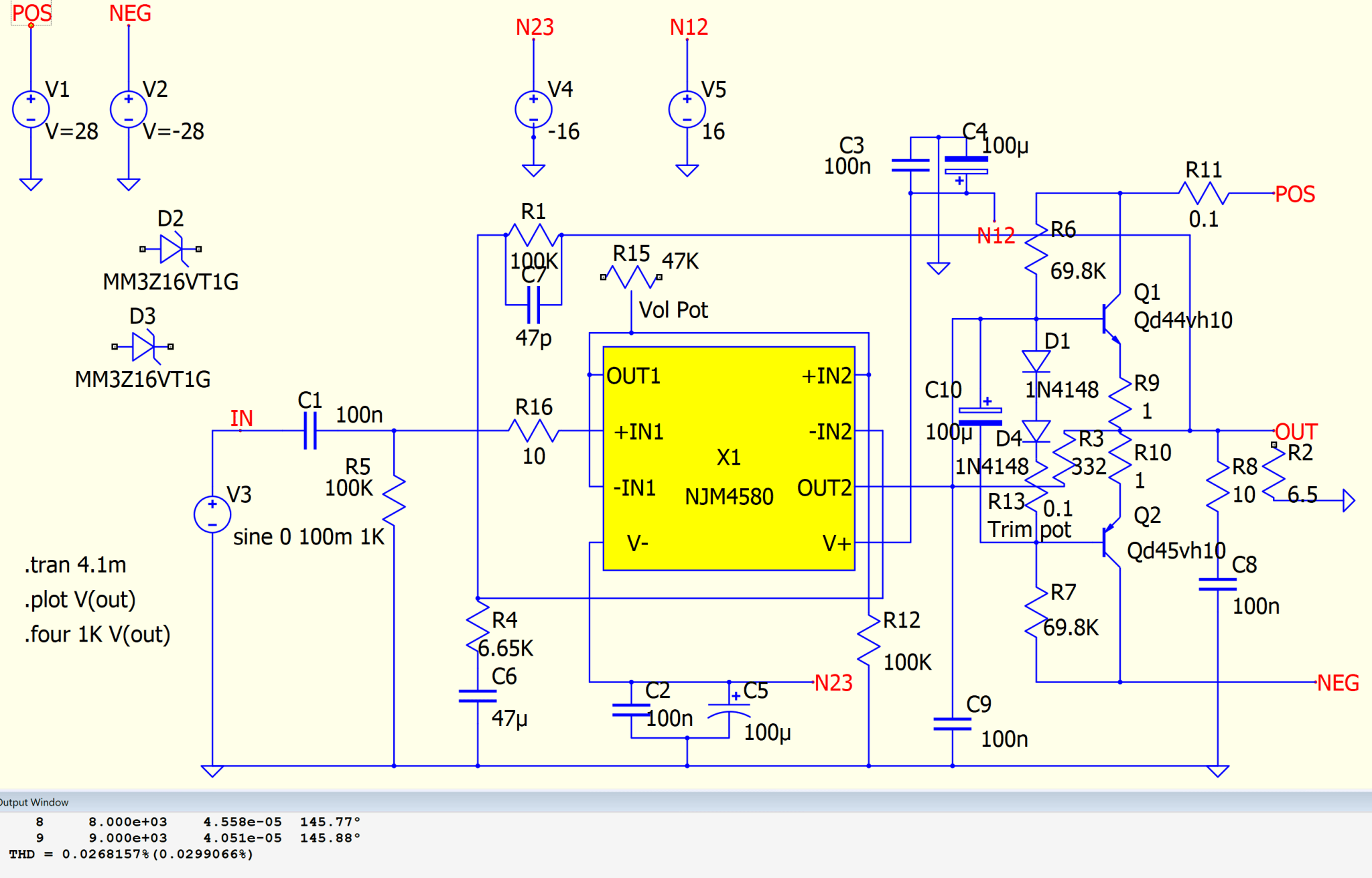

Following previous suggestions
with R6 / 7 @70K; R9 / 10 @1 ohm the base to emitter now measures 498mV (compared to 410mV before). Quiescent current is 50mA. The resistor values seem higher than examples I've seen. Does anyone see any issue that I might have missed. Is the 1N4148 diode suitable?
Thanks.
