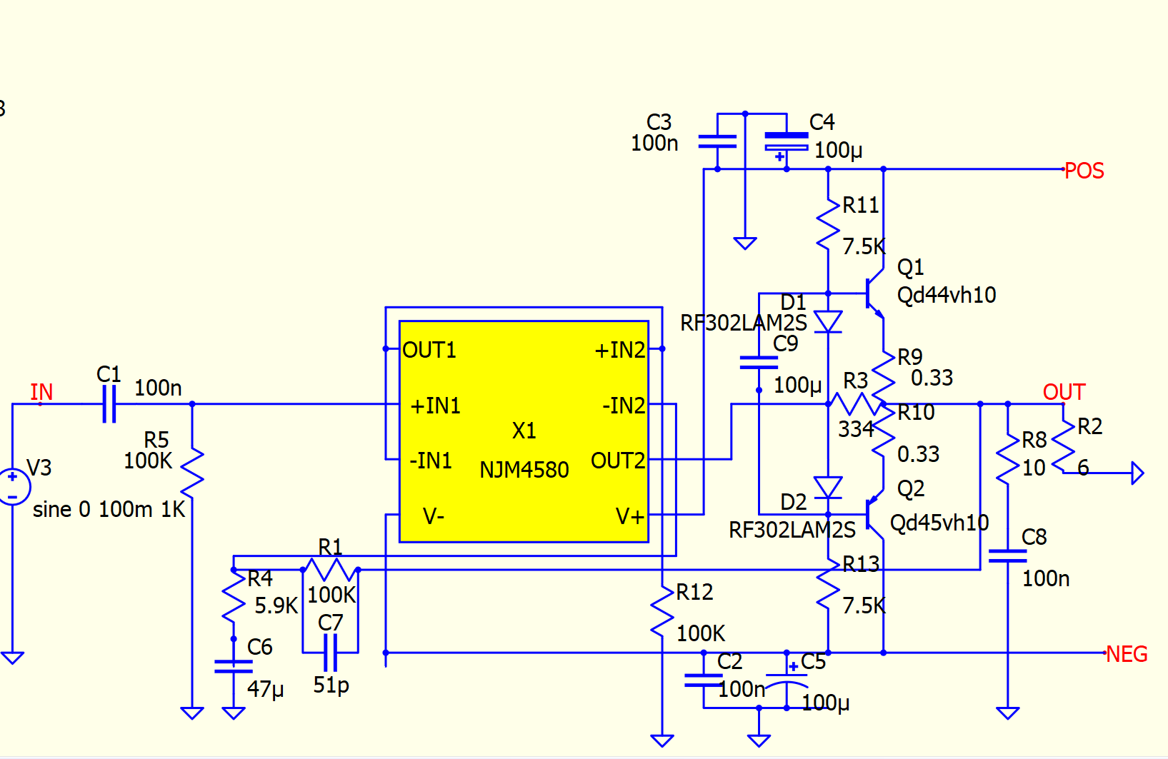

I selected different transistors. I am still learning about biasing and, from various sources, I came up with this (attached). With Spice I can measure current of 2.9mA through the diodes; from emitter to Re 27mV (26 and 28). I still haven't found a way to attach an ammeter to QSpice.
I am wondering if this resembles something worthwhile testing on a breadboard? I have no plan to add drivers; the op amp's current output is enough for the selected BJTs. Some mentioned earlier to add a trim pot...that's beyond my breadth of knowledge design wise but would be happy to learn.

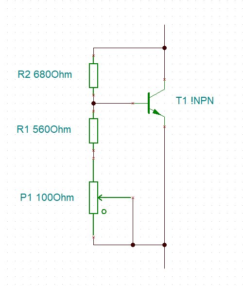

The link is a definition of a rubber diode (Vbe multiplier), I'm no further forward in determining the values of resistors to bias a 10W audio amp.Replace D1 and D2 with a Vbe multiplier.
What I know is V is +28 -28, 6.5V Load, Re will likely be 0.33 ohms and someone mentioned emitter to Re should be about 20 - 25mV.
If a Vbe method is used, or diodes, my question remains how does one determine the values of the resistors? YouTube videos, so far, haven't been helpful.
Determine the current through the transistor, eg 10mA.
Determine the beta of the transistor, eg 100.
The base current will be 0.1mA.
The current through the (variable) resistors should be small compared with the collector current.
The base current should be small compared with the current through the resistors.
The optimum resistorcurrent is collector current divided by the square root of beta.
With the given values, Ir =1mA.
I've never seen this recommendation before, but it seems quite reasonable. Can you advise me of the underlying math? Thanks!
Best regards,
Steve
No, pure intuition, but the explanation is already in #29.the underlying math

Thanks for the explanation. Unfortunately QSpice doesn't have a trim pot! No ammeter either. TINA and PSpice install with errors, won't play nice!
I'm back to the original question about diode biasing resistor values. Was my latest diagram worthwhile testing on a breadboard?
You can try microcap also.
You don't need ammeter in spice, current can be calculated by knowing voltage drop on a resistor, 0,33 ohms in your case. I = U /R . Assume 0,05V drop on 0,33 ohms. 0,05/0,33=0,151 Ampere. Every simulation program miss some of components , whose are present on another app. But for playing you may use similar opamp,or different, and compare differences.

Consider the output transistors running at a higher current then the diodes. So, their Vbe's is higher then the Vd's.
Without an extra resistor in series with the two diodes, Q1 and Q2 are pretty much closed and the amp operates in class B.
The value of this extra 'in series resistor' depends on the actual current through the diodes and the extra voltage needed to put Q1 & Q2 into small biased class AB. That extra voltage is the higher Vbe to open Q1 & Q2 and the voltage drop over R9 & R10 times the bias current.
Bias current through Q1/2 say 50mA, the Vbe's at 0.75V. Voltage drop over R9/10 is 50mA * 2 *0.33 = 33mV (not very much!).
Total needed bias voltage at the bases: 1.533V.
Current through the diodes D1/2 say 10mA, the Vd at 0.7V.
Needed 'extra' voltage over a series resistor: 1.533 - 1.4000 = 0.133V.
The resistor must be 0.133V / 10mA = 13.3Ω -> {12E0 <> 15E0}.
Using a 47E potmeter (actually a variable resistor!), logaritmic preferred, will set the proper bias setting.
This is all linear math, you should be able to determine all correct values yourself.
Things become 'out of balance' as soon as a modulating signal is applied, but that was the initial condition to aim for.
