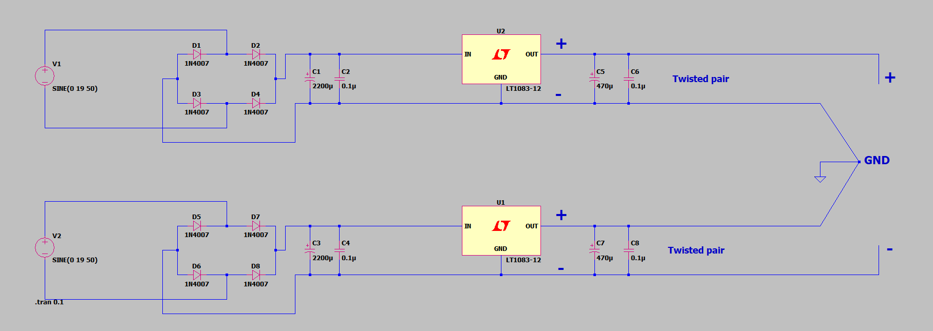

The guy in the video didn't seem to consider other possible effects of bi-wiring. What about "common impedance coupling/distortion" at frequencies where both drivers are drawing current at the same time, around crossover?
To think about is some more, here are some more or less bi-wired +/- rail power supplies:
Why not just connect the grounds together at the power supplies, then use a shared ground wire to the load with maybe half the resistance instead? No difference?
