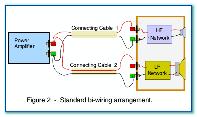

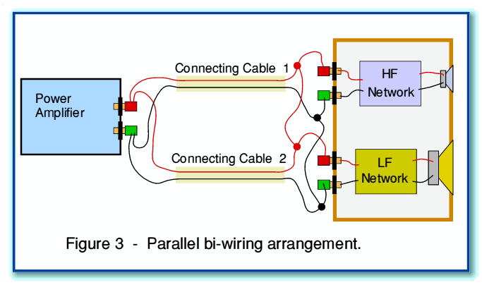

At around 6:37 in the video Gene says "Electrically, bi-wiring does virtually nothing".
Thoughts?
This photo was used to show the standard bi-wiring arrangement.
His statement is incorrect.
In the electrical crossover region, using the standard bi-wiring arrangement, there are now two connecting cables, effectively 1/2 the resistance of one cable. Cutting series resistance in half increases the damping factor (the amplifier's ability to control speaker motion) by almost double, which is easily measurable, and does have a sonic effect.
Something like Ripblade noticed could be attributed to the increased damping factor in the crossover region:
That said, the damping factor would be improved across the entire frequency range rather than just in the crossover region if both cables were wired in parallel:I can hear the difference with bi-wiring as a clearer phase differentiation of the drivers in the stop band region. It's as if the crossover's electrical influence on the drivers is more obvious. Result is a subjectively better separation of instrument dynamics where the drivers overlap, teasing them apart, especially in complex music passages .
In other words, you should get a wider ranging improvement simply doubling the cables rather than using the standard bi-wiring arrangement.
