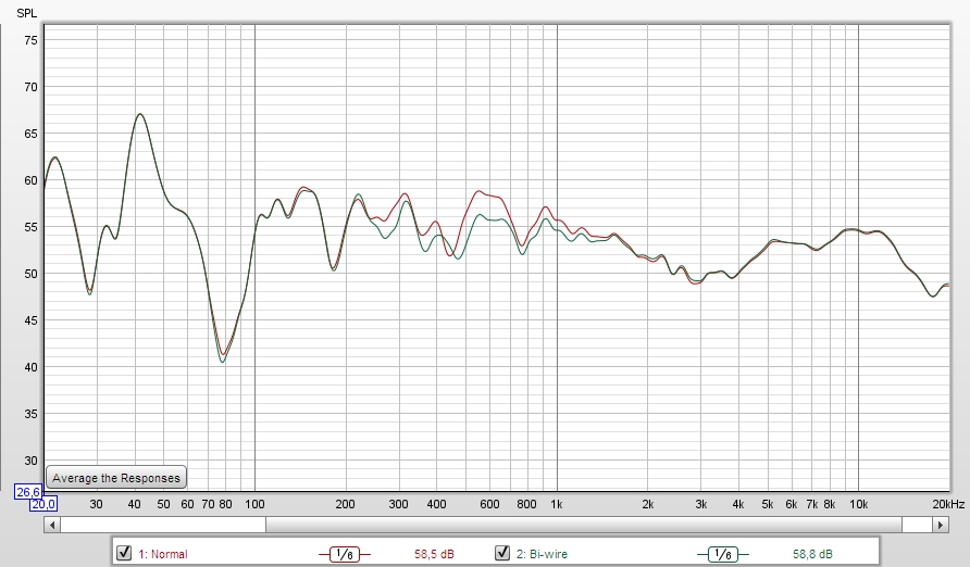

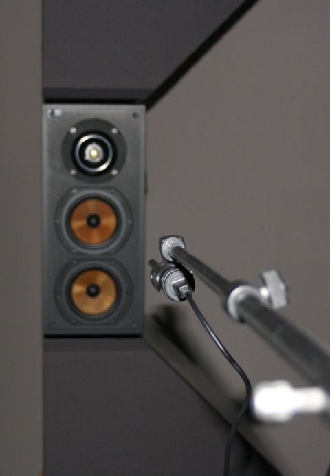

I’m not sure what I’m looking at here in your measurement setup photo……..I see only the TMM section of the speaker?Here's a test with and without a bi-wired speaker. Measuring mic at 1m distance, no DSP.
Absolutely nothing changed in the room or the setup, only the wiring.
First wire was connected to the bass speakers, second to mids and tweeter.
There is quite some difference in the 250Hz to 1.5kHz range.
I leave it to the seasoned speaker builders to draw a conclusion. 🙂

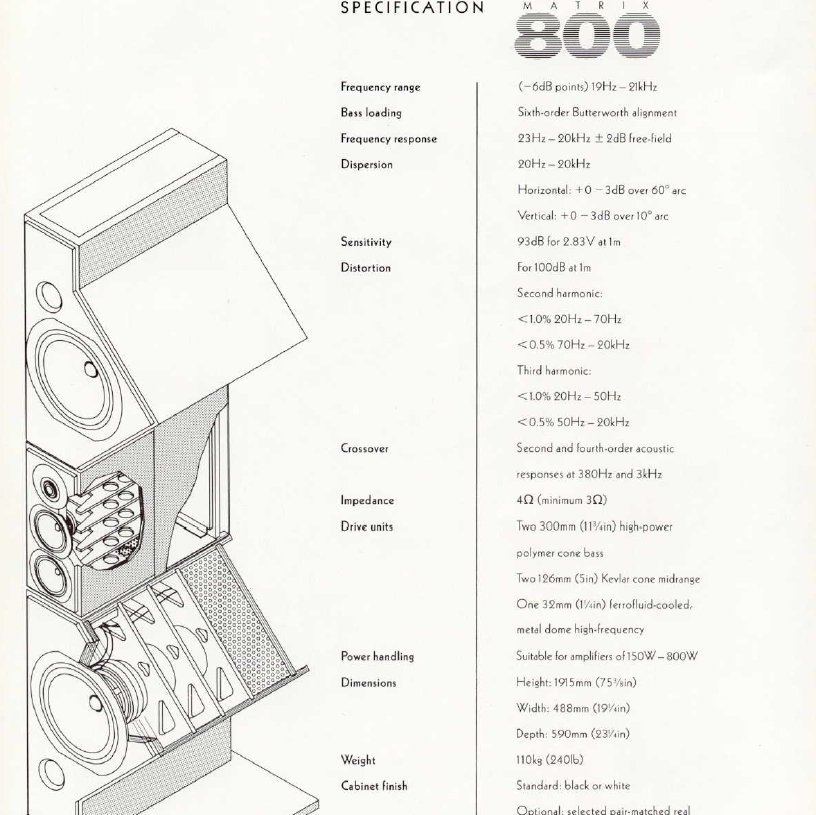

Speaker specs:
Follow by the model Bruno proposed, one with observable difference with bi-wiring might want to check if the current distortion is high in their speaker drivers.

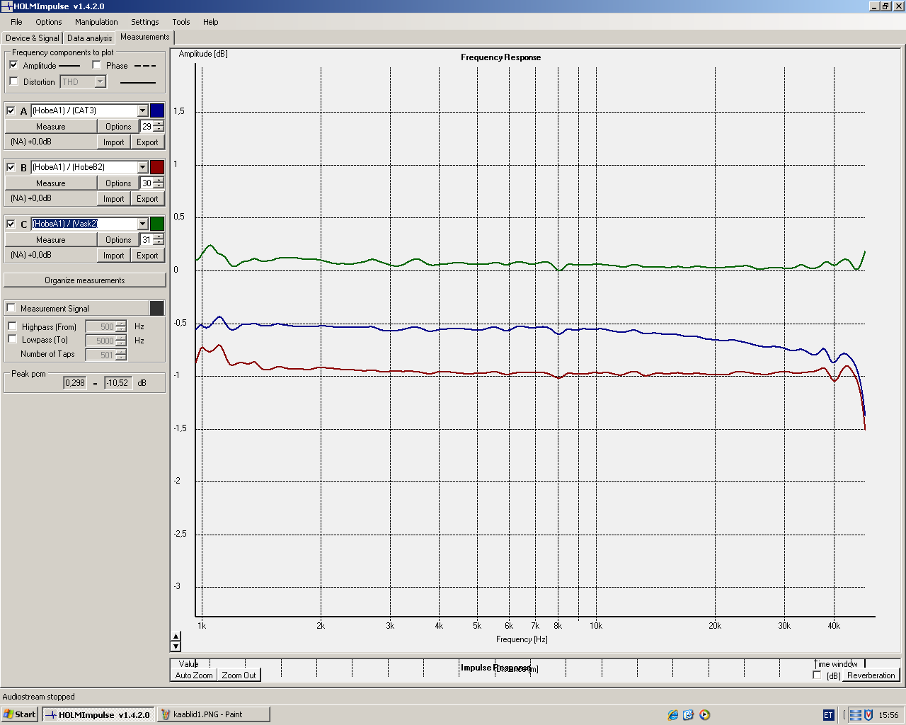

If tweeter is low inductance ribbon tweeter and you use some special low inductance braided cables for tweeter and mid, then you can see some difference in measurements.Here are the graphs with one and two cables. 'More copper' as Arthur suggested.
There's a minor difference, however, very likely inaudible.

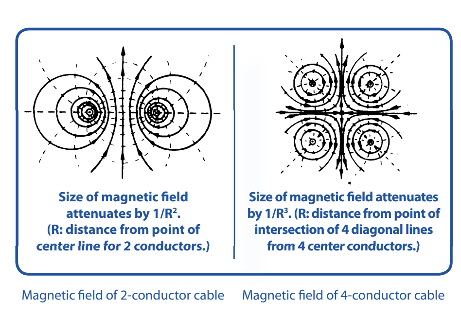

Here is a view of the magnetic fields around 2-conductor and star-quad cable as viewed from the end of the cable:
Star-quad has four conductors in a controlled-geometry configuration such that if diagonally opposing conductors are connected together at the ends where the connectors are, most of the magnetic fields cancel out. That lowers cable impedance (not just resistance), reduces radiated EMI, and reduces susceptibility to pickup of EMI from external sources.
However, that's just the basic idea. Cable construction can get more complicated and involve more factors than just one important technical feature.

I presume that you don't use star-quad, otherwise you would be more than happy to present us a graph like the one I did. No need for an FFT, a simple frequency plot would suffice. It would equally boost our confidence in your explanations.
Thanks for that chart.
It seems like CAT3 isn't really suitable as a (ribbon) tweeter cable.
I assume it has a high capacitance?
Yes, relatively high capacitance but very low series inductance. I had no problems with this cable and ribbon tweeter as my amp have low output impedance also in high frequency range.Thanks for that chart.
Note that lines are the result of SPL measurements divisions, lower level means higher response compared to base.

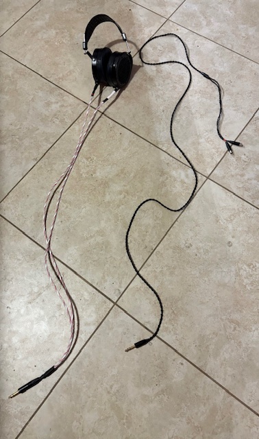

Here is a pic of my planar headphones with a stripped star-quad cable. Also shown is the braided cable that came with the headphones:
The two cables differ in various ways, including length, and total resistance. It wouldn't just be a comparison of star-quad geometry verses not.
For my big speakers, the cable is custom manufactured, then it is cut to length and the connectors put on here. They are a proprietary design, and are not sold. I have agreed not to talk about their construction, but I will say it does involve a symmetrical geometry.
