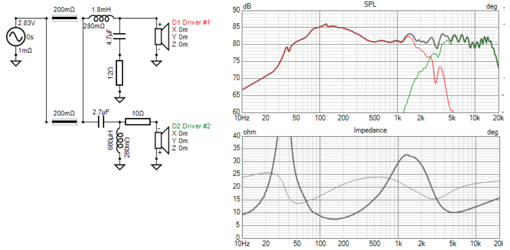

I have done some work on the simulator. Here setting up a quick generic cross, with negligible source resistance and showing the load impedance (The 200mΩ resistances are shown shorted in this screenshot).

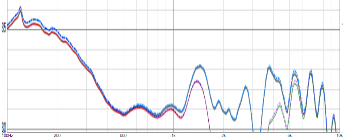

Here I set the response as an overlay, as the baseline, then changed the source resistance to 200mΩ. There are impedance minima at 150Hz where the response differs by 0.25dB, which may be just audible with a low resonance speaker, and near 5kHz where the response differs by 0.15dB, which by comparison should be somewhat audible.
I set that as the new baseline and then changed the model to bi-wire. 200mΩ in each crossover leg, both fed from the same voltage.
The difference is so small as to likely be inaudible.

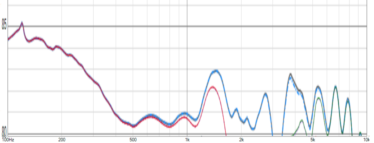

I repeated these last steps using 1Ω of cable resistance for single and bi-wiring, looking to demonstrate that the legs will interact given enough source resistance, and towards 4kHz there appears to be enough variation to be potentially audible.
