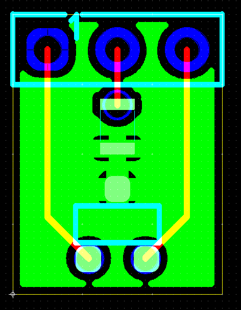

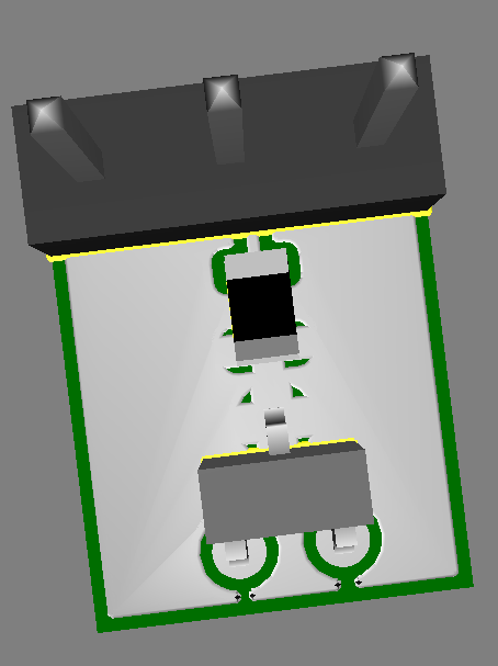

> If you use an SMT adapter the leads will bleed off some heat.
To where, the FR4 PCB material (poor thermal conductor) ?
For audio applications, one wishes to place a gate stopper close to the gate pin.
So the copper on which the gate pin is soldered cannot have a large are for dissipation.
Patrick
Just an idea, you can also pour copper on the bottom and punch through vias.
for 1:1 replacement G should be between D and S?
Indeed. Sorry, I missed the point. It is more how to use BF862 with thru hole pcb, than 2SK 170 replacement.
Sorry to Juma too. His pre/amps are designed to use BF862, not to replace 2SK170.
