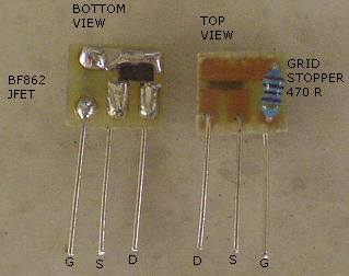

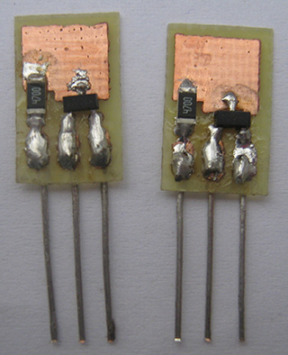

Boys, you should have read Juma's threads. He explained everything you are arguing about a few years ago.
First picture shows Juma's work. Gate stopper, big copper area for gate pin. If you are not fearless builders, like Papa sez, you can solder thin copper foil to make cooling area even bigger.
Second picture is my work. Looks awful, but it works.

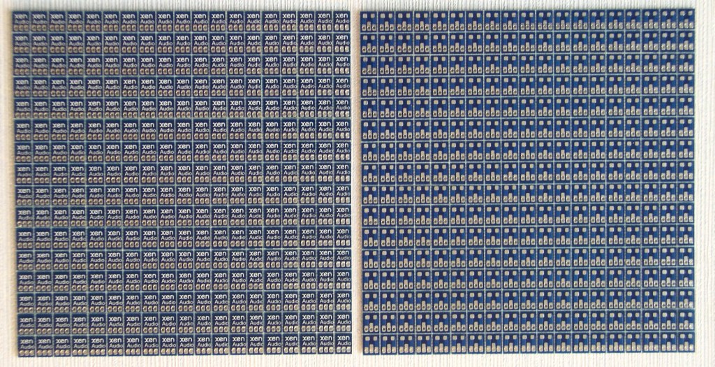

That looks quite nice... just like this...
I can give you the EAGLE binaries and you can order square inches printed circuit board BF862 2SK170 replacements...
Cute
- BF862 instead of 2sk170?
