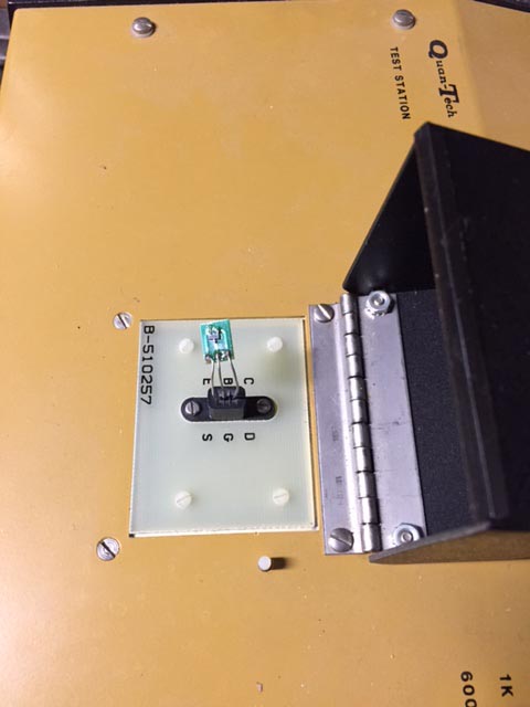

Just an idea, you can also pour copper on the bottom and punch through vias.
