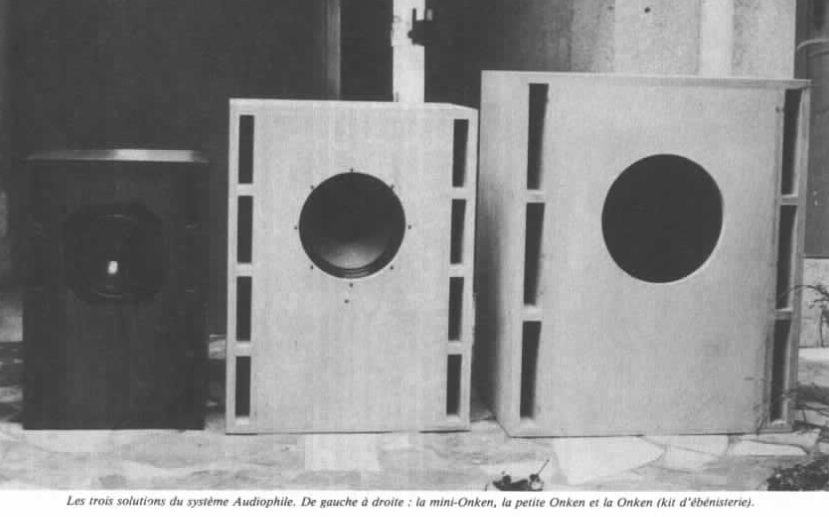

Petite Onken (the one Sebastian has) between Onken 360 and mini Onken (Focal)
I just take the size of the Petite Onken, and calculate a 250 l enclosure, to be used with a classical port to save volume.
Andre

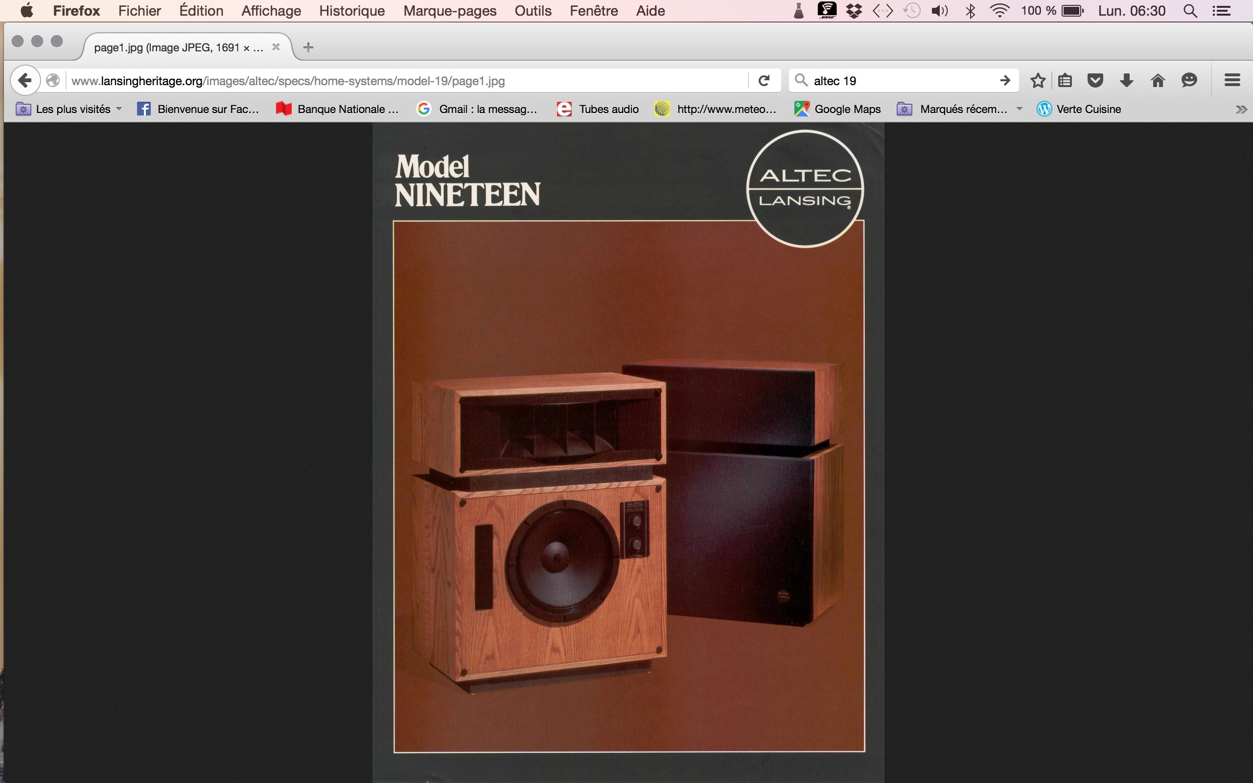

Exactly. The idea is a classical design as shown with André's plan above. To illustrated, he puts a cylindrical port but I'm interest in a rectangular one. As a joke with a lot of reality, André talked about a "Beyond Altec 19" project, which is quite true. With the advantage of a separated woofer enclosure to allow better alignement between all the emissive sources.
I'm not sure if I'll go to the Salon Son et Image (SSI). We'll see.
Sébastien

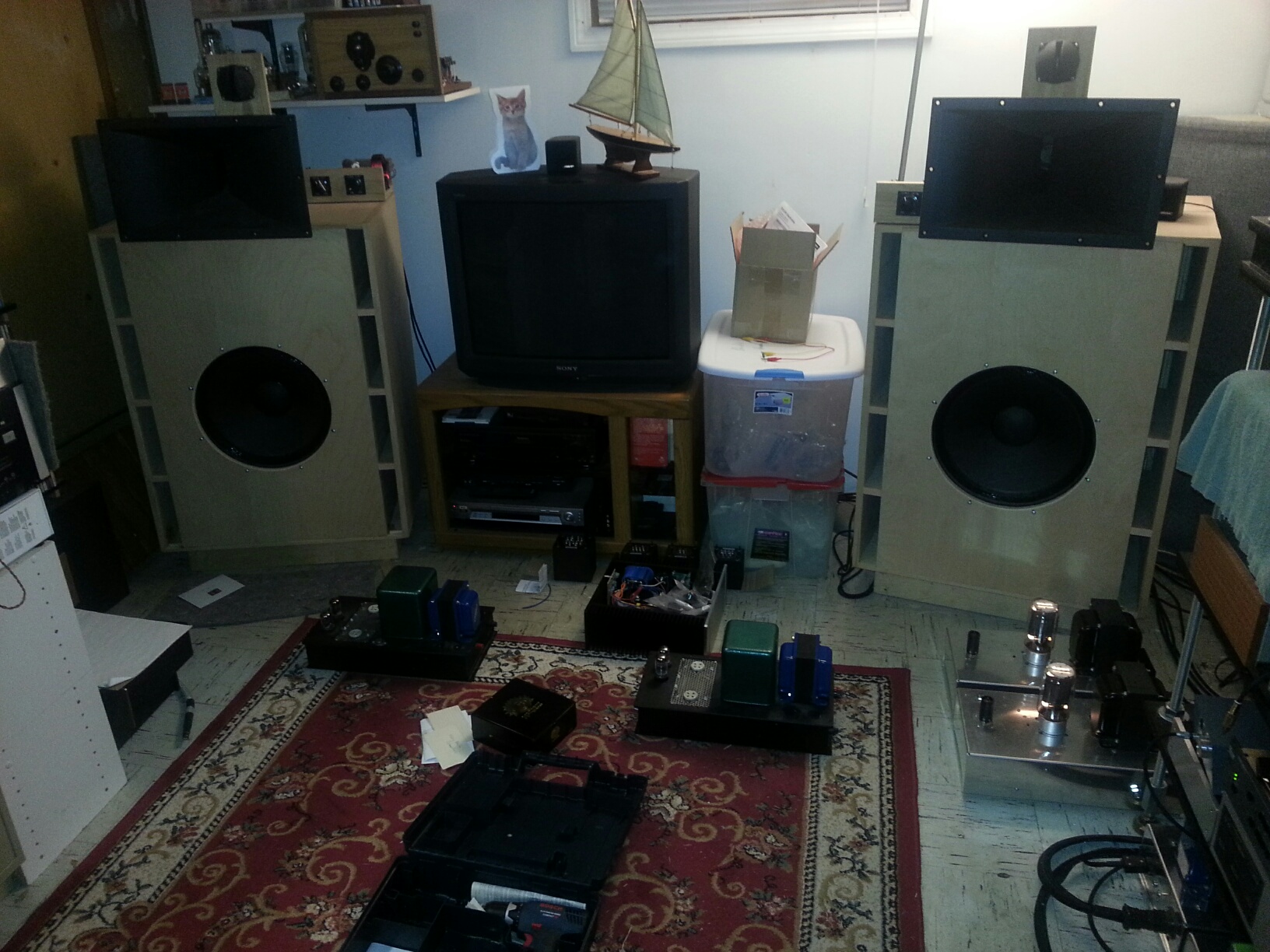

No question the GPA drivers are great. I have sister company Iconic 165-8G, best I have been able to ascertain they are identical to the GPA part.
Let me know by PM if you decide to go to Son et Image, I will be going with two friends, and this will be my fourth year. Last year was quite good! Will meet up with some other Montreal audiophiles while there.
I've included a picture of my Onkens which are not very pretty.
GM and Pano were instrumental in helping me get mine together.
A certain someone 😉 in Montreal sent me a box of felt which proved to be a much bigger improvement than I would have ever imagined.
You can play games with qts by adding some series resistance which with some other changes will allow you to extend the LF response of driver in a given box at the expense of some efficiency. (at least with solid state amp - the tube amp's high output impedance is a benefit and the losses are internal to the amp and not an external resistor) GM can explain the speaker end of it far better than I, suffice it to say I designed for a total Rg (value used in the spreadsheet) of 3 ohms which includes about 2.5 ohms for the amplifier which is a GM 70 SE without feedback and the dcr of the XO choke which is about 0.33 ohms.
I now use those square metal Russian PIO/PPIO caps sold cheap on eBay in the XO, have not heard anything better after multiple iterations with not so cheap plastic caps.

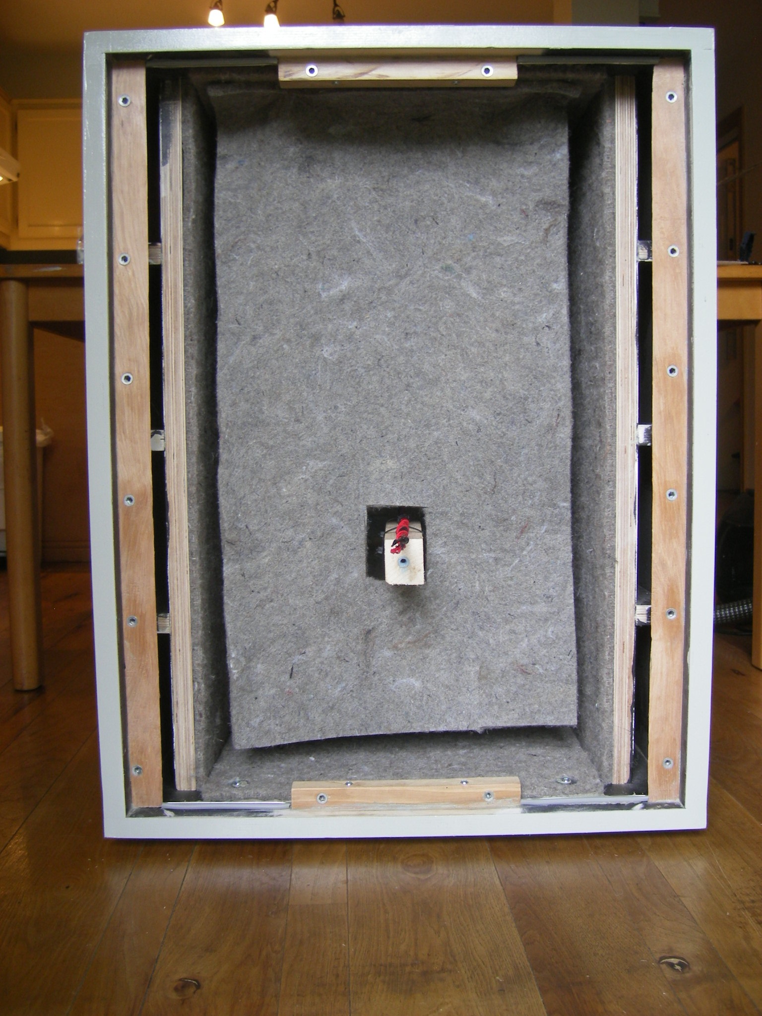

Glad that the felt was a good improvment. On my side, it seems to works perfectly with the petite Onken at a price so much less then wool felt. The good thing is that it has the same thickness, density and weight per inch that the wool felt Hiraga and la Maison de l'Audiophile use in their Onken project back in the days. I'm planning to use exactly the same one in my next project. Plus, I'm considering to also place the interior curtain like it was suggested in petite Onken's article (see below for a picture of the interior curtain).
Looks like the old high quality jute [felt] used as under-layment with high end [commercial] carpet I've recommended when only the best will do. Got in good with a commercial carpet layer and it could be had in large enough scraps for 'pennies on the dollar' and was often free if off a used 'pull-up', which was still like new along wall edges, etc..
GM

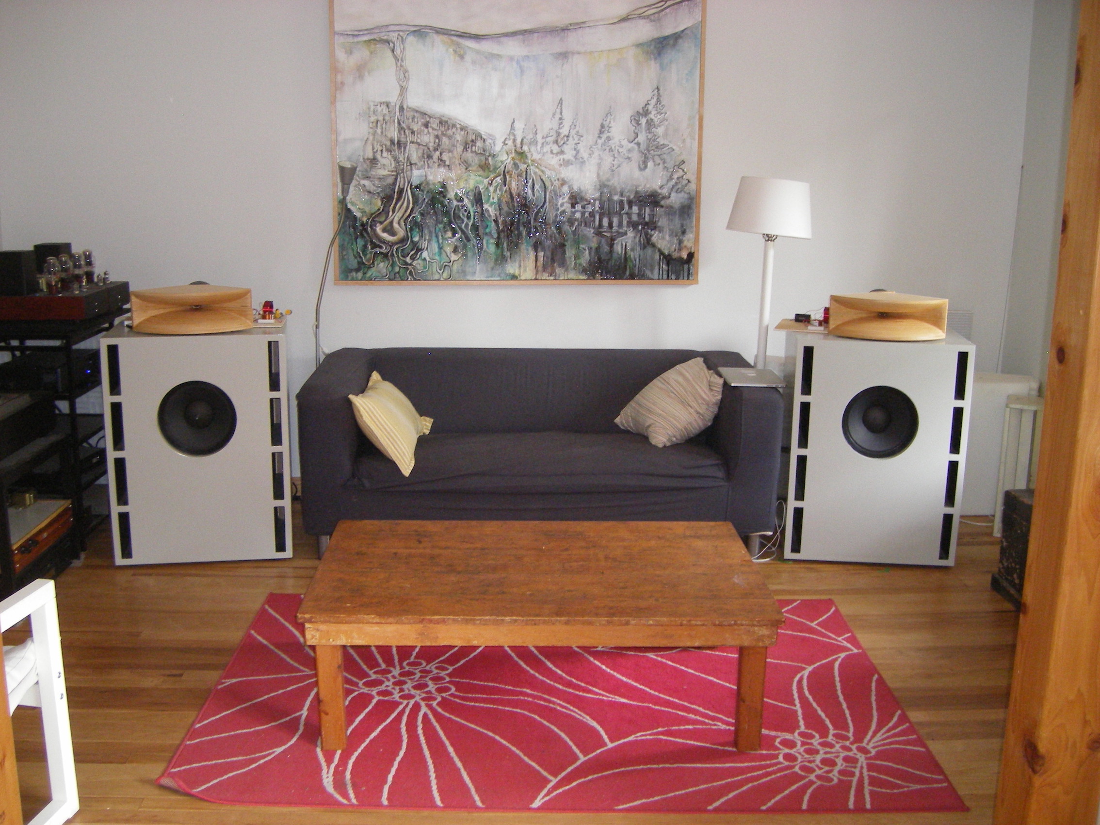

Swak, I do have space constraints and WAF limits. See the picture of my speakers and room last year. There is not much space left in width.
Regarding the felt, it's not exactly the same as the one I'm talking about, but it seems pretty similar.
Sébastien
