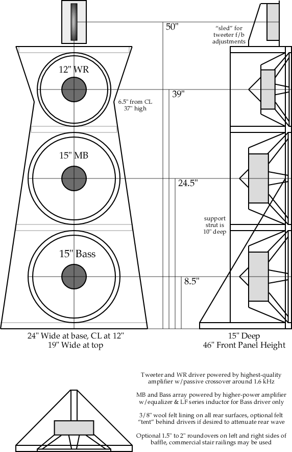

Here's the latest thoughts about the open baffle - will construct the baffle, and measure and audition drivers after the RMAF. Curious to hear what the various EnABL'ed drivers (including Lowther) can do, and also curious if the elusive Fertin widerange field-coil driver will make an appearance.

Lynn,
looking at your OB proposal:
How are you going to deal with the energy response step at the crossover between WR driver and tweeter? Up to 1.6 kHz the WR driver will radiate with (hopefully) almost equal power to the front and rear, while the tweeter will only radiate to the front. So you will need some controlled rear wave attenuation over the passband of the WR driver or a second tweeter IMHO.
A "felt tent" behind the driver sounds too "lightweight" for the upcoming task.
In my own applications I never got that right, and I always wondered how the Orion could do without a second tweeter or a rear wave treatment of the midrange.

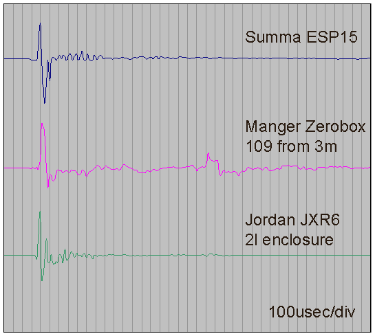

There was a discussion about impulse responses. I've collected three probably interesting responses: Summa ESP15, Manger 109 measured at Gelsenkirchen HiFi exhibition on axis and from 3m, and my Jordan JXR6 (0.15-30kHz) in steel enclosure with a lot of damping (0,5l free air and 1,5l wool) and at 0deg, 30cm. Manger is meant to be perfectly aperiodic, Jordan - well controlled modes for aluminium diaphragm.

Plan to try both approaches, maybe at the same time. At 1.6 kHz, wool felt (and other damping materials) are starting work pretty well. Gary Pimm is using Bonded Logic "Ultratouch" fiber to fill his open-backed dipole woofers with great success - this recycled cotton fiber has high absorptive properties, and Pimm's system has the best, most crisp, and tonally realistic bass I've heard so far.
I'll be using the Ultratouch fiber for the open-backed Bass chamber, and possibly be trying it in small, custom-made pillows behind the other drivers - white pillows would look more than a little silly, but it's easy enough to dye them black before filling them with the Ultratouch fiber.
The whole trick with damping is keeping the fibers several inches away from the cone - this is important - and using organic-origin fibers as opposed to synthetics. I tried lots of different fillings for the Ariel, and was not at all happy with the sound of foam, fiberglass, or polyfill. Wool and cotton sounded the best.
If anything, I expect a dipole is going to be even less tolerant of odd-sounding damping materials - these can have rather weird dynamic-related colorations. If you select a damping material with suboptimum properties, you will hear a noticeable muffled or dynamically constrained quality to the sound - always compare against no damping when evaluating the sonics of damping materials. Compare speaker A against speaker B for quick comparisons - it won't so much be a tonal coloration, but more of a flattened, murky, "closed-in" sound you want to listen for. This is NOT accuracy, it's an unwanted coloration.
It's entirely possible I won't find any damping material acceptable in the midrange - that's a real possibility that affects the rest of the design.
The vertical directivity of the ribbon tweeter will bear on the decision for or against a rear tweeter - as you might expect, it's about subjective decisions of spaciousness and smooth integration with the large-area midbass driver. I also plan to have a wooden disk to fit in the 12" hole that has an 8" cutout for the 8" drivers that look interesting (Lowther, Fertin, et al).
I feel modern designs have gone astray in focussing on dispersion vs frequency compared to the basic sound of the drivers themselves. Considering how grossly colored I find contemporary "audiophile" drivers - I keep being surprised how people are able to ignore such basic colorations while looking at all those pretty-looking polar graphs. I have to be direct here, folks - I really dislike the sound and philosophy of modern high-end audio, sorry. Please look elsewhere if you find the sound of modern high-end even a little bit palatable.
I should warn readers, like I did for the Ariels, that my designs do not follow contemporary trends in speaker design. I optimize for natural sound on solo voice and choirs, followed by naturalistic qualities on other instruments (symphonic), followed by natural spatial qualities (not imaging per se) and realistic dynamics - in about that order. I make no claims for the "best" or "ultimate", but choose to address problems I see ignored in other approaches.
Everything I do is off the beaten path - look at how I design amplifiers. If all of this is just too weird for you, please, look in another direction! There are lots of talented folks here in diyAudio - you have many choices.

Ultratouch seems to have a very linear absorption capacity over a wide frequency range. I would rather imagine absorption rising with frequency, so that at 1.6 kHz the WR would be "dead" in the back. Something like 41 mm thick Basotect might achieve this:
