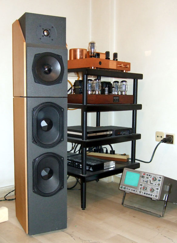

Salas,
Here's a picture of the "Gecko" from last year:
This picture was taken when I had the speakers on a demonstration at a Pacific Northwest Audio Society (PNAS) meeting. They put a short summary of the presenation of the "Gecko's" in their newsletter. There is a passive crossover in this picture, which was built specifically to enter the "Puget Sound" speaker contest sponsered by the PNAS. It is normally a fully active system.
This was during the tweeter audition period of the project, and I had two tweeters in the baffle for comparison - an Hiquophon OW1 and an Aurum Cantus G2si. After extended auditions, I chose the OW1, and have since removed the G2si and blanked the hole in the baffle.
Edward

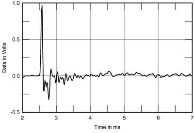

Lynn,
The crossover points are ~350 and ~3500, 4th order with time alignment (delay). Yes, the OW1 crosses in quite high because of the extended bandwidth of the PHL 1120.
The pre-ringing is a data processing artifact. I just made a whole bunch of measurements of the system over the Labor day holiday weekend, but did not save the impulse responses, just the FR's. The pre-ringing is a by-product of running an inverse FFT on the FR dataset - which is bandwidth limited.

Lynn Olson said:
Nice time response - again, I doubt very much any horn or waveguide could match that, at least from the data I've seen published. This takes us to electrostatic territory with much better dynamics thrown in. Curious about the crossover points you've chosen - I imagine the 3/4" HF driver is crossed fairly high, to take advantage of the PHL's extension.
Curious about the pre-ringing over the first 300 microseconds - it's not easy for a tweeter to do that, it looks more like a sound card artifact due the built-in anti-alias lowpass filter - set to 20 or 40 kHz, maybe? Although my MLSSA card is ancient, dating back to 1991, I run it at 120 kHz to avoid lowpass filter artifacts and see what the tweeter is really doing. If the pre-ringing is what I think it is, your speaker is actually better than what's shown above.
I find the rapid decay in the time response corresponds to depth portrayal, or spatial fidelity - not imaging or reverb per se, but an accurate impression of the actual size of the performing venue. Weirdly enough, you can actually sense this before any music starts to play, or likewise with applause, which is extremely revealing of transient distortion and midrange/HF coloration.

salas said:... and double 6X9s shielded.
Yes... as many others I have been following this thread with interest since there are excelent contributions...
I know you might have already given details of your set up but by this time they are burried some place on this thread.
Could you elaborate on the HF driver you are using? also XO points? pasive XO? order of XO?

In a nutshell, I use a 26lt closed box with 2x Tangband 6X9s (W69-1042). A second box houses a PHL1220, and a time aligned Audax A20, but moded with a 4 Ohm diaphragm. A foam packed slit runs the back and aperiodically vents the PHL. The Tweeter is unobtainium. Sensitivity is 94dB overall.
Passive XO. Nothing on the woofers, 6dB low pass & 12dB high pass for the PHL, 18dB for the tweeter. You can see its response and crossing in the attached chart, room modes, warts, and all. The design axis is high, in-line with the cabinet's top.

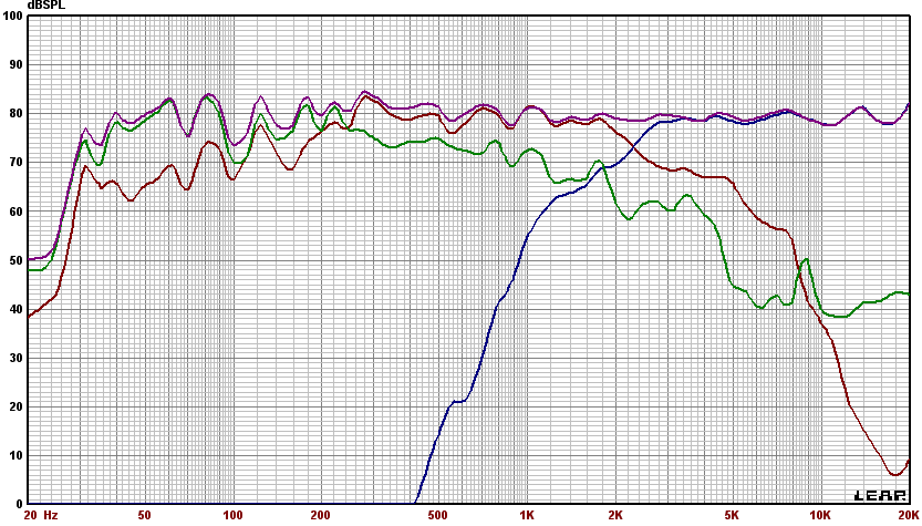

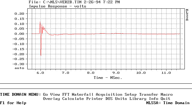

Hi there Dr. Geddes, are these the curves you're referring to? If I'm reading them correctly, it looks like it takes the Summa/ESP15 about 1.5~2 mSec (depending on interpretation) to visibly quiet down to zero. But maybe I'm not reading it right, and have got the scales wrong, or copied the wrong set of data from your papers.
Maybe we can get Tom Danley's impulse data as well - AFAIK, the Summa/ESP15 and the Unity systems have the best impulse response for waveguides (and horns) out there - I've never seen anything better.

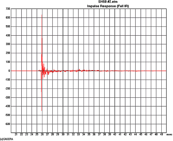

Been pawing through the ol' hard disk, and found this pix for Tom Danley's SH-50 Synergy horn. Reduced it by 2/3 so it would fit into the diyAudio size limits, and then re-sharpened in Photoshop - sorry about the crunchy appearance.
Hmm - decay time is kind of hard to judge here, with some visible clutter all the way out to 10 mSec. Most of it seems gone by 3~4 mSec, though, if I'm reading it right.
If either Dr. Geddes or Tom have more recent impulse data, many of the readers (including me) would love to see it. Impulse data for horns and waveguides seems very hard to come by - you sure don't see it on the prosound sites, that's for sure - all those guys do are those 1/3 octave smoothed "happy graphs".
One of the things I like most about impulse (and CSD) data is there's no good way to "smooth" it, so you're always looking at the as-is microphone response (although this can be sometime degraded by digital lowpass filtering - the giveaway is HF pre-ringing).

As for off-axis impulse response, unfortunately I don't have many of the old MLSSA Ariel measurements stashed on this computer, but back when I was last measuring it in 1994, I don't recall any dramatic changes with the off-axis response. I would have been surprised to see much change at all, considering I took some steps to reduce cabinet-edge diffraction, the 4th-order acoustic Linkwitz-Riley crossover wasn't very sensitive to off-axis shifts, and all three drivers had very wide measured dispersion. Considering their tiny size and close mounting, not surprising.
If there was a net 90-degree phase angle between the drivers, as with an acoustic 1st or 3rd-order crossover, they tended to be more sensitive to off-axis changes. The first version of the Ariel started out with a really simple 1st-order crossover, and I noticed it was quite a bit more sensitive to off-axis response shifts. Coloration levels were higher as well, which prompted the change to a little more serious crossover.

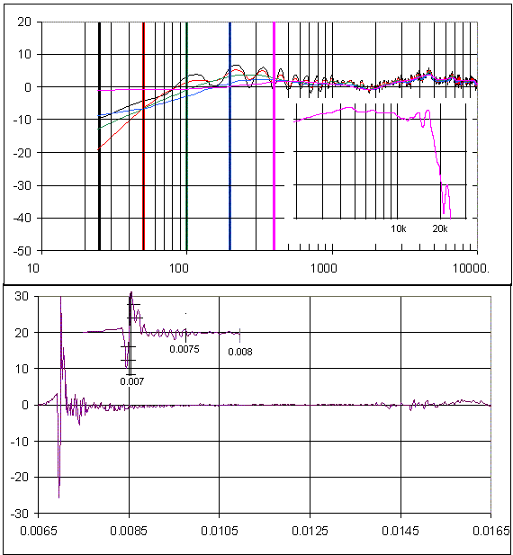

Two of the reasons I get such clean time data is the choice of a 120 kHz sample rate with a programmable 25 kHz Bessel lowpass filter for the ADC, and a rather unusual mike stand for the ACO Pacific 1/2" condenser microphone.

In the case of my impulse, all the 'junk' before the impulse - and the 'wiggling' after the impulse (2.5 to 4 ms) - is the result of bandwidth limiting. My impulse was generated by using an inverse FFT on the frequency response data - which had been truncated after the orginal FFT. On the Meyer sound impulse, I would guess that the initlal signal before the spike is the woofer signal leading the horn a bit - slight time misalignment.
Edward

Lynn Olson said:Hi there Dr. Geddes, are these the curves you're referring to? If I'm reading them correctly, it looks like it takes the Summa/ESP15 about 1.5~2 mSec (depending on interpretation) to visibly quiet down to zero. But maybe I'm not reading it right, and have got the scales wrong, or copied the wrong set of data from your papers.
From what I can see the Unity doesn't look all that good at all.
Impulse responses are dangerous things to look at because some things that aren't problems look bad and things that are problems aren't readily apparent. For example, virtually all of the ringing hash in the Summa impulse is the CD ringing at 16 kHz. which is very undamped as the FFT shows. But IMO this is not a problem since virtually no one can hear very well at 16 kHz. (my cat objects, but I don't). So exclude this ringing and the impulse dies in about .5 ms.
Impulse responses are linear in magnitude and we hear more logarithmically. Hence much detail that we can hear is lost into the picture. Impulses tell SOME of the story, but not it all. I look for delayed effects - just like I see in the Unity impulse.
