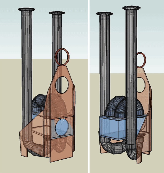

Very funky, but I can see WAF issues for some with this design.planet10 said:The concept for Bud's Rocket Ship TL/OB, the Lowther sits in the ring at the top. Scott came up with a (new AFAIK) variation on the daline for the bass support TL
dave

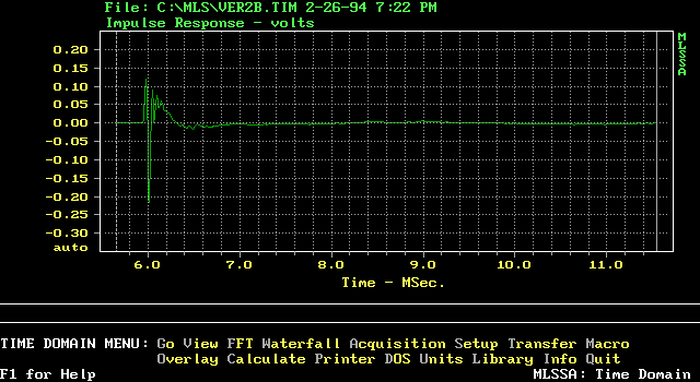

Like This...
Lynn,
Your goal is achievable 😉 This impulse response is of my current 3-way system - an active, tri-amplified system. I have chosen a 15" Lambda (93 dB), a 6.5" PHL (95 dB) and a 3/4" Hiquophon (89 dB). As you can see, the time domain performance is comparable to the Ariel's with substantially more headroom. In spite of the size of the drivers (against conventional HiFi wisdom) they are essentially silent in 500 microseconds. The system also possesses excellent detail resolution, while sounding incredibly lifelike. It excels with instruments like guitar, harpsichord and piano - all of which are very unforgiving of time-domain short-falls.
But most important of all... They are very easy and incredibly enjoyable to listen to.
Edward

Re: Like This...
Nice time response - again, I doubt very much any horn or waveguide could match that, at least from the data I've seen published. This takes us to electrostatic territory with much better dynamics thrown in. Curious about the crossover points you've chosen - I imagine the 3/4" HF driver is crossed fairly high, to take advantage of the PHL's extension.
Curious about the pre-ringing over the first 300 microseconds - it's not easy for a tweeter to do that, it looks more like a sound card artifact due the built-in anti-alias lowpass filter - set to 20 or 40 kHz, maybe? Although my MLSSA card is ancient, dating back to 1991, I run it at 120 kHz to avoid lowpass filter artifacts and see what the tweeter is really doing. If the pre-ringing is what I think it is, your speaker is actually better than what's shown above.
I find the rapid decay in the time response corresponds to depth portrayal, or spatial fidelity - not imaging or reverb per se, but an accurate impression of the actual size of the performing venue. Weirdly enough, you can actually sense this before any music starts to play, or likewise with applause, which is extremely revealing of transient distortion and midrange/HF coloration.

Re: Re: Like This...
Lynn
Then you did not see the impulse responses that I published for my system. But additionally, mine has the same impulse response off axis. No piston sources can do that.
