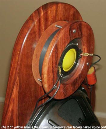

Lynn Olson said:Here's the latest thoughts about the open baffle - will construct the baffle, and measure and audition drivers after the RMAF.
Lynn, do you see any issues with having the tweeter up this high? Sitting on top of 2 - 15s and a 12 puts things at least 45" to the top of the mid/bass module. From my seating position I try not to put my tweeters up past about 30-32" or else funny things happen to the soundstage. That's why I was initally wondering about a solution with an 18 or 21 mated to the 12 mid. 2 -15s and a 12 is one thing if your 12 is a co-ax, but putting a tweeter on top of that seems a bit high.
Please accept this all as a simple question, my expertise is nowhere near yours (or T. Danley, E. Geddes, or John K.'s and probably a few others). I am mearly basing this on some observations of my own system and some others I have listened to.
Well, I like to have the tweeter/midrange crossover region at or above listening level, but never below. In essence, the tweeter/midrange are on or slightly above the horizon line, if there are any windows behind the speakers (the arrangement I had in Portland).
This corresponds to real-life experience in a concert hall or jazz club - we sit down, the musicians stand and do their thing. That to me is a real-life perspective, with the sound coming from close to the floor to a level just above listening height, and bouncing all around a lively-sounding room.
If a genuine real-life perspective sounds "wrong" on a loudspeaker, something is very wrong with the speaker - most probably, vertical polar patterns aimed in the wrong direction. This is actually pretty common with big audiophile speakers. I've heard quite a few expensive speakers that didn't sound coherent unless you laid down on the floor - and sounded utterly unnatural and disjointed when standing. If the "sounds good" zone is 30~32" off the floor, that's a pretty weird listening position - all I can think of is lying down on the couch half-asleep or lying on a bed (and maybe doing other things).
I sit pretty high - the listening height for me is about 40", unless I slouch way down, or sit in a chair that is impossible to get out of since it is so low.
Listening from a height of 40" or more, 30~32" tweeter height sounds squashed and dwarf-sized, and severely compresses the soundstage, giving a bizarre "tabletop" miniaturized sound, like a stereo table radio. Maybe some people like this, to me it sounds extremely unnatural.
Maybe you sit at 30~32" listening height - dunno about your physical size and household furniture - but to me, that tweeter height is very compressed-sounding. I like speakers that sound big and spacious - even the Ariels sound pretty large, far bigger than their physical size would indicate.

jholtz said:
Hi AJ,
I believe that speaker pictured belongs to John Pastuck and was present at the 2004 Iowa DIY Event. It and Salk Sound HT3's were a few tenths apart in the voting for best sound in the unlimited class. I did not hear the ringing John speaks of but I like metal drivers and don't care for the 8545's. They are very nice speakers.
Jim
Yes, those are John P's speakers. He did a really nice job building them. I think he is in your camp.
The thing about the metal cone mids isn't the ringing per say. As I showed in the CSD plots, with regard to the basic frequency response, it can be shaped given that the breakup is a linear phenomenon. It's the potential for excitation by harmonics of lower frequencies and the resulting "amplification" there of, or excitation from other acoustic sources that is the problem, or so I believe. Response shaping doesn't do anything for these effects since they are introduced independent of the crossover.
I tried to investigate the possibility of acoustic excitation. I set up a second speaker very close to a W18 and played swept sine waves around the resonant frequency to see if the resonance could be excited acoustically while monitoring the W18 voice coil voltage on a scope. The results were inconclusive. I probably should have looked directly at the cone with a laser but I don’t have access to that kind of equipment anymore since I retired. However, there is something going on with the Seas Excel metal cones (at least the W18 and W22 which I have played with) which catches my ear with long term listening. I find the same problem with other metal cones that I have looked at. Trying to quantify the cause is difficult. It's easy to identify what I hear, much harder to quantify why it is heard. Could be some of: A causes B which (speculatively) results in C, therefore A is the problem.
Anyway, the Seas metal cones are very smooth in the pass band but I find that they add a "zip" to the sound that I identify with the resonance (though I could be mistaken), even when carefully addressed in the crossover. And to me this takes something away form what is otherwise excellent. This may be exacerbated by the application since as a dipole mid the W18 is being pushed to the limits, excursion wise. I also think they just sound thin and weak in the lower midrange, but thats a hole other story. Like I said, the 8545 isn’t perfect, but I find the colorations in it more pleasing to my ear than dissonant. There is no question that the W18 and the SS sound different and you’re not the only one who prefers the W18. But I bet you like a Steinway compared to a Baldwin.
Thanks for the kind words about the performance of the system at the Iowa DIY. I think John has done additional tuning of the woofer so it probably sounds better now.
