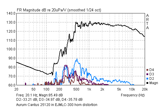

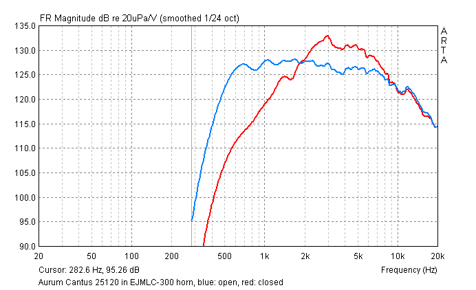

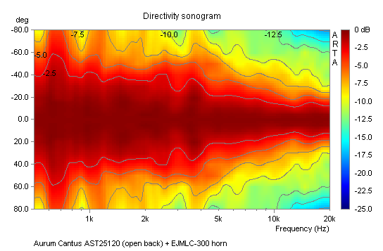

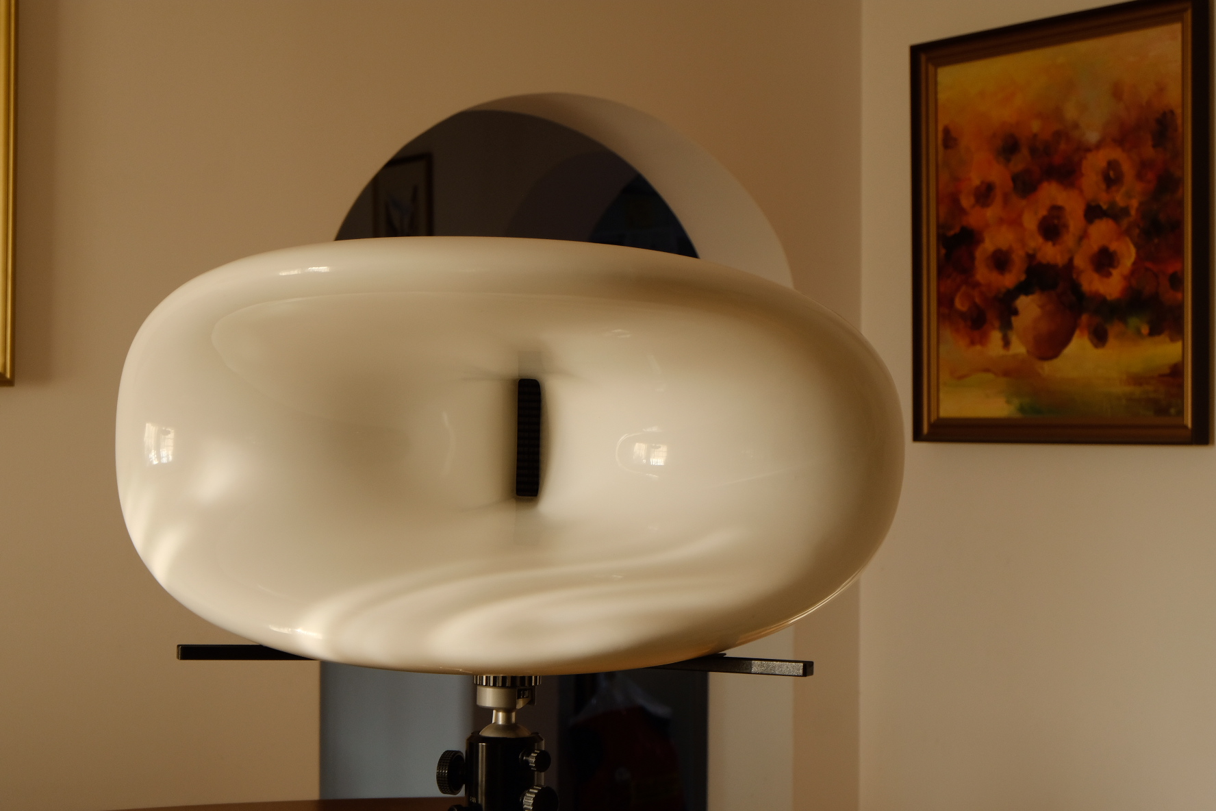

For those interested - 300Hz horn for AMT with open and closed back.
that horn, looks the kind of thing to scare young children - or maybe I saw too many 1950's monster sci-fi movies
Which amt do you have playing in that horn? Happen to have any distortion plots for that as well?
- see in the figure cap now it's listed as Aurum Cantus 25120. Are these available for other popular amt's like the Beyma?

Distortion and polar. Aurum Cantus AST25120 is affordable.
Hi jzagaja,
is it possible THD <= -60dB
regards
ivica
Can you explain? I'm about sending that horn to Viena on Wednesday so no more data in future. This is rather one off.

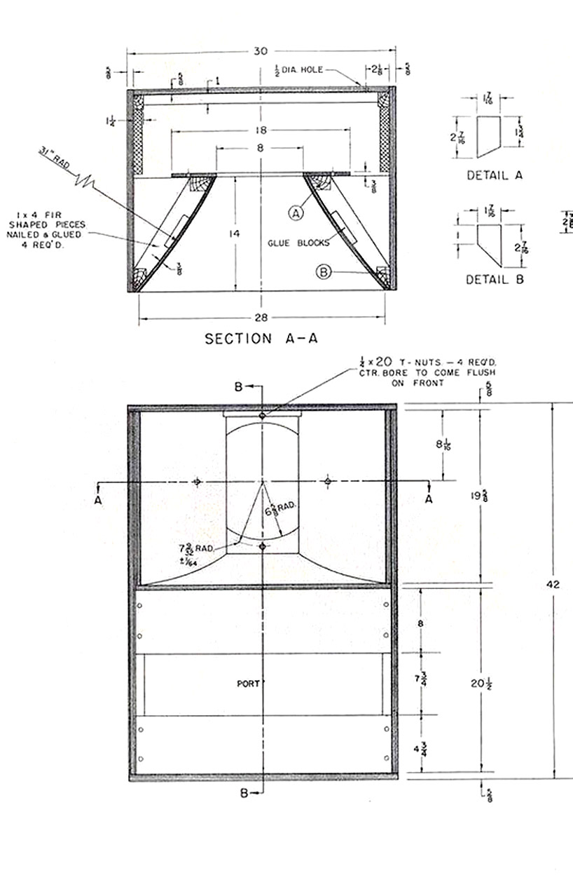

A quick question for "jzagaja": Is the "J-Horn" on your webpage <J-HORN - Horns by Auto-Tech> similar to the short horn in an Altec A7 or A5? The dimensions look roughly similar.
