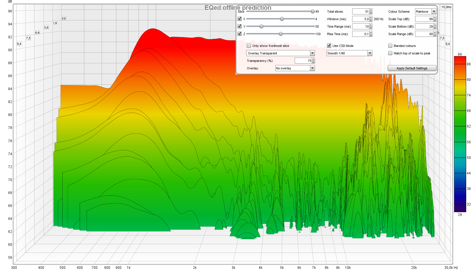

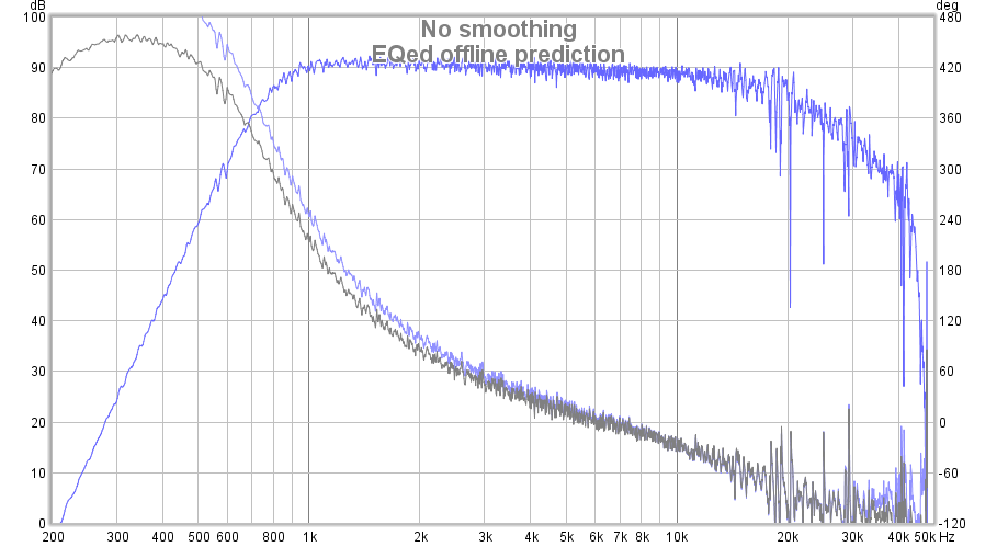

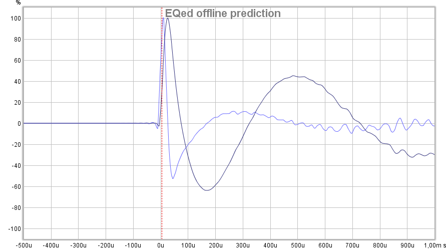

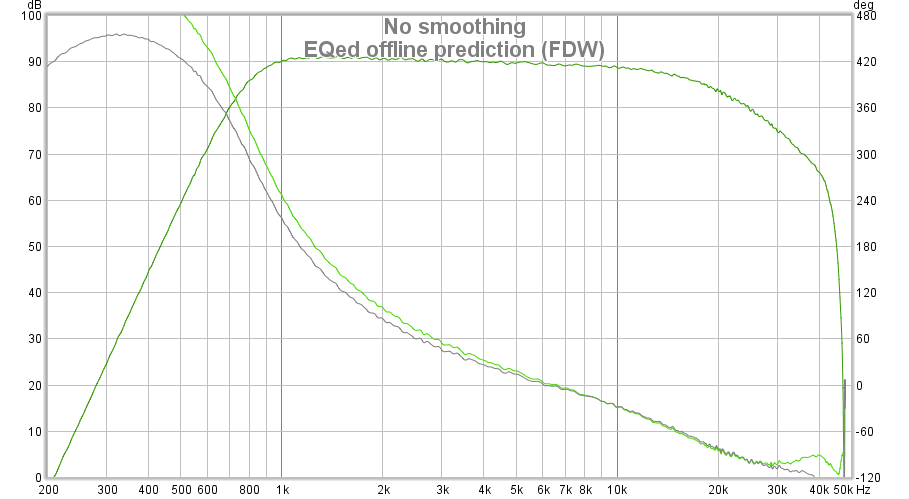

After some speculation and above looks maybe too good to be true for acoustic domain especially if they comp filter reflections sits there, therefor find first below where we can see raw FDW filtered response that was used above times reverse correction curve, second is same raw but non FDW filtered and the next three are result when this one is times reverse correction curve, and overall think correction result is still pretty good.

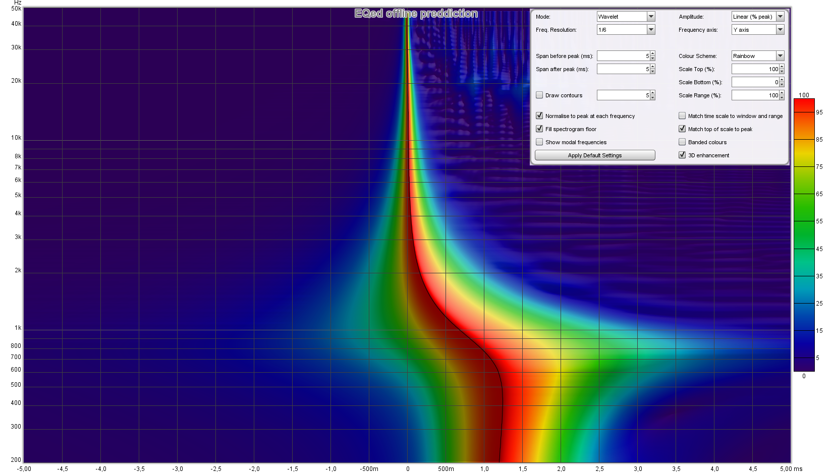

It looks being in yours too just harder to see because of crude time scale, below should help with a zero time line edited white then follow performance of black dotted peak energy time which very weird show frq 4kHz and up will happen before real time, the one at right better follow book for minimum phase domain.
It looks like the actual start of the IR is the peak before the one that hits 100%. REW aligns the highest peak and takes that as t=0.
