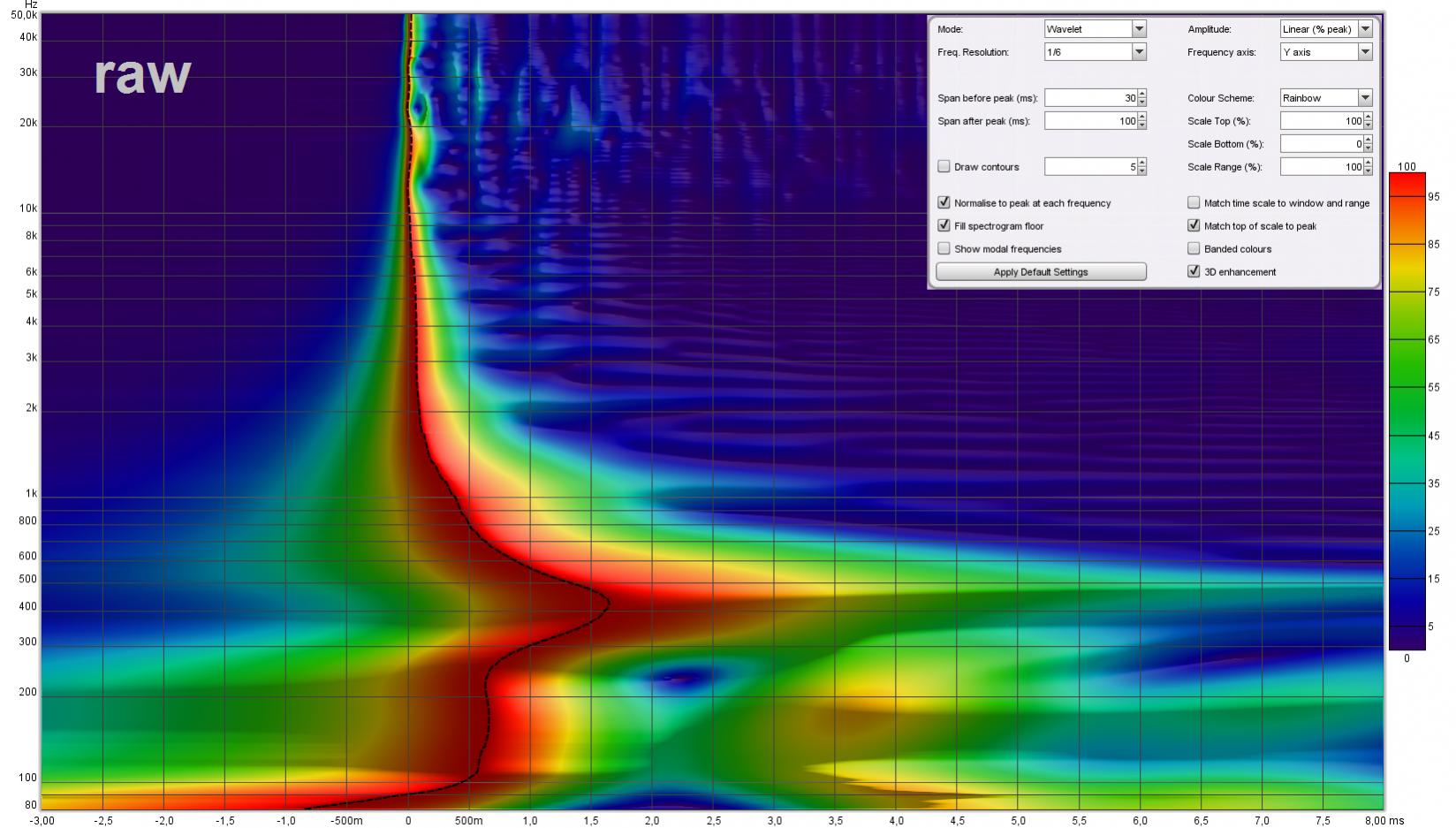

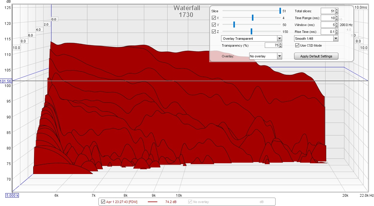

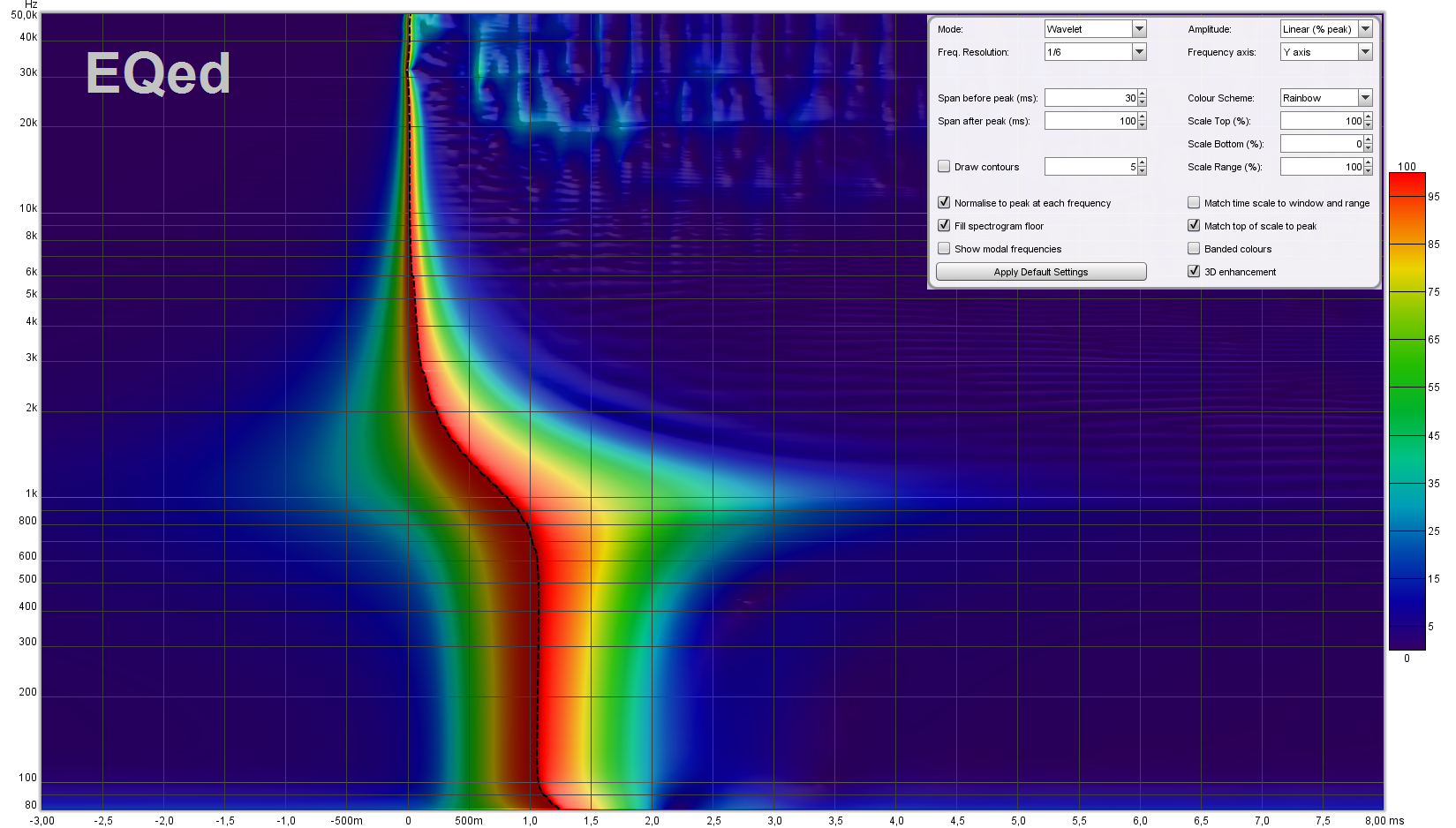

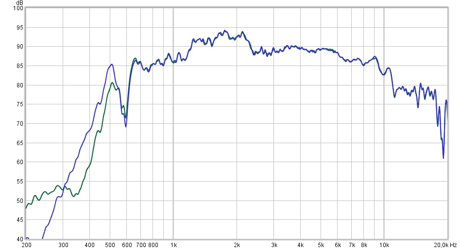

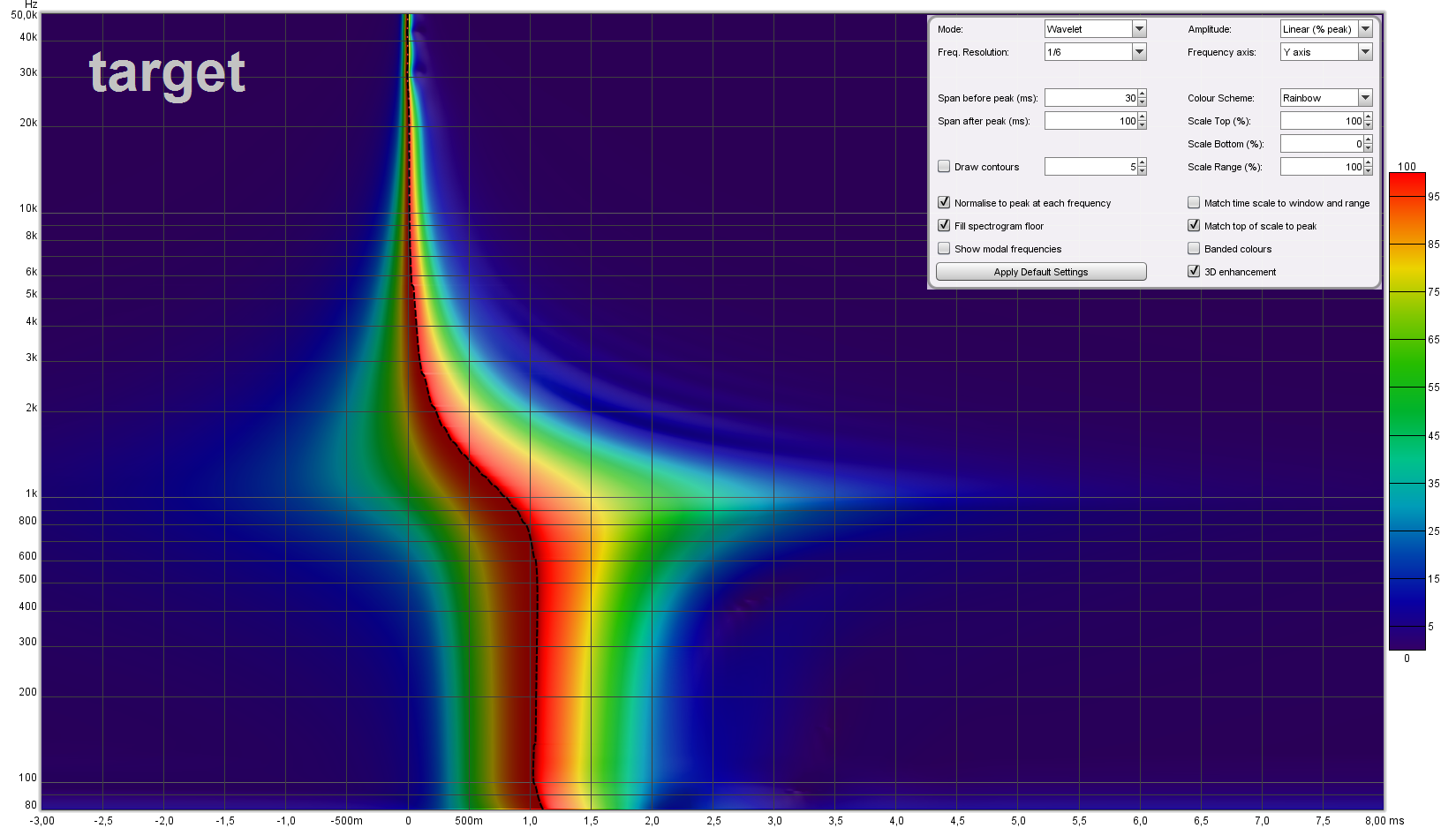

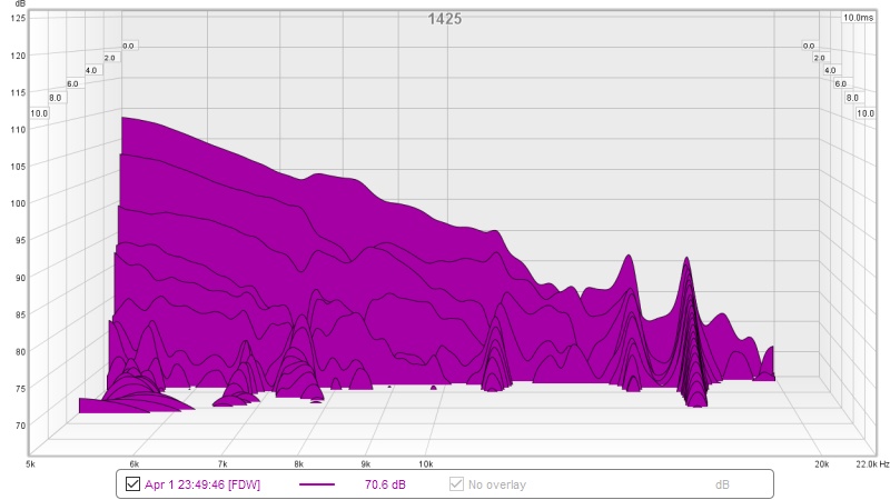

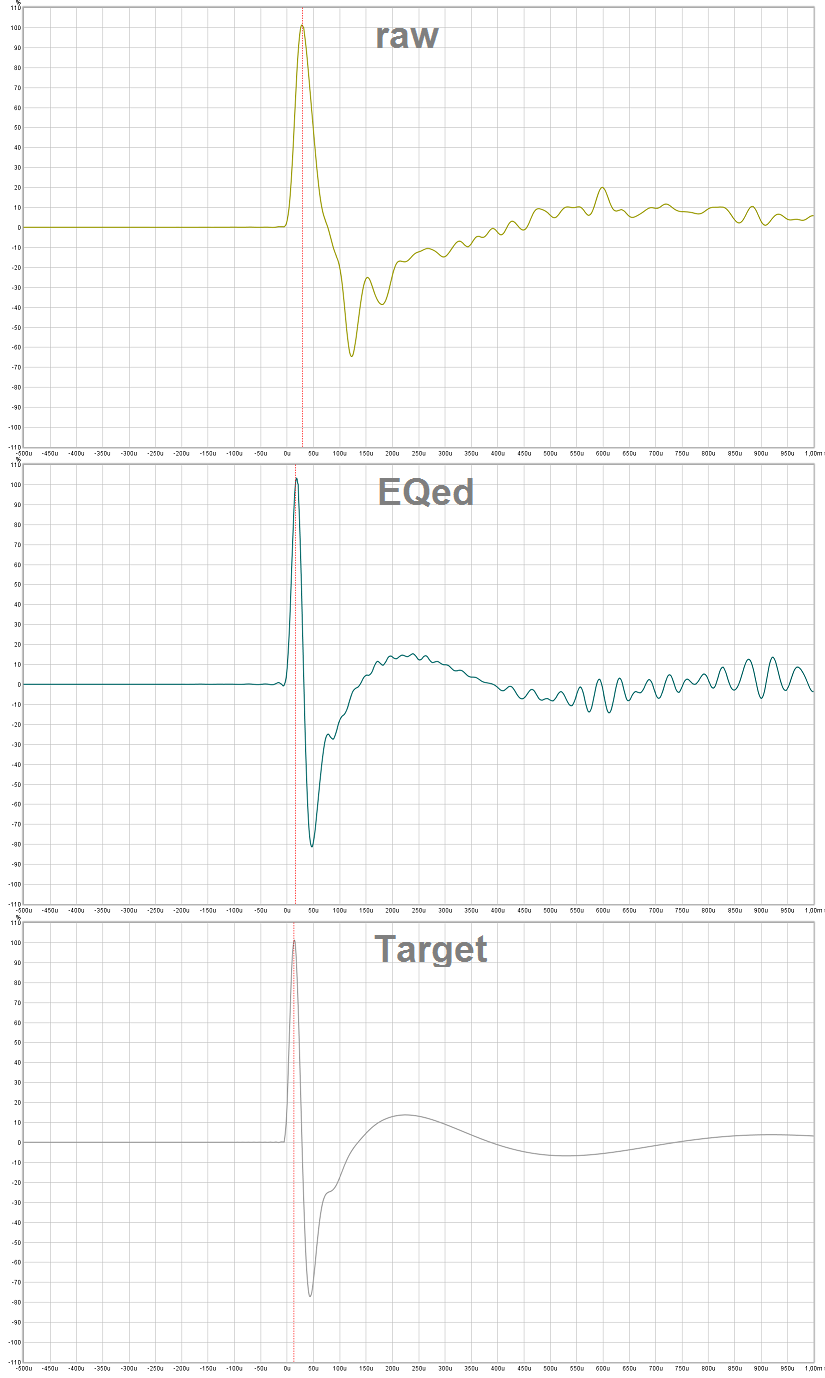

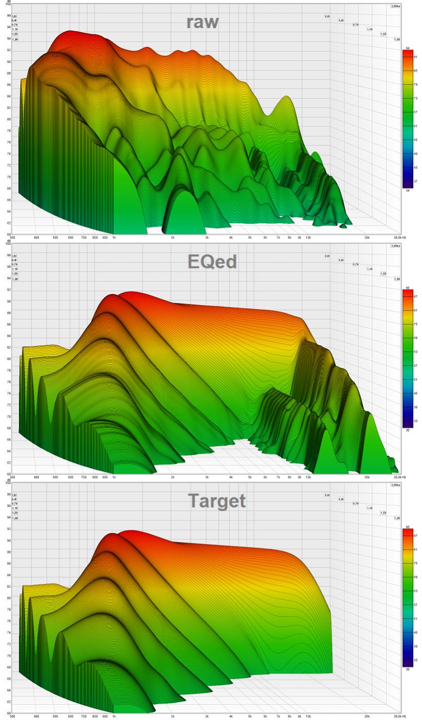

Exercised EQ AL diagraph to a known target passband 8th order LR at 1kHz - 21kHz BW2, comp filtering or reflection in conflict with close microphone or whatever it is is hard to EQ right 😛 and probably some reason for waterfall HF ringing, all graphs below include raw/EQed/synthetic target, failed to get APL_TDA graphs from a loop where EQed wav-file was loaded in convolution engine probably because APL_TDA run 96kHz and convolution file was at double.

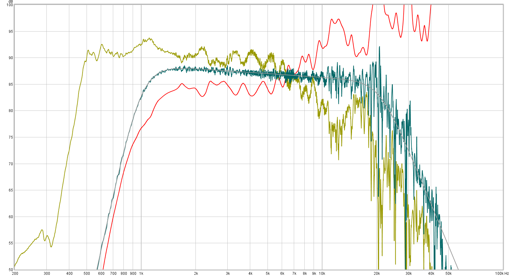

I have done another measurement with a different horn which is similar to Beyma TD385. In this case the microphone is 35cm away from the mouth. Some damping material was on the floor. And the measurement was done with 96kHz 🙄
This horn needs considerable EQ also in the 1k-2k5 region which might be related to the strange looking mouth area. This horn does not show such a deep hole around 12k. Also attached is an impuls export. I have done the measurement with more power (louder) than before. The impedance curve in this horn was already shown earlier.

... last but not least a comparison with closing this small ventilation hole in the back chamber. Doing this should be no problem for small power driving as this hole is intended to increase the life time of the diaphragm. Gives more low frequency amplitude. If a horn loads better to LF than this horn shown here the crossover design may give some different options.
Blue line is vent hole closed.

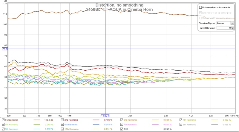

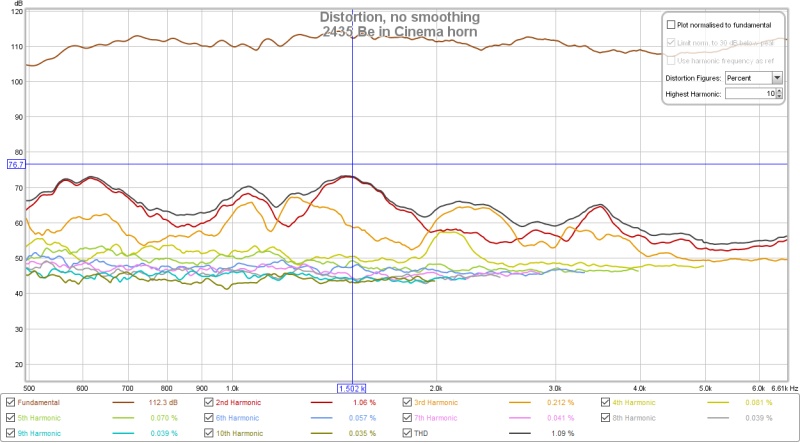

compare be driver to titanium aquaplas distortion

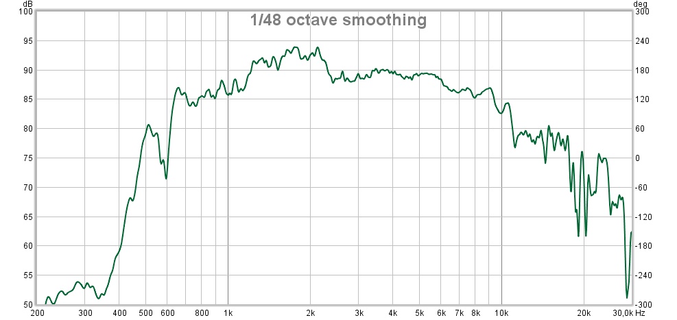

The be drivers I have tend to be noisy. Here is two drivers in the same horn one beryllium JBL 2435 and other aquaplased titanium JBL 2450SL - the TAD with hard surround is a bit worse (2" so different horn) - they sure sound different 😀
There is quite a change in distortion in those plots, you can't see distortion from imported impulses in REW so that would need to be compared in graphs from those who took the measurements.

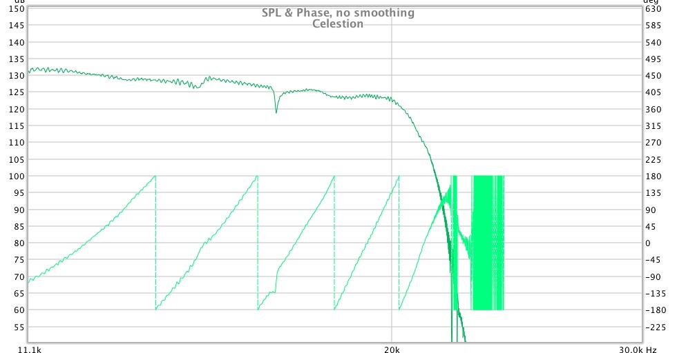

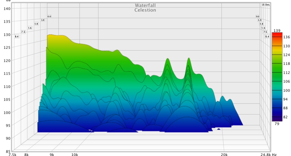

Here are some comparison shots of POOH's impulse with the same settings or as close as I could get to the ones I posted before.
The phase is not clean in the celestion measurement like it was in the other so it harder to compare that aspect the Celestion is also a 1" driver and may not be able to be crossed as low as the 745
SPL Phase - Phase is wrapped to make it visible

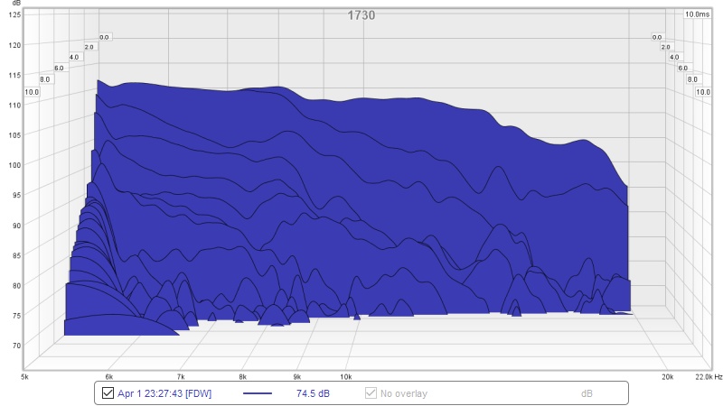

Waterfall
attachment.php

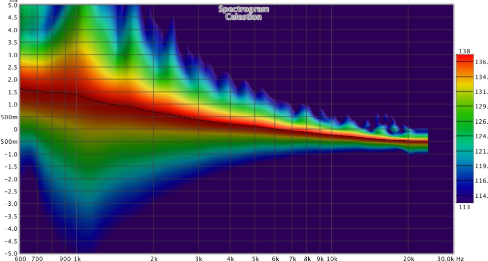

Spectrogram 5ms
attachment.php
